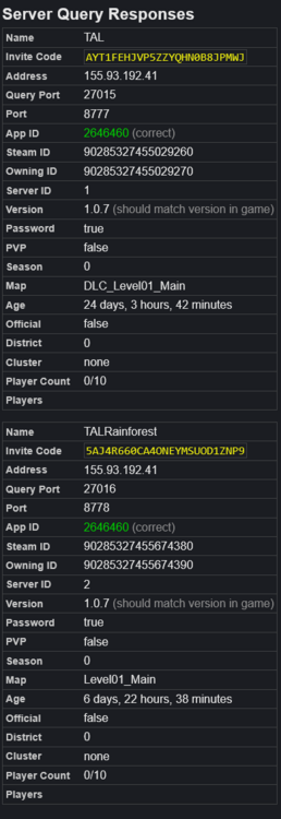

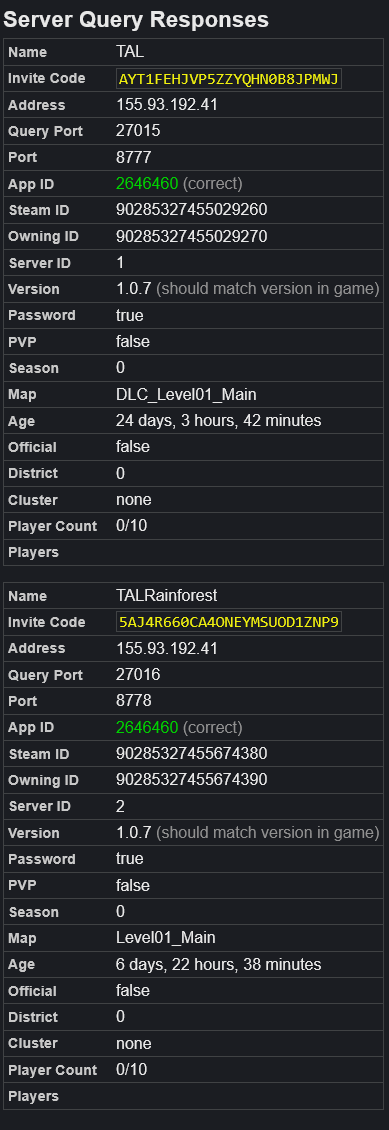

  1. Any chance this can be updated?
  2. Has anyone else had any luck getting a cluster to work with this? I have tried everything now and its still refusing. Even though they work like a cluster (you cannot log into both you have to log in the one that is considered your last master server) it does not show anything in the transfer server list, also as you can see the server browser here shows it is not in a cluster even though I have all the settings already setup for this.

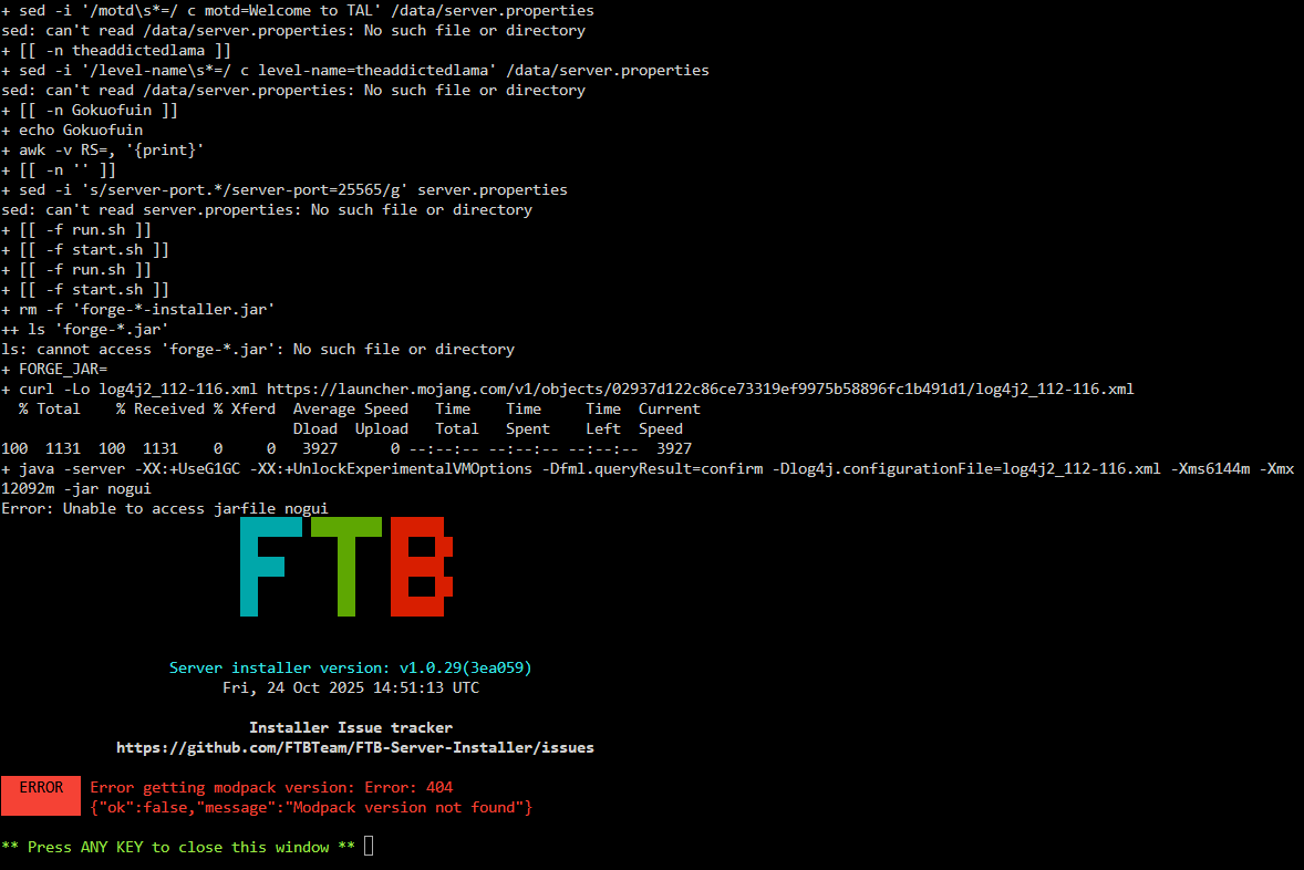

  5. @Goobaroo any idea on how to get past this error? I am using FTB Evolution and (I am ashamed to admit) I destroyed my world because I copied it to my PC to update it manually and then deleted the one from my unraid without FIRST checking I had copied everything, so ye, props to my brain. Anyhow I am trying to start from scratch, so I removed all the files in appdata and removed the docker and image, now I am trying to install it again but I keep running into this error, no matter what I try I cannot get past it.
