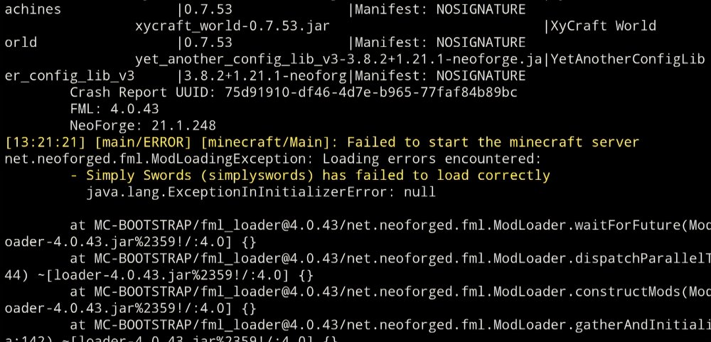

  • @MVLP Yep, just force an update to pull the new latest.  I fixed the 1.5.0 release, it was skipping the install.  Should be all good now.   @djmulder Direwolf20 1.19 should be available as s
  • @Killersplace Does it start up?   That error shouldn't prevent startup, it is just a mod error that is then taking a default value.  So it should be fine.     @Carltonrp Sure, should

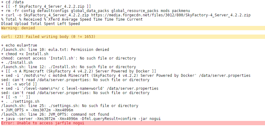

 im having trouble finding the servers files for sf1 and sf4 i want to adjust the server.properties file so i can let in modded players that dont have verified usernames this is the particular command or line i want (online-mode=false)
Edited by GH0ST2117
They both have directories in /mnt/appdata where you should be able to find the server.properties
in my case they are there but empty i found the files are in the tmp files i did notice when installing i had issues with
any help would be appreciated i am an new user to unraid
Ran into the same issue, fixed it by changing the skyfactory4 folder's permissions to 777.
Edited by Bob_Flem
Thanks @Bob_Flem, I was going to say the same.  Looks like the new appdata/skyfactory4 directory doesn't innately have write permissions.  I'll check if there is something I can add to fix that when creating the container's working directory
i fixed it by using the permissions tool i didnt know i had lol thank you guys sorry for the bother and thanks for a great docker man its fantastic
