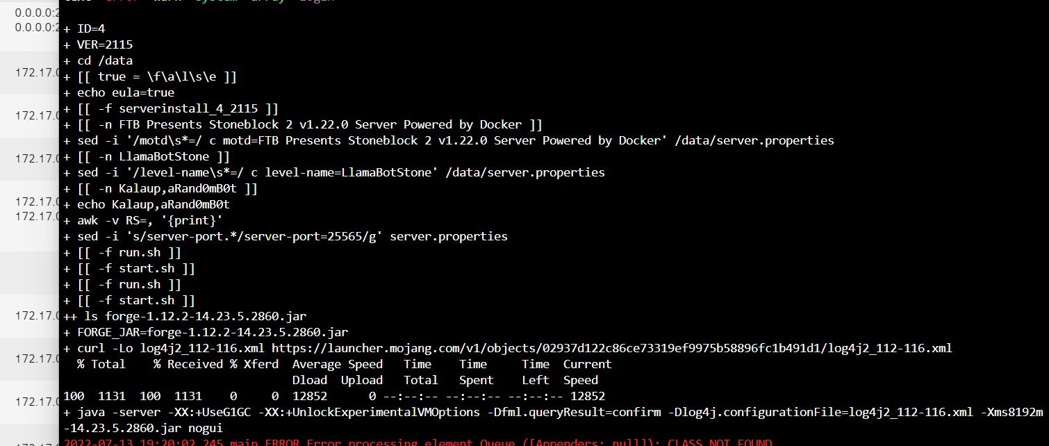

It seems like 6GB wasn't enough. I have 128 (running a dual xeon server with CPUs clocked a 2.3GHz and 128GB of DDR4 ECC ram). I changed the default memory settings for the docker to 8GB minimum and maximum, and it fixed the issue with the running behind error.
Now running into a new error however. Now every time the server starts it is modifying my server.properties file and changing the Port I have allocated (I'm running 4 different minecraft dockers, so I allocated a non-standard port for this in the docker settings, and the server.properties file).  Where is the script that is changing the server port and changing the server. properties file? I've been poking around and can't find it. Also since I deleted the start.sh file, uninstalled the docker, and reinstalled it, the start.sh file is still gone, and this is happening. Sorry for all the issues!
+ sed -i 's/server-port.*/server-port=25565/g' server.properties
@DarthLlama You should be setting the PORT in the config for the application under Unraid.  The port that the server runs on inside the container is static at 25565.

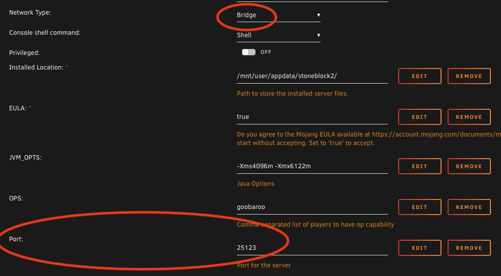

@DarthLlama change the network from host to bridge and the port setting will apply.  Or use the br0 network and assign your Minecraft server another IP entirely.

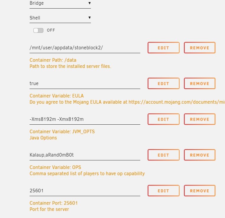

For the Port issue on Stoneblock 2, I tested changing it to 25565 in the docker, and then connecting using that port, and it works.  I tried changing it back to my custom port, and it failed to connect again.  I wanted to see if any other Minecraft Dockers you made were doing this, and so I tested Oceanblock. I set it up on a custom port and it keeps the port (doesn't change it back to the default 25565).

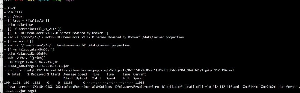

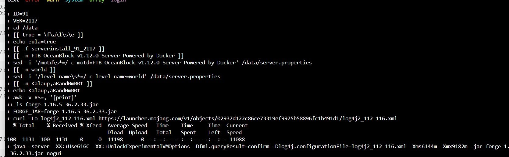

I attached screenshots of the beginning of the logs that shows that oceanblock isn't changing/reassigning the port, and one showing where Stoneblock 2 is.  I have poked around in the files for a couple of hours and can't find what would be causing it to happen.

The solution is to change the network to bridge instead of host and set the Port value in the config.  Bridge network is the default for  docker.  I had inadvertently changed the default networking to host when it should have been bridge in the unraid template for the containers.
When the network is set to host it will use the IP of the Unraid server and try to attach the port and that is where you get collisions and can be blocked.
When the network is set to bridge, docker will port forward from the internal docker network from 25565 inside the docker container to the Port defined in the config also to the IP of the Unraid server.  This is the correct method for running a docker instance on another port.

I totally understand. Whenever I uninstalled and reinstalled the docker after the update, I made sure to set it to Bridge and assigned my custom port.  But for some reason, it is still changing the port (not in the docker settings, but when booting up in the logs) to the default. I have tested this by trying to connect to it from the client on my configured port (which fails) and then trying the default port (which works).
At this point I'm convinced something weird is going on with just my install, so I'm just going to run it on the default port, since it works there. I'm mainly documenting in case someone else runs into to it too, so maybe a solution can be found.  Again, it worked perfectly, until the last update. AND works perfectly, if I use the default port on the client. No biggie, just an FYI.
