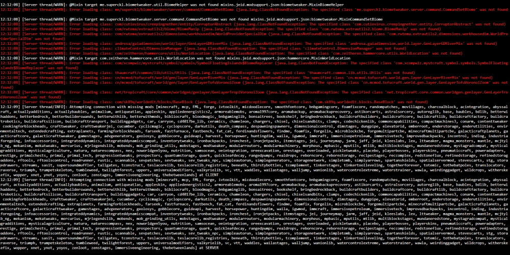

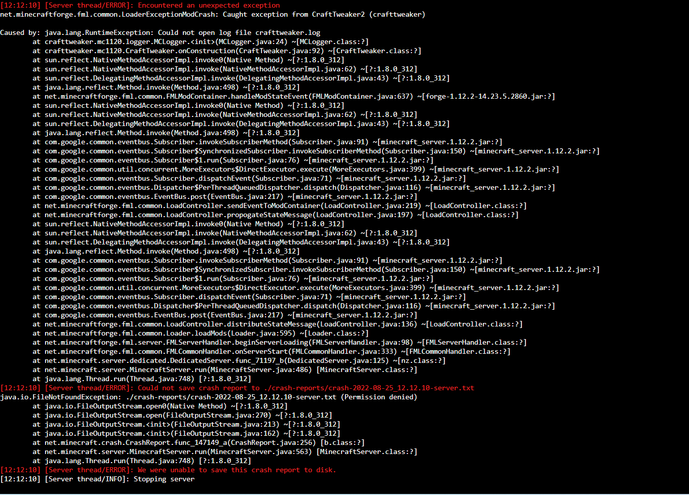

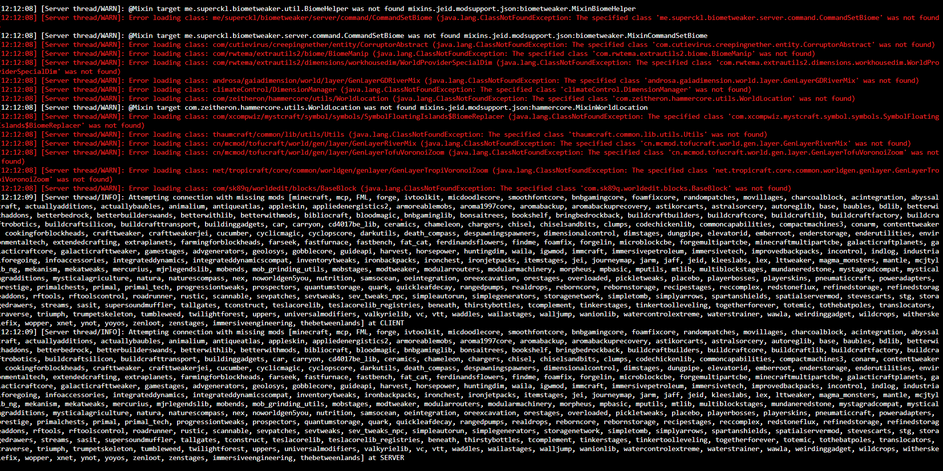

  • @Killersplace Does it start up?   That error shouldn't prevent startup, it is just a mod error that is then taking a default value.  So it should be fine.     @Carltonrp Sure, should

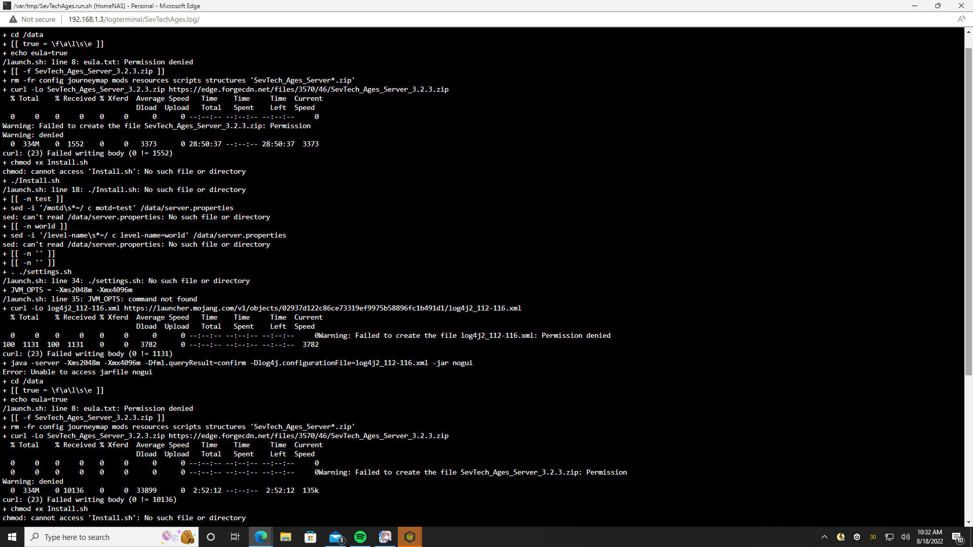

Theres an issue with SevTech. Using the Apps installer and it fails to load. Seems this and ATM7 don't start. SkyFactory 4 starts though.
I can see a permission denied when trying to download and save the installer.  Make sure the /mnt/user/appdata/sevtechages is writable to all.
It is, for some reason this only occurs with SevTech and ATM installs, SkyFactory 4 installs fine. I've tried another SEvtech Repo and it worked only problem is that is was a very old server
I just pushed and updated version of SevTech.  It has a change for the user in the container that runs the service.  It should now match the nobody user.  Seems that container got missed.
See if choosing advanced in your docker and forcing an update solves it.
Yep it does, started right away
Is ATM7 throwing errors, because I can confirm that it has the user gid/uid fix that I just put in SevTech.
ATM7 seems fine now. Thanks a bunch

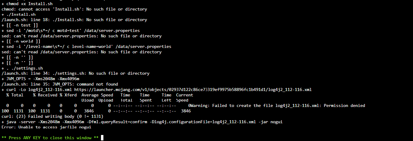

Hello, So we updated our Sevtech Ages Docker,  and now we are currently unable to get it going. I attached what logs pulled up. If could please get some help fixing this issue that would be great thank you.
Edited by ToyRoBoHoBo
wanted to add pictures and re word my post

@ToyRoBoHoBo & @elokaynu
Both look like local permission issues.
The correct ownership for the directory under /mnt/user/appdata should be nobody:users
So for SevtechAges it is
chown -R nobody:users /mnt/user/appdata/sevtechages
SkyfactoryOne
chown -R nobody:users /mnt/user/appdata/skyfactoryone
