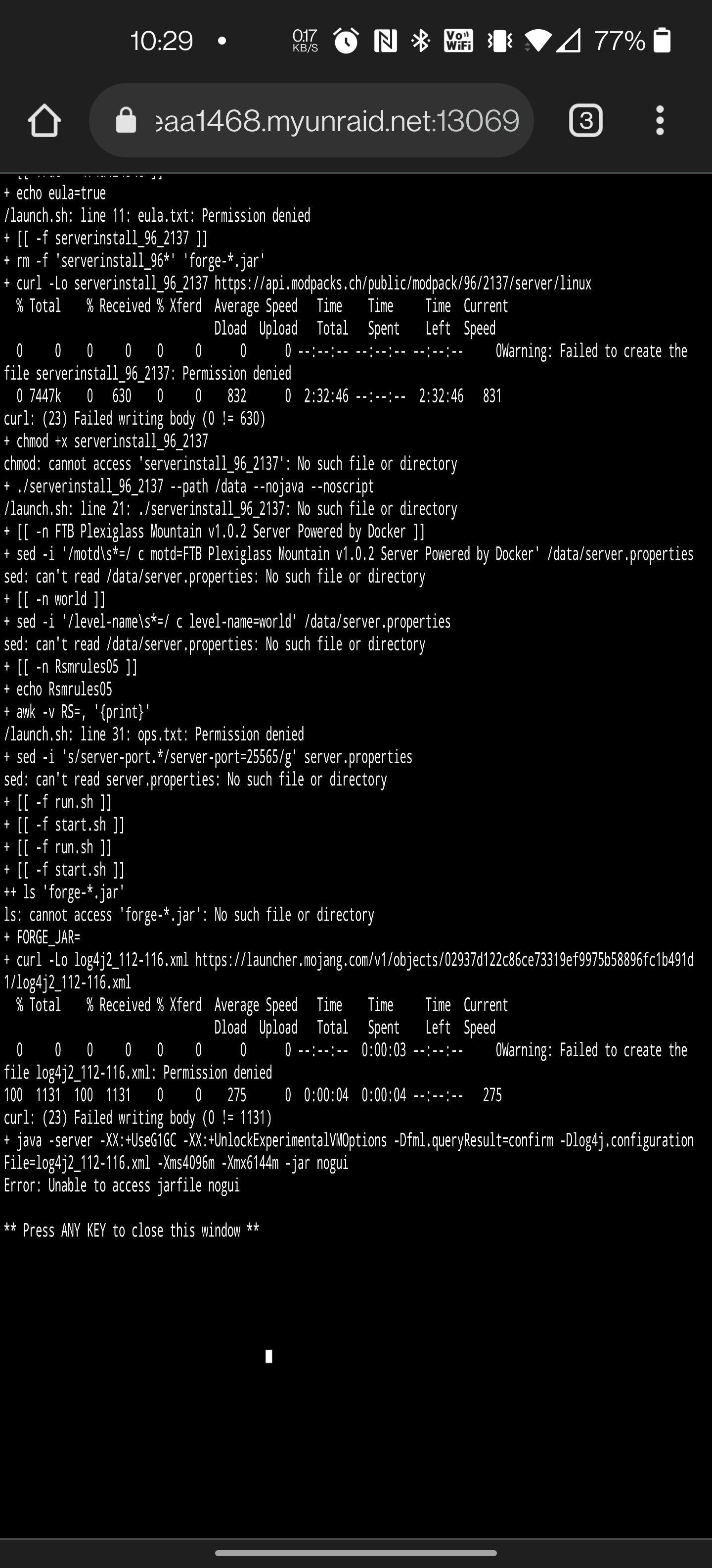

@Goobaroo
The plexiglass one seems to be having permission issues, even after giving the folder 755 permissions.
V/R
Siggz
Can you provide some logs, I'll see if I can help out.   I found it took a while to start up for me and to get fully running.
Sorry about that, I've attached a screenshot from my phone of the logs. Don't currently have access to anything else to grab the logs at the moment.
Yep, it's the permissions on the directory that is mapped to /data inside the container.
You can try giving `/mnt/user/appdata/plexiglassmountain` 777 and it should be able to install.
I'm not sure why some users have permission issues and others don't.  I'm going to look into that.
