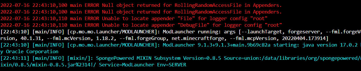

Hey everyone, I update my server and now everytime I try to start it says this:
Any solution? How can I go back in versions whitout lossing all (maps, etc)?
@MVLP In a console, change the ownership of the files in /mnt/user/appdata/ftbdirewolf20_118.
chown -R nobody:users /mnt/user/appdata/ftbdirewolf20_118
@Z-Server I don't know which container you're running but try fixing the ownership like above, but the directory that is configured for which ever container you're running.

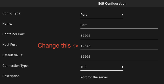

Brand new to unraid. I was successful at setting up the binhex minecraft container and my kids are enjoying playing in their own world. Now they would like the mod packs so I installed ATM7, but I don't know how to "connect" that to the minecraft container -- if that's even how it's stated. I do know that I can't have both of them running on the same port so is it a matter of copying the jar files from the ATM7 into the binhex minecraft installation or does it require something else like parameters or modifying the server.properties file? I'm new to unraid, linux, dockers, etc. but I'm a software developer so I can follow bread crumbs -- I just have yet to find anything definitive on youtube or on this forum/community that addresses this so I'm just guessing it's basic knowledge if you're into this stuff everyday.
Sorry if it sounds like I have no clue, but I'm just trying to get to the next milestone of success so I can keep expanding on my knowledge of Unraid, dockers, vms, etc. Any help is very much appreciated!
@hoss Docker containers are fully contained with everything they need to run the application that they are meant to run. I don't know what support the binhex Minecraft container has, but you don't need it to install my ATM7 container.
Once ATM7 is installed on your unraid server, you have two options.
  1. By default the ATM7 should be configured to run in bridge network mode and you can set a different port number using the PORT  config item in the ATM7 container settings.  Do not change the port in the server.properties.  The Host port will be used by clients for connecting to the server.
    You can see in the screenshot that docker is forwarding the network traffic from the bridge docker network to the unraid server IP and the configured port.
  2. You can change the networking in the ATM7 container to use your br0 network.  This should allow the container to acquire it's own IP address from your local network and you can connect on that.  You can even set a static IP as part of the container configuration.
That was exactly what I needed and made complete sense. I went with option 1.
It took a very long time to load all 300+ mod packs, but I think most of them went in without errors. I don't think it's necessary to chase down all the errors / warnings in the log. Do I need to restart one or both of the containers for the changes to take effect? Is there an order that they should be started? I'd think it would be the ATM7 started first then wait until the log is finished with loading all the mods then start the minecraft container.....but I don't know.
And last question for now (sorry)....how can I tell if the mods are loaded while playing the game?
And how do I buy you a beer or coffee?
Order doesn't matter because those are now two completely independent Minecraft server instances.  One is the base vanilla Minecraft and the other is ATM7.
Good little overview of a docker container here: https://www.docker.com/resources/what-container/
That 12345 port number can be pretty much anything you want in the range of 1024-65535.
Modded Minecraft servers are pretty resource heavy.  So depending on how powerful your Unraid server is, it will determine how many different instances you can run simultaneously.
OMG I can't believe I didn't realize the ATM7 was an actual minecraft server instance.....it makes sense now because we didn't see any changes to the inventory or how the world looks.....nothing really. I just thought maybe those mods had to be unlocked somehow and that was going to be another quest.....I'm glad you cleared that up! I'll have my kids give port 12345 a run and see how that goes.
Again, really appreciate the help and all the work you put into this for the community. I'm finding that a lot of people on here really know their stuff and hope I can someday contribute.

Hi Goobaroo,
I just updated the ATM 7 pack to the most recent docker version. Prior to this, everything was working and running great. When I updated, the docker fails to start and in the logs provides the error of "Error: could not open `libraries/net/minecraftforge/forge/1.18.2-40.1.68/unix_args.txt' When I went into the file location, I couldn't find this directory at all. Any suggestions?
Are you looking in the container, or are you looking in Unraid? You can get a console inside the container by clicking its icon and selecting >_ Console
Since it can't start in the docker, I can only open the log within Unraid itself. That's where I pulled that error code from.
Edited by Deblobman
Is this the docker.log?
Yes, It's the log I pulled from the docker in Unraid.
