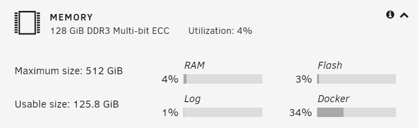

  7. Running on an old HP Z820, way overkill for a home media server with a few docker containers and VM's but hey ho, we do like to play don't we. ☺️
  8. Thanks for this, I had an old HP Proliant ML310e G8 with a Quadro K2000 card which wasn't seen by Unraid when I upgraded to the latest Nvidia Driver. I even installed a Quadro K620 to see if that made any difference but I've since found that the ML310 doesn't support the K620 so I had to downgrade the driver back to the last stable Legacy and re-install the K2000. It's only used to do some transcoding for Plex/Jellyfin so no real loss but thanks for confirming.
  9. Way overkill I know but it's what the system came with...

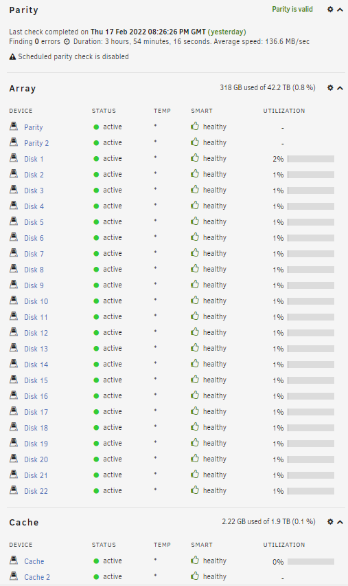

  10. I've been pondering this and decided that I don't really need to run two machines, there's no real benefit for me at the moment, especially considering the giant leap in performance from my current machine to the new one. I already have a working backup solution to Google Drive using Duplicati (thanks SpaceinvaderOne) so I'm only really looking to port my current subscription which I would upgrade to Pro, to a totally new machine without transferring any hardware, is that possible?
  11. Excuse the noob question but I've been lucky enough to get my hands on an old server which only has SSD's, 26 x 2Tb in total. I'm in the process of building it and through a combination of ignorance and inexperience I've configured it as follows, From what I've understood am I right in thinking it would better if I used conventional disk(s) for parity and just had a huge cache? Unfortunately, the chassis only supports 2.5" drives with nothing available internally to jury rig (it's an HP DL380 G9) so I'll need to swap out some of the existing. I'm hoping to use this machine instead of my current old PC and would look to migrate everything across (or backup/restore, still learning that bit). The worry I have is that I've seen lots of comments about not supporting SSD's in an array or advice against it but also posts from people who've been doing it for years without issue. Not that I'm running any mission critical apps or whatever, just the usual Plex and downloaders etc. the important data is all in the cloud. Am I wasting my time or is it worth pursuing? TIA
