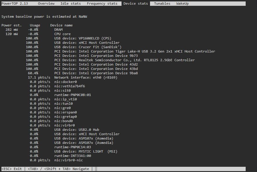

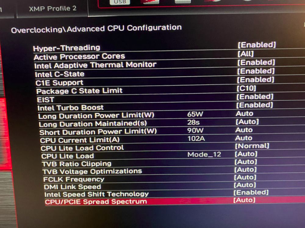

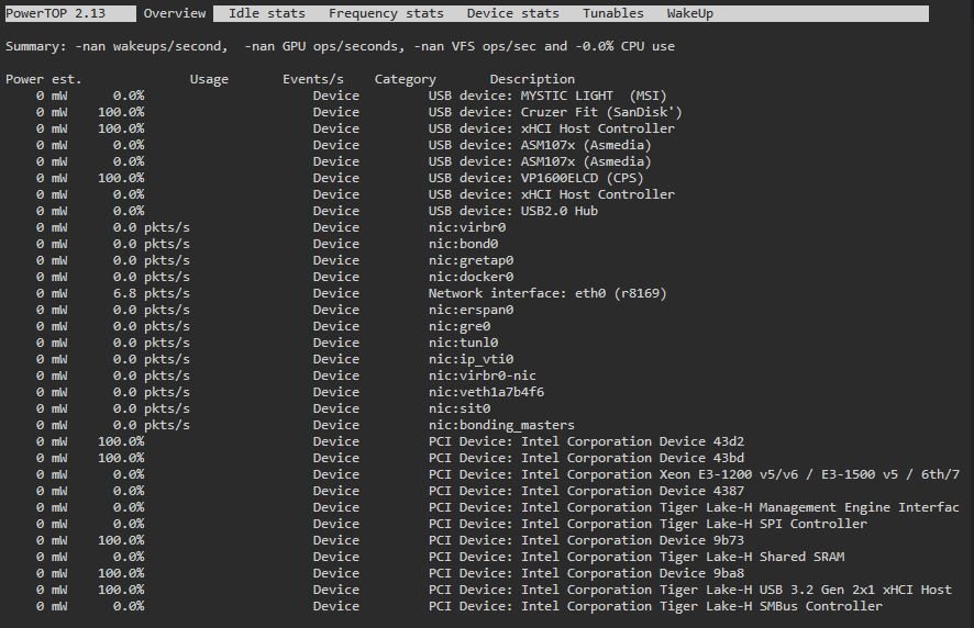

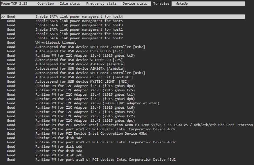

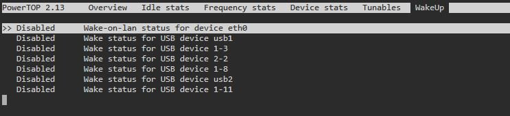

  17. I have enabled everything I can see in the BIOS. I have similar options to a post above, and have all the same settings. See image below. Yes, I followed your guide and executed powertop --auto-tune.- I haven't run any other commands. See some other screenshots from powertop attached. Please let me know what other info you need Will I see much more of a power saving going higher than C3? Thanks!
