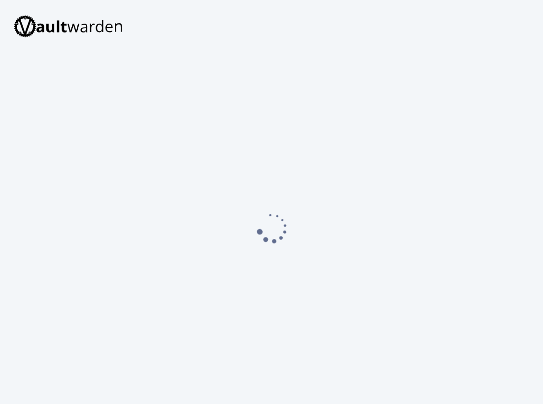

  1. it looks like im facing a similar problem like Caennanu when i try to access Vaultwarden localy i get a infinite loading screen and nothing else. when i connect via proxy manager i get the same loading screen aswell. any idea what i could do to fix this issue? i already restarted the docker several times. in the logs i cant see anything strange. Any help or hint would be appriciated.

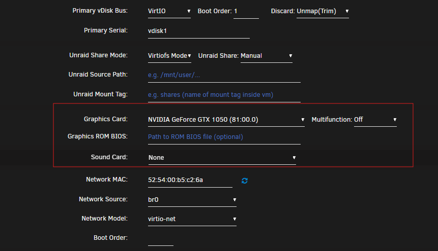

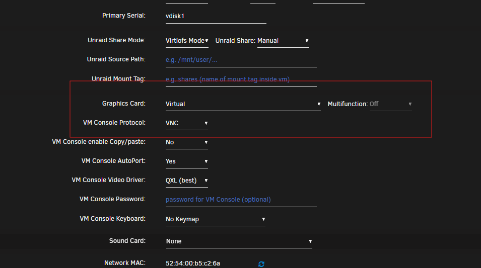

  2. Sorry for the long delay. What do you mean with "just use its output"? î have no phisical access to the server etc. what i could probably do is to create it with no video card, access it with VNC, then install rdp, switch to setup with graphic card, and then use RDP to connect. would this be working?
  3. Thanks for your tips. Its strange, because when i created a new Linux based system i can see bot, VNC and also RDP, when i deleted the Windows 10 VM and created a new one from scratch, i still only see RDP?! As soon as i choose my Graphics Card in the configuration, the VNC option disapears. When i leave Graphics Card on Virtual, then i see the VNC option, otherwise not.

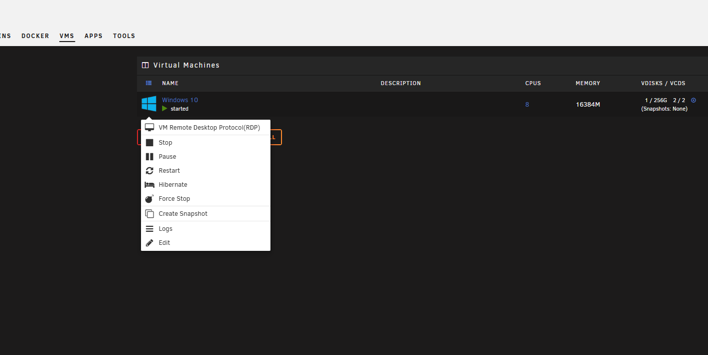

  4. For me it looks like this if i try to connect to the VM: Then i get this error message:

  8. Hey guys i tried to install my first VM on unraid. it looks like the VM was started sucessfully, but when i try to connect to the Machine i get the following error: i searched the forum but didnt found the solution that i was looking for so far. could someone give me a hint what i'm missing? Thanks a lot for your help and patience.
