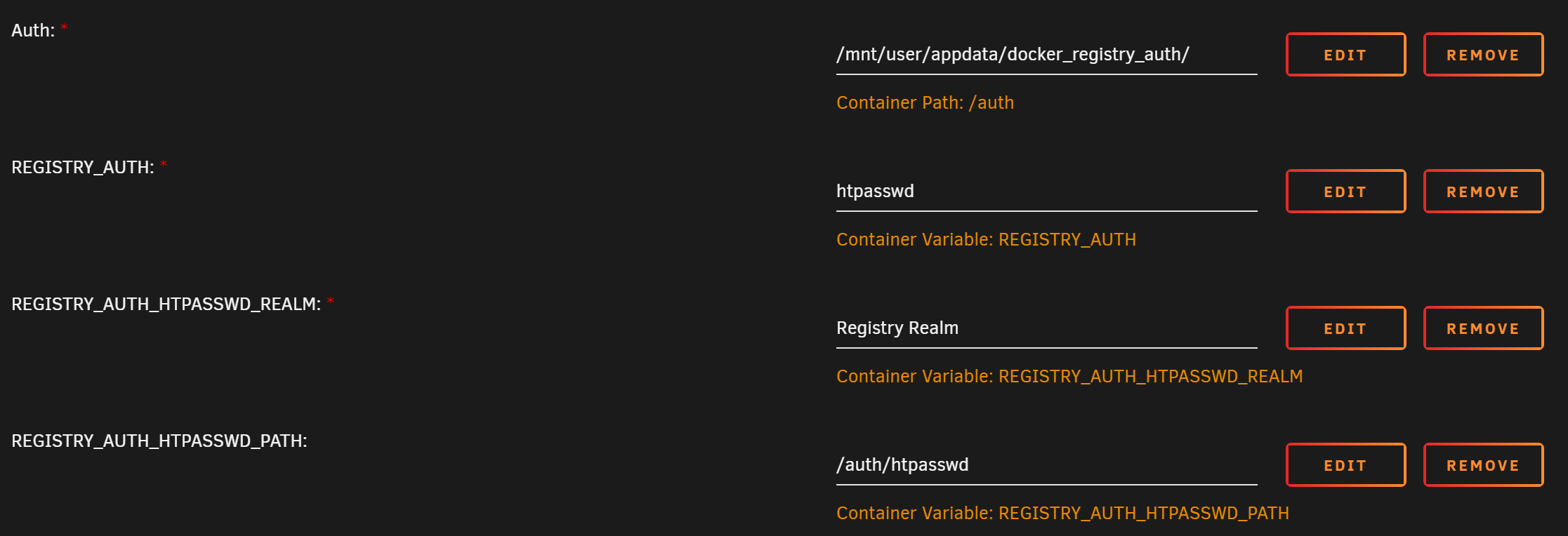

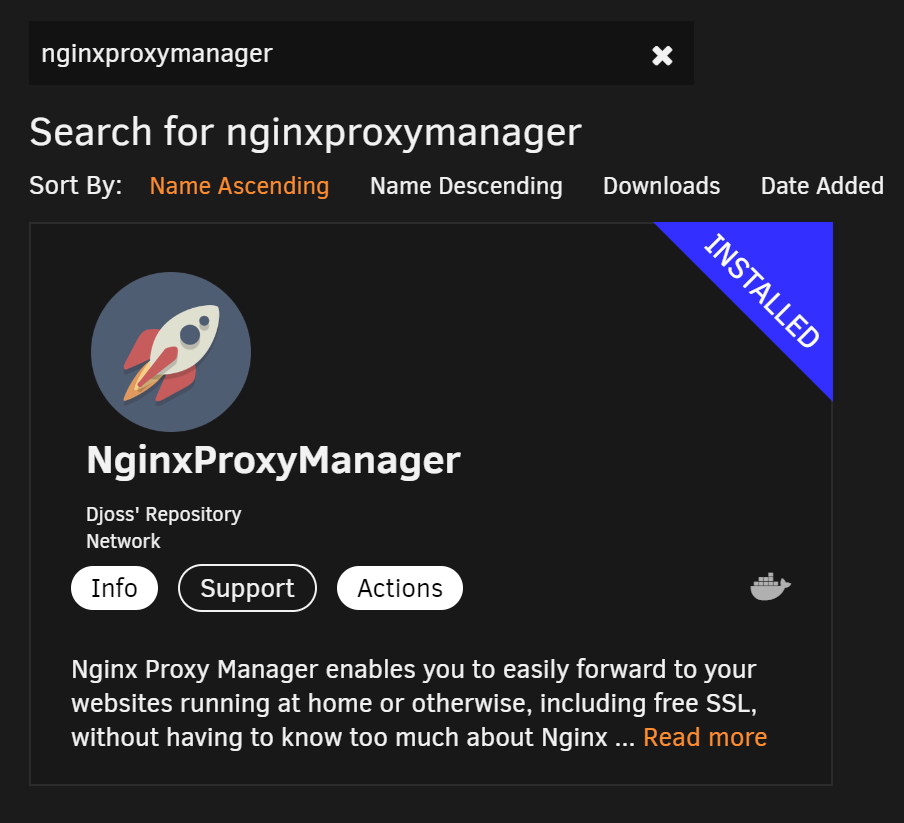

  4. If you are still intrested I can share my approach: First I am using the Nginx Proxy Manager as entrypoint for ALL my services at my unraid server Therefor I have created there a entry which points my subdomain (mysub.mydomain.net) to the internal docker registry (f. e. 192.168.0.10:5000) After that I have created a directory for the htpasswd file on my unraid server: mkdir /mnt/user/appdata/docker_registry_auth Then I used this docker temporary container to create the htpasswd file: docker run \ --entrypoint htpasswd \ httpd:2 -Bbn USERNAME PASSWORD > /mnt/user/appdata/docker_registry_auth Of course replace USERNAME and PASSWORD by your choice. After that I have modified the docker template of DockerRegistry container and added the path to the htpasswd file and the needed Env's: Thats all, since the Nginx Proxy Manager will manage the certificate you don't have to do that in the docker registry itself
