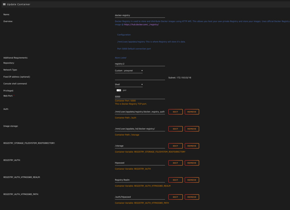

May 20, 20242 yr I can't get authentication to work on this container, and can't find where I'm going wrong. I have the container set up like this: and this Swag config: server { listen *:80; server_name myserver.example.net; server_tokens off; return 301 https://$http_host:$request_uri; client_max_body_size 0; access_log /config/log/nginx/docker_registry_access.log; error_log /config/log/nginx/docker_registry_error.log; } server { listen *:443 ssl; server_name myserver.example.net; server_tokens off; include /config/nginx/ssl.conf; client_max_body_size 0; chunked_transfer_encoding on; access_log /config/log/nginx/docker_registry_access.log; error_log /config/log/nginx/docker_registry_error.log; location / { include /config/nginx/proxy.conf; set $upstream_app docker-registry; set $upstream_port 5000; set $upstream_proto http; proxy_pass $upstream_proto://$upstream_app:$upstream_port; } location /v2/ { include /config/nginx/proxy.conf; add_header 'Docker-Distribution-Api-Version' 'registry/2.0' always; set $upstream_app docker-registry; set $upstream_port 5000; set $upstream_proto http; proxy_pass $upstream_proto://$upstream_app:$upstream_port; } } I've created the password file with htpasswd -c /mnt/user/appdata/docker-registry/docker_registry_auth/htpasswd username and if I replace "-c" with "-v" and re-enter the password it says it's correct. But If I run "docker login myserver.example.net" I get Error response from daemon: login attempt to https://myserver/v2/ failed with status: 401 Unauthorized Can anybody spot where this is going wrong?
May 21, 20242 yr Never mind — I found the problem. Running the htpasswd command directly on macOS produces a password file that's rather different from running that "docker run" command above. Different encryption, perhaps? And the registry container seems particularly fussy about which encryption versions it will use.
