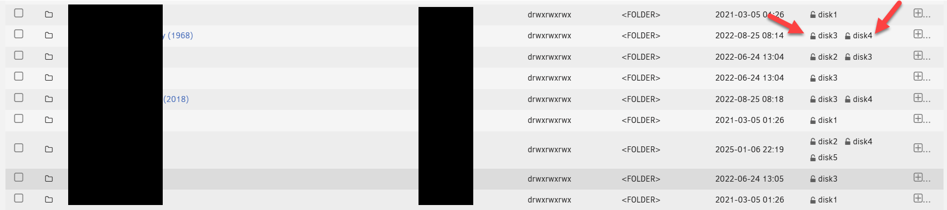

Does this mean a file is duplicated on multiple disks? Multiple disks listed in Location column when Browsing files - Duplicate files - File has multiple disks showing
Thank you. If there is an actual file in each folder, then how does this affect things?
And is this how you delete the duplicates? And is there an automated way to find and delete duplicates? Thank you!
