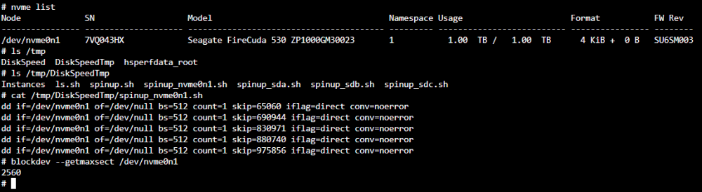

Sorry but the spinup_* file(s) are still wrong... bs=512 instead of bs=4096 I double checked it's 2.9.7 and also removed the container completely and pulled fresh. Also tried to delete everything under /tmp/ and restarting the container. It's always generated with bs=512 I checked the Spinup.cfm and I think the problem could be that you loop i from 1 to 9 so you miss the first nvme which is enumerated as nvme0n1 Edit: I can confirm if you use <CFSET DeviceID="nvme#i-1#n1"> it works. The next problem is somewhere in the Benchmarking cfm files. They run the following command: dd if=/dev/nvme0n1 of=/dev/null bs=10240 skip=0 iflag=direct conv=noerror status=progress 10240 is also not working with a drive which uses 4K --> dd: error reading '/dev/nvme0n1': Invalid argument And I found a bug: If the manufacturer of a drive is not detected (= Unknown) and you head over to the image edit page there are some errors.

Sorry I was very busy the last days. # cat /sys/class/block/nvme0n1/queue/hw_sector_size 4096 # cat /sys/class/block/nvme0n1/queue/logical_block_size 4096 # cat /sys/class/block/nvme0n1/queue/physical_block_size 4096 Try this in your docker console: echo '' > /opt/lucee/server/lucee-server/context/password.txt

nvme format -lbaf=1 /dev/nvme0n1 I sideloaded the nvme binary to unraid. But take care - don't do this on a drive without a backup. It will erase the data. As far as I digged into the cfm files those are the generated spinup scripts and they clearly have bs=512 as you can see. It might be that a 1310720 blocksize is used later for the benchmark but the spinup scripts do not - at least not for me.. Any other information you need?

Small update: The problem seems to be the blocksize 512. I tried it on baremetal 512 won't work, 4096 will work. I switched my nvme to 4K mode for maximum performance. So I guess iflag=direct in combination with an 4K blocksize does technically not work ;). So the DiskSpeed docker should first check the blocksize being used before generating the temporary shell scripts. E.g. by using "lsblk -o MIN-IO -rdn /dev/nvme0n1"

Ich think the problem might be related to this: # cat /tmp/DiskSpeedTmp/spinup.sh /tmp/DiskSpeedTmp/spinup_nvme0n1.sh & /tmp/DiskSpeedTmp/spinup_sda.sh & /tmp/DiskSpeedTmp/spinup_sdb.sh & /tmp/DiskSpeedTmp/spinup_sdc.sh & # cat /tmp/DiskSpeedTmp/spinup_nvme0n1.sh dd if=/dev/nvme0n1 of=/dev/null bs=512 count=1 skip=190497 iflag=direct conv=noerror dd if=/dev/nvme0n1 of=/dev/null bs=512 count=1 skip=283361 iflag=direct conv=noerror dd if=/dev/nvme0n1 of=/dev/null bs=512 count=1 skip=309807 iflag=direct conv=noerror dd if=/dev/nvme0n1 of=/dev/null bs=512 count=1 skip=557696 iflag=direct conv=noerror dd if=/dev/nvme0n1 of=/dev/null bs=512 count=1 skip=909170 iflag=direct conv=noerror It tries to "spinup" the nvme0n1 (which exists). This drive is the only one in the array (no parity what so ever atm.) Because this takes forever I think catalina runs out of memory immediatly I'm not that into the docker architecture/unraid yet so I dunno why it can't read from the device.
