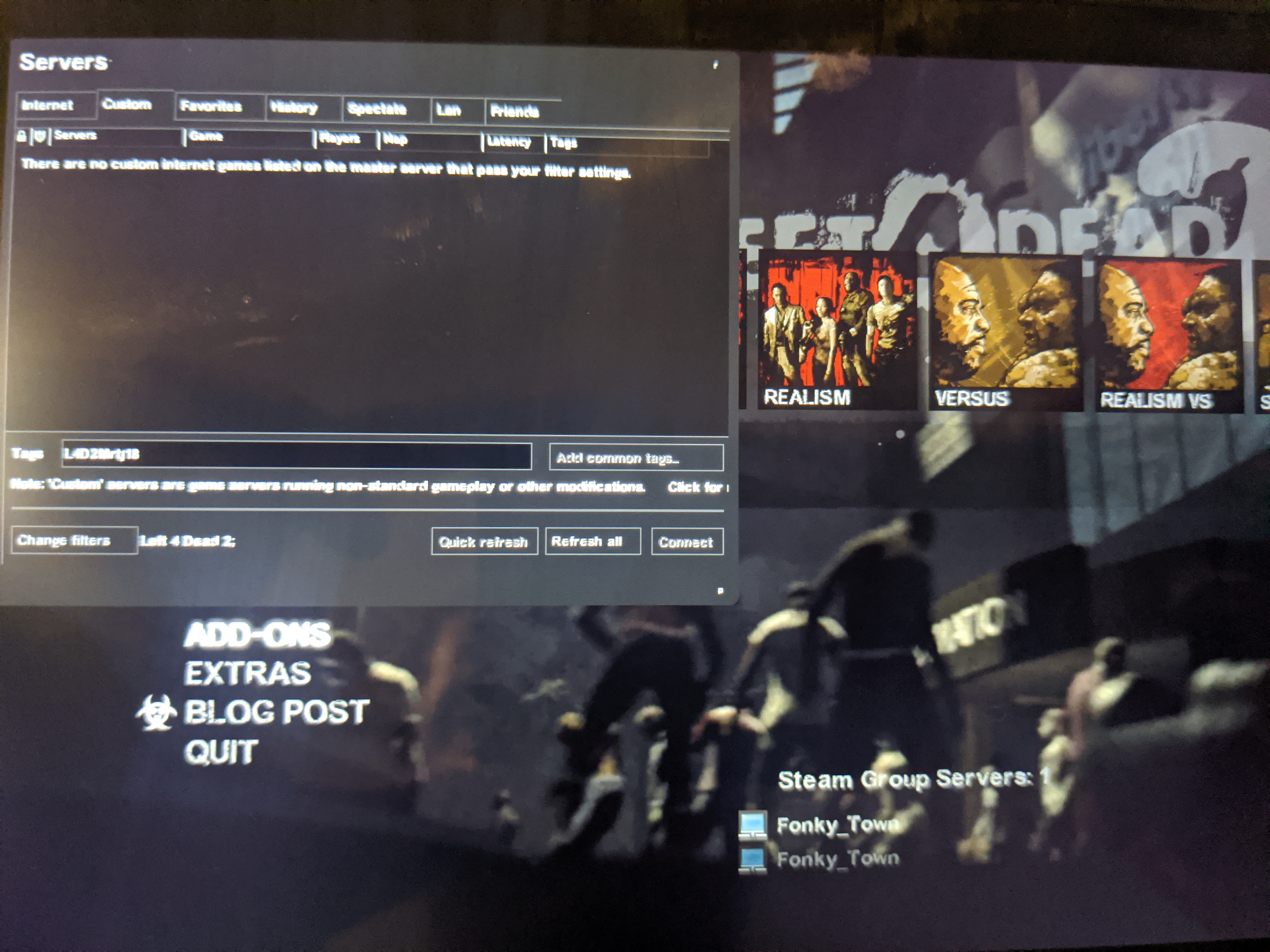

where are you typing this info in at to find the game? the custom tab, within the server browser menu? within the L4D2 game? When I enter this in the tags section it comes back blank. @ich777

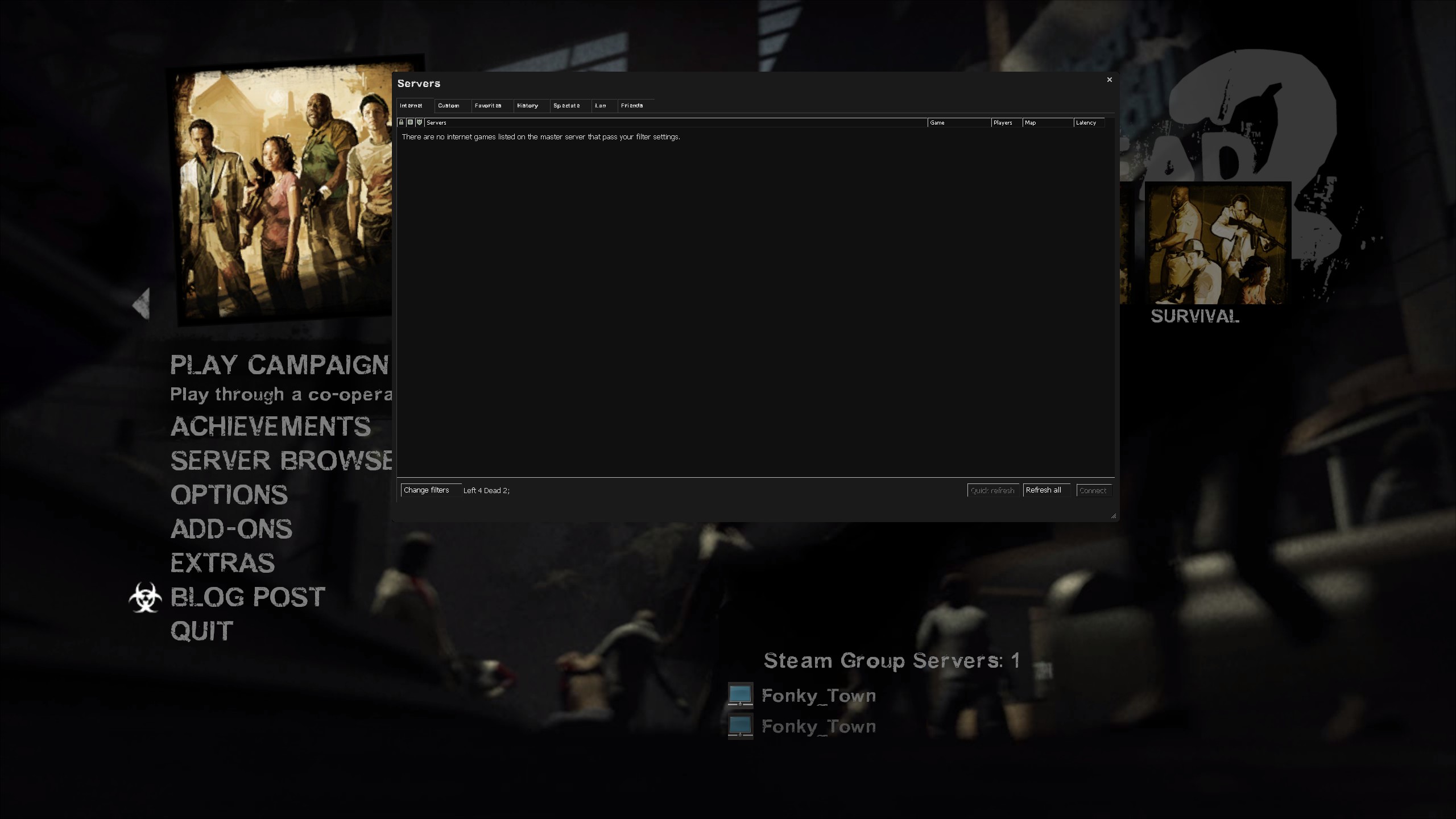

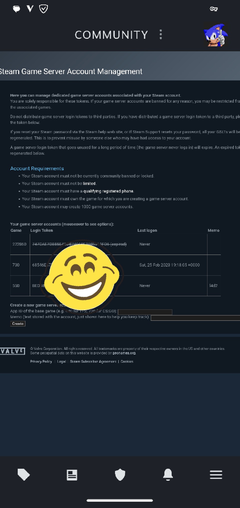

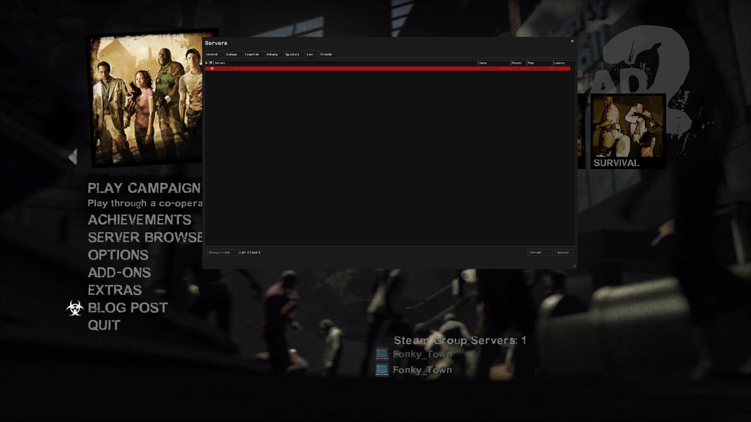

I tired the +sv_setsteamaccount on the game_params section and still its a no go... I tried the following things: 1. Deleted steamcmd and the L4D2 folder deleted the the image reinstalled, still a no go.... 2. Changed the server.cfg file still a no go... 3. Deleted the server.cfg file still a no go.... 4. Started a co-op game from the main menu waited till people joined, changed the server type to "steam dedicated group server"... Game would load eventually, but kick out all other players that was in my lobby... So once again when the game starts once again I'm on my own.... 5. i have the port 27015 upd set on my router I'm stumped, cant figure it out for the life of me. And once again the server shows but nobody else can see it.... @ich777

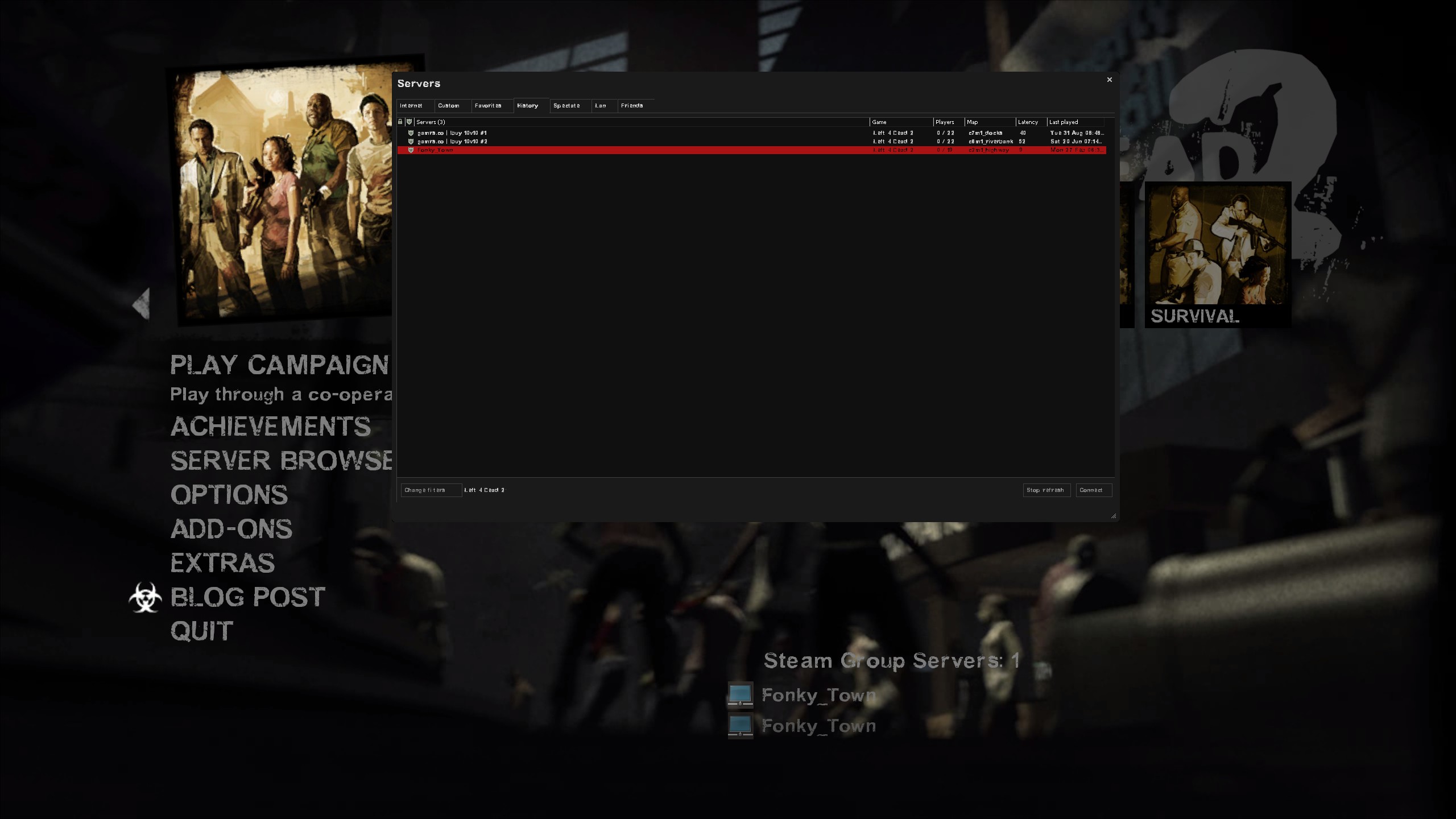

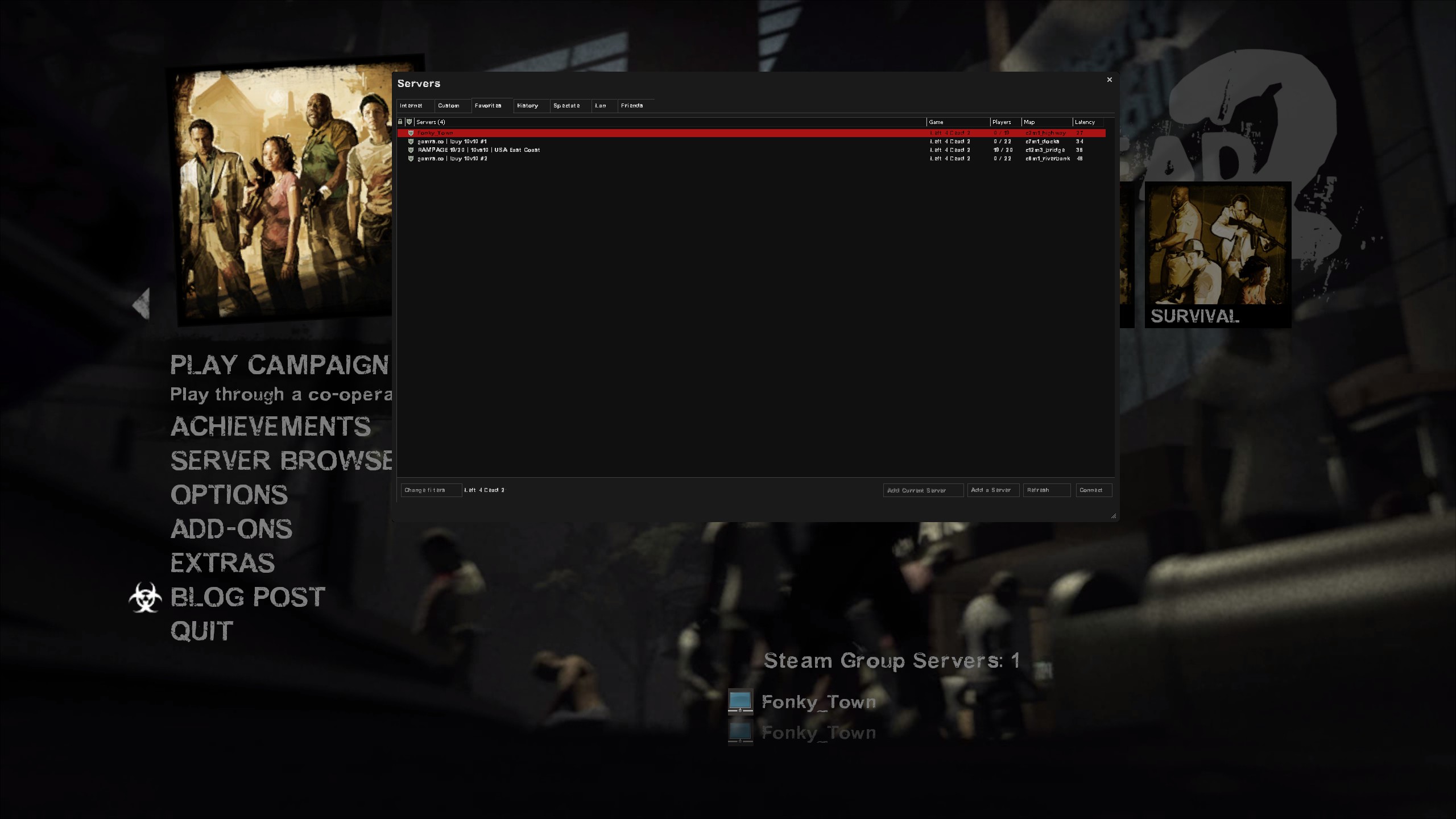

Im not sure what you mean by hair pin NAT or even if I have that. But when I use my steam deck boot up left 4 dead 2 and connect to it via my cell phones hot spot so im not on my local network. The server is only viewable in my saved favorites section. It does not show in the internet section, custom games, or lan ( for obvious reasons, because I'm no longer on my LAN network) So If I don't use the connect command in the console followed by my ip address I cant connect to the server.
I set up a left4dead 2 server and I see it in my steam group server at the bottom of my main menu screen, in my lan connection menu, and I can connect to it using my server IP address followed by the port number. And others outside my network can connect to it as well using my IP address and port. My question is, how can I make sure it shows in the public list for random people to join? Because people can only connect using my IP address. Because when I check the steam token for left4dead2 it shows that it's never connected. But When my csgo server I set up for test purposes with no mods installed it shows up as active. And joinable in the server browser menu. By the way my left 4 dead sever has mods installed. server config attached. Also whe sv_cheat 1 is on i cannot find it on the lan page or history page. only the steam server group is avalible Any help appreciated. server.cfg

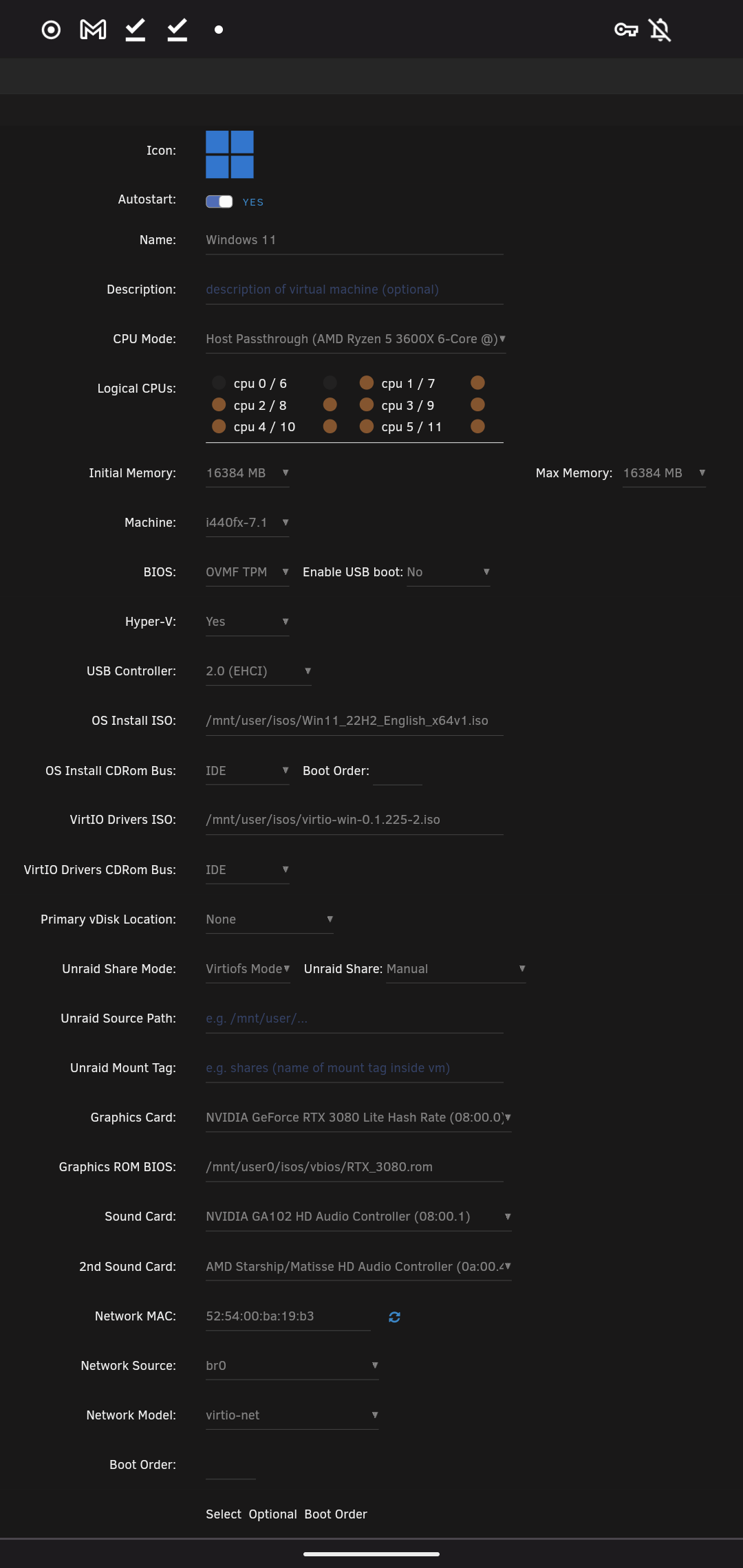

I will admit I had a few issues getting my rtx 3080 to boot correctly within windows 11 VM. I had to: 1. Delete my windows 11 VM and vdisk from the VM menu and start all the way over. 2. Pass through my windows 11 nvme drive that already had windows 11 ruining. ( had issues getting it to run properly by installing it on a vdisk from my cache drive) 3. I used spaceinvadors GPU dumping tool found in his video. ( I only have 1 3080 in my primary GPU slot) 4. I had to set up the VM with the virtual machine GPU first, on first boot. Attempting to use the dumped GPU BIOS and passed through video and sound of my rtx 3080 would give me a black screen on first boot and would hang. Hopefully my experience may help with installing windows 10 VM with your GPUs.

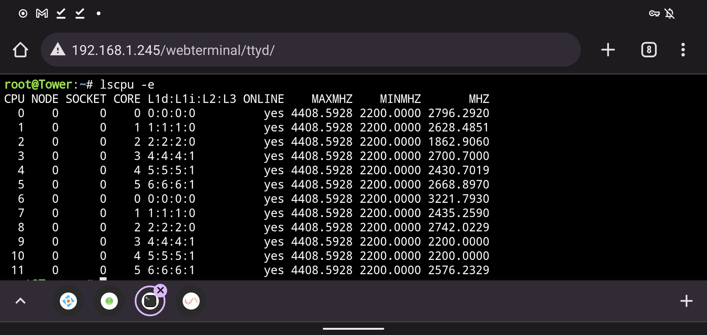

@hot22shot So I have a AMD 3600x and I ran the lscpu -e command and I got the attached CPU config.... So for me should my CPU paring be like this : 1+7.... 0+6... 2+8... 3+9...4+10...5+11..? So should I dedicate 1+7 and 0+6 to unraid, and pin the rest to my windows VM?
