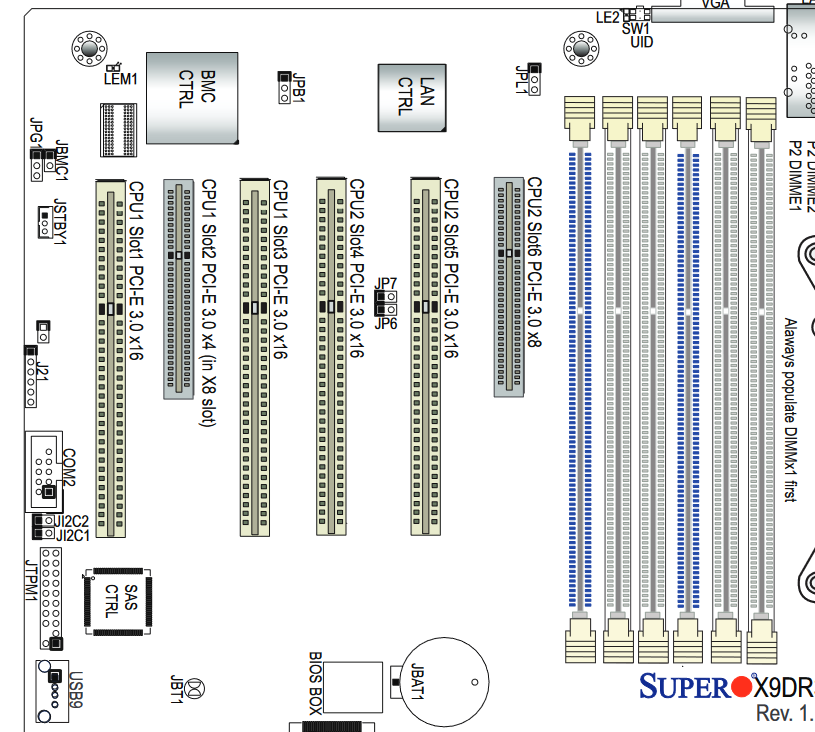

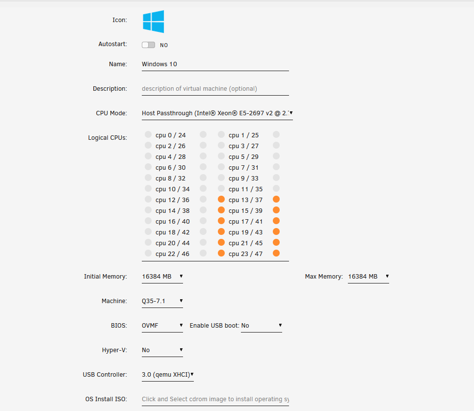

Which OS vers are you running.
Is the PCI slot and the allocated CPU cores on the same NUMA node?
Not sure if you will need to enable Hugepages to get the throughput.
Hello !
Windows 10 22H2
And I put the M6000 on the first X16 slot so in principle it is the second NUMA Nodeimage.png.7b63f89af303876cac14b58a6e131d68.png
7 minutes ago, DarkyCage said:
Hello !
Windows 10 22H2
Hi which Unraid OS vers are you running?
UNRAID 6.11.5
27 minutes ago, DarkyCage said:
UNRAID 6.11.5
I have not tried hugepages, but there is a thread here

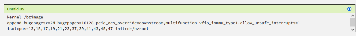

I just activated Hugepages and I still have bad performance with the GPU which is almost not usedimage.thumb.png.33fccd3cbd074196623fcad806e7d0da.png
xml version='1.0' encoding='UTF-8'?> type='kvm' id='1'> Windows 10 6545ed2e-ae0f-e830-c1f1-895626f6639d     xmlns="unraid" name="Windows 10" icon="windows.png" os="windows10"/>   unit='KiB'>16777216  unit='KiB'>16777216          placement='static'>12     vcpu='0' cpuset='13'/>    vcpu='1' cpuset='37'/>    vcpu='2' cpuset='15'/>    vcpu='3' cpuset='39'/>    vcpu='4' cpuset='17'/>    vcpu='5' cpuset='41'/>    vcpu='6' cpuset='19'/>    vcpu='7' cpuset='43'/>    vcpu='8' cpuset='21'/>    vcpu='9' cpuset='45'/>    vcpu='10' cpuset='23'/>    vcpu='11' cpuset='47'/>     /machine      arch='x86_64' machine='pc-q35-7.1'>hvm    readonly='yes' type='pflash'>/usr/share/qemu/ovmf-x64/OVMF_CODE-pure-efi.fd   /etc/libvirt/qemu/nvram/6545ed2e-ae0f-e830-c1f1-895626f6639d_VARS-pure-efi.fd            mode='custom'>      state='on'/>      state='on'/>      state='on' retries='8191'/>      state='on' value='none'/>      mode='host-passthrough' check='none' migratable='on'>    sockets='1' dies='1' cores='6' threads='2'/>    mode='passthrough'/>   offset='localtime'>    name='hypervclock' present='yes'/>    name='hpet' present='no'/>  destroy restart restart    /usr/local/sbin/qemu    type='file' device='disk'>      name='qemu' type='raw' cache='writeback'/>      file='/mnt/user/domains/Windows 10/vdisk1.img' index='3'/>           dev='hdc' bus='virtio'/>      order='1'/>      name='virtio-disk2'/>      type='pci' domain='0x0000' bus='0x03' slot='0x00' function='0x0'/>       type='file' device='cdrom'>      name='qemu' type='raw'/>      file='/mnt/user/isos/Windows.iso' index='2'/>           dev='hda' bus='sata'/>           order='2'/>      name='sata0-0-0'/>      type='drive' controller='0' bus='0' target='0' unit='0'/>       type='file' device='cdrom'>      name='qemu' type='raw'/>      file='/mnt/user/isos/virtio-win-0.1.225-2.iso' index='1'/>           dev='hdb' bus='sata'/>           name='sata0-0-1'/>      type='drive' controller='0' bus='0' target='0' unit='1'/>       type='usb' index='0' model='ich9-ehci1'>      name='usb'/>      type='pci' domain='0x0000' bus='0x00' slot='0x07' function='0x7'/>       type='usb' index='0' model='ich9-uhci1'>      name='usb'/>      startport='0'/>      type='pci' domain='0x0000' bus='0x00' slot='0x07' function='0x0' multifunction='on'/>       type='usb' index='0' model='ich9-uhci2'>      name='usb'/>      startport='2'/>      type='pci' domain='0x0000' bus='0x00' slot='0x07' function='0x1'/>       type='usb' index='0' model='ich9-uhci3'>      name='usb'/>      startport='4'/>      type='pci' domain='0x0000' bus='0x00' slot='0x07' function='0x2'/>       type='sata' index='0'>      name='ide'/>      type='pci' domain='0x0000' bus='0x00' slot='0x1f' function='0x2'/>       type='pci' index='0' model='pcie-root'>      name='pcie.0'/>       type='pci' index='1' model='pcie-root-port'>      name='pcie-root-port'/>      chassis='1' port='0x8'/>      name='pci.1'/>      type='pci' domain='0x0000' bus='0x00' slot='0x01' function='0x0' multifunction='on'/>       type='pci' index='2' model='pcie-root-port'>      name='pcie-root-port'/>      chassis='2' port='0x9'/>      name='pci.2'/>      type='pci' domain='0x0000' bus='0x00' slot='0x01' function='0x1'/>       type='pci' index='3' model='pcie-root-port'>      name='pcie-root-port'/>      chassis='3' port='0xa'/>      name='pci.3'/>      type='pci' domain='0x0000' bus='0x00' slot='0x01' function='0x2'/>       type='pci' index='4' model='pcie-root-port'>      name='pcie-root-port'/>      chassis='4' port='0xb'/>      name='pci.4'/>      type='pci' domain='0x0000' bus='0x00' slot='0x01' function='0x3'/>       type='pci' index='5' model='pcie-root-port'>      name='pcie-root-port'/>      chassis='5' port='0xc'/>      name='pci.5'/>      type='pci' domain='0x0000' bus='0x00' slot='0x01' function='0x4'/>       type='pci' index='6' model='pcie-root-port'>      name='pcie-root-port'/>      chassis='6' port='0xd'/>      name='pci.6'/>      type='pci' domain='0x0000' bus='0x00' slot='0x01' function='0x5'/>       type='virtio-serial' index='0'>      name='virtio-serial0'/>      type='pci' domain='0x0000' bus='0x02' slot='0x00' function='0x0'/>       type='bridge'>      address='52:54:00:ae:a6:f1'/>      bridge='br0'/>      dev='vnet0'/>      type='virtio-net'/>      name='net0'/>      type='pci' domain='0x0000' bus='0x01' slot='0x00' function='0x0'/>       type='pty'>      path='/dev/pts/0'/>      type='isa-serial' port='0'>        name='isa-serial'/>           name='serial0'/>       type='pty' tty='/dev/pts/0'>      path='/dev/pts/0'/>      type='serial' port='0'/>      name='serial0'/>       type='unix'>      mode='bind' path='/var/lib/libvirt/qemu/channel/target/domain-1-Windows 10/org.qemu.guest_agent.0'/>      type='virtio' name='org.qemu.guest_agent.0' state='disconnected'/>      name='channel0'/>      type='virtio-serial' controller='0' bus='0' port='1'/>       type='mouse' bus='ps2'>      name='input0'/>       type='keyboard' bus='ps2'>      name='input1'/>       id='1' type='none'/>    mode='subsystem' type='pci' managed='yes'>      name='vfio'/>             domain='0x0000' bus='0x83' slot='0x00' function='0x0'/>           name='hostdev0'/>      file='/mnt/disk1/isos/vbios/m6000vbios.rom'/>      type='pci' domain='0x0000' bus='0x04' slot='0x00' function='0x0'/>       mode='subsystem' type='pci' managed='yes'>      name='vfio'/>             domain='0x0000' bus='0x83' slot='0x00' function='0x1'/>           name='hostdev1'/>      type='pci' domain='0x0000' bus='0x05' slot='0x00' function='0x0'/>       mode='subsystem' type='usb' managed='no'>      startupPolicy='optional'>        id='0x04f2'/>        id='0x1516'/>        bus='2' device='4'/>           name='hostdev2'/>      type='usb' bus='0' port='1'/>       mode='subsystem' type='usb' managed='no'>      startupPolicy='optional'>        id='0x258a'/>        id='0x1007'/>        bus='2' device='3'/>           name='hostdev3'/>      type='usb' bus='0' port='2'/>       model='none'/>   type='dynamic' model='dac' relabel='yes'>   +0:+100   +0:+100
Does the card have HDMI so audio and video pci devices in iommu? I don't see multifunction but notice you have an m6000 which may not split?
Sent from my SM-G996U using Tapatalk
<domain type='kvm' id='1'>
  <name>Windows 10</name>
  <uuid>6545ed2e-ae0f-e830-c1f1-895626f6639d</uuid>
  <metadata>
  </metadata>
  <memory unit='KiB'>16777216</memory>
  <currentMemory unit='KiB'>16777216</currentMemory>
  <memoryBacking>
    <hugepages/>
    <nosharepages/>
  </memoryBacking>
  <vcpu placement='static'>12</vcpu>
  <cputune>
    <vcpupin vcpu='0' cpuset='13'/>
    <vcpupin vcpu='1' cpuset='37'/>
    <vcpupin vcpu='2' cpuset='15'/>
    <vcpupin vcpu='3' cpuset='39'/>
    <vcpupin vcpu='4' cpuset='17'/>
    <vcpupin vcpu='5' cpuset='41'/>
    <vcpupin vcpu='6' cpuset='19'/>
    <vcpupin vcpu='7' cpuset='43'/>
    <vcpupin vcpu='8' cpuset='21'/>
    <vcpupin vcpu='9' cpuset='45'/>
    <vcpupin vcpu='10' cpuset='23'/>
    <vcpupin vcpu='11' cpuset='47'/>
  </cputune>
  <resource>
  </resource>
  <os>
    <type arch='x86_64' machine='pc-q35-7.1'>hvm</type>
    <nvram>/etc/libvirt/qemu/nvram/6545ed2e-ae0f-e830-c1f1-895626f6639d_VARS-pure-efi.fd</nvram>
  </os>
  <features>
    <acpi/>
    <apic/>
    <hyperv mode='custom'>
      <relaxed state='on'/>
      <vapic state='on'/>
    </hyperv>
  </features>
    <topology sockets='1' dies='1' cores='6' threads='2'/>
    <cache mode='passthrough'/>
  </cpu>
