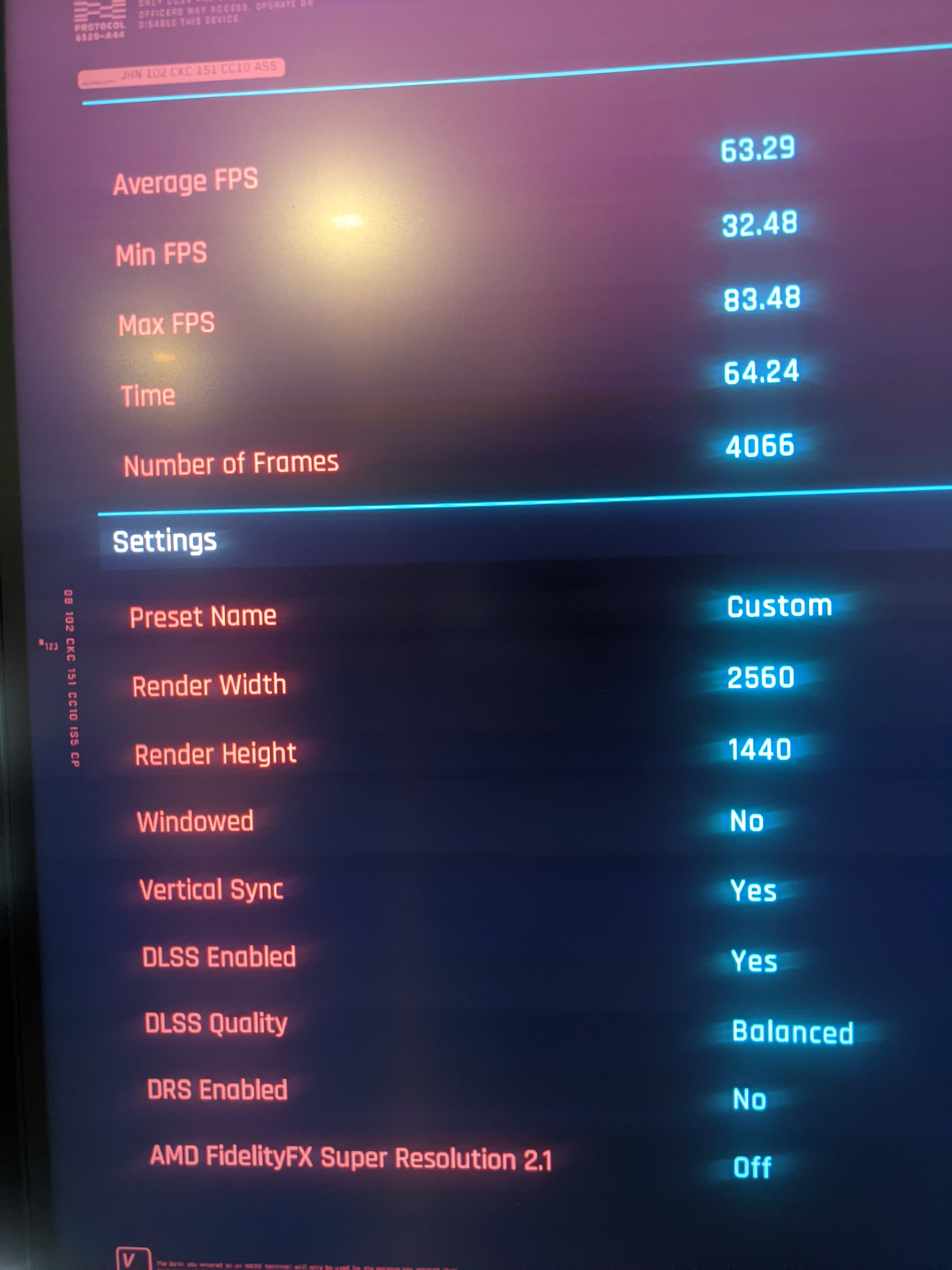

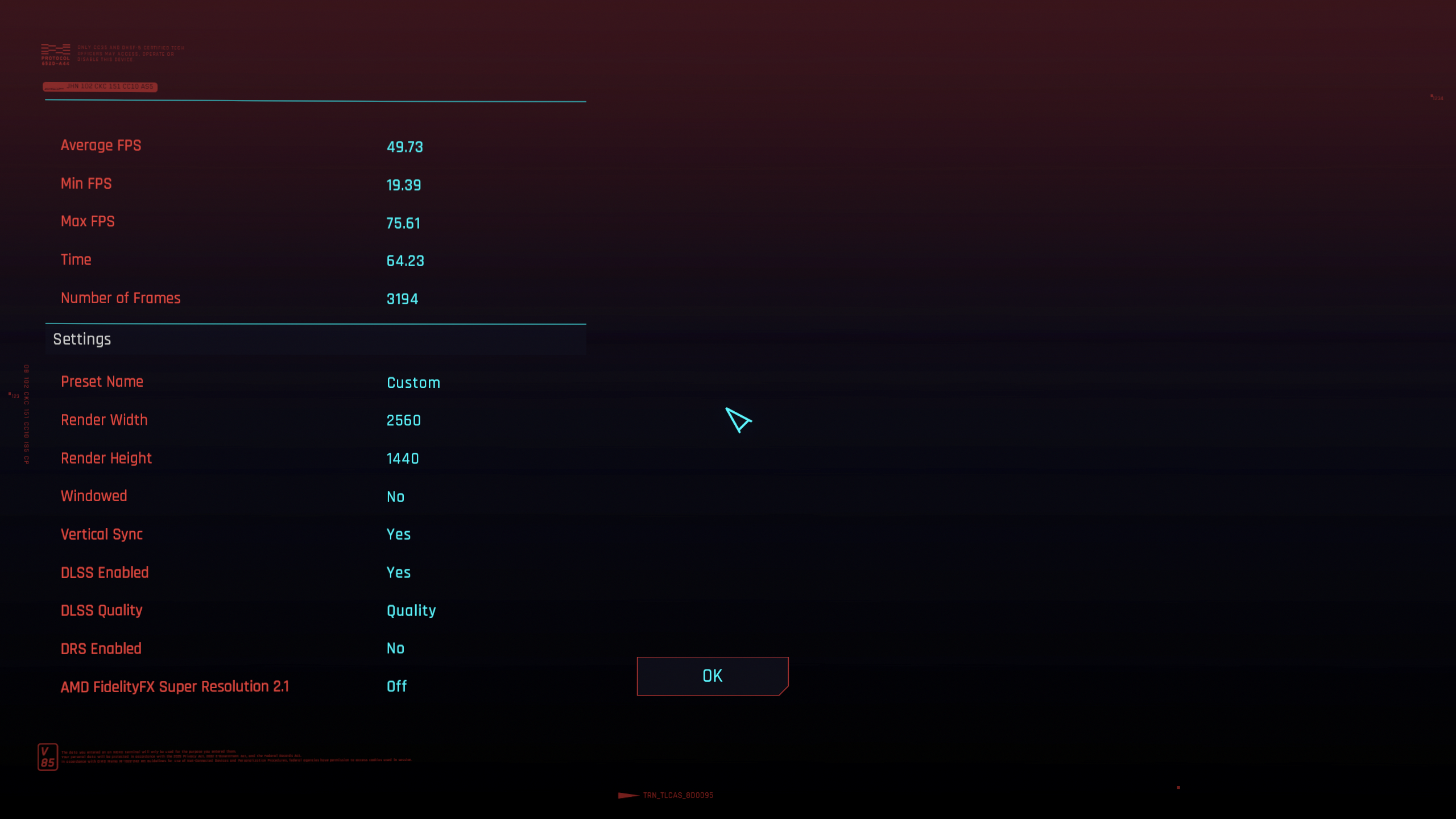

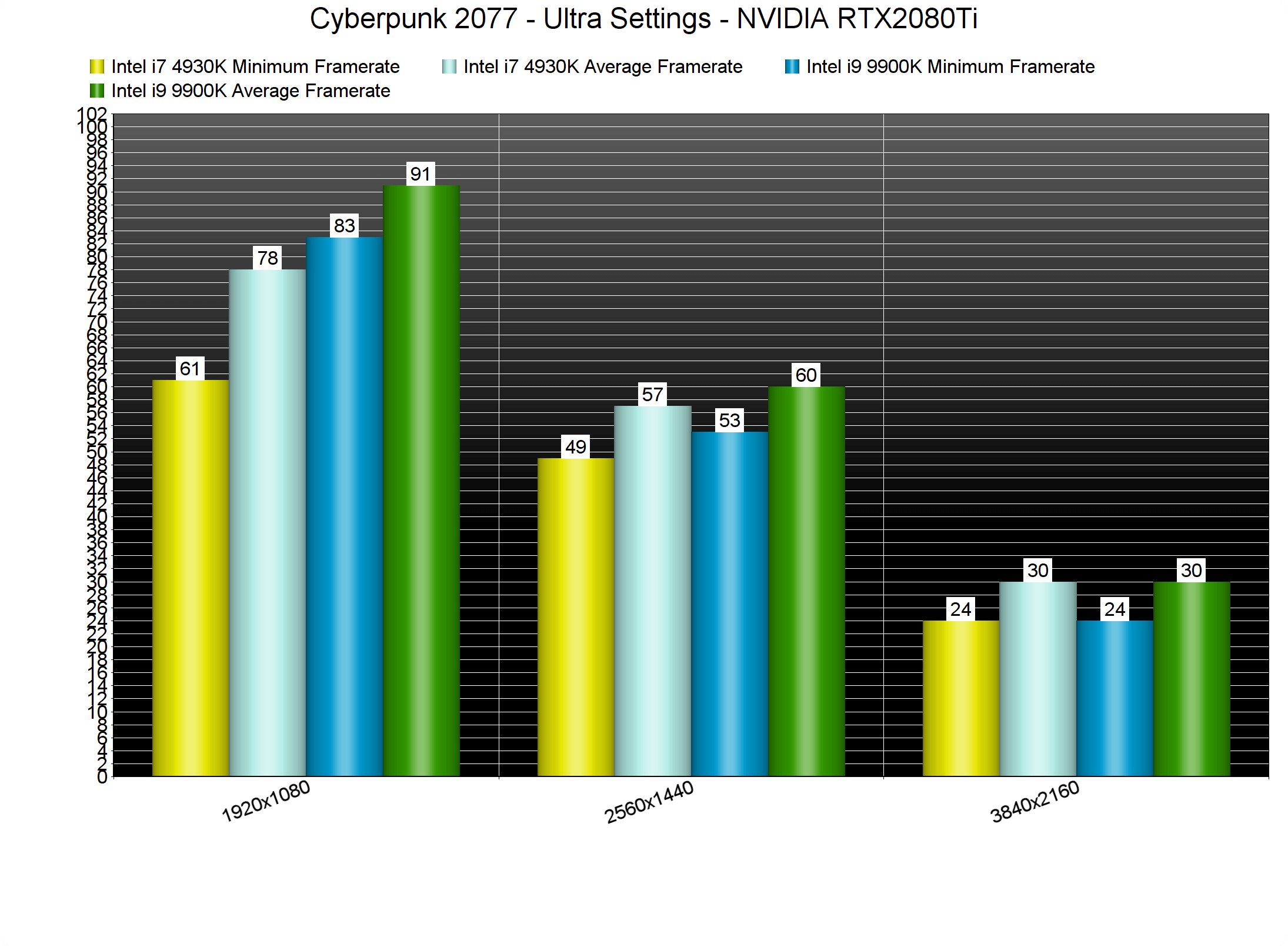

These are screenshots of my benchmark. One is from my bare metal results, and the next is from my windows VM.
This is with the pinned CPUs we discussed.
So about 64% performance. This seems like roughly what I've been seeing on my system judging by the frame rates I've been getting.

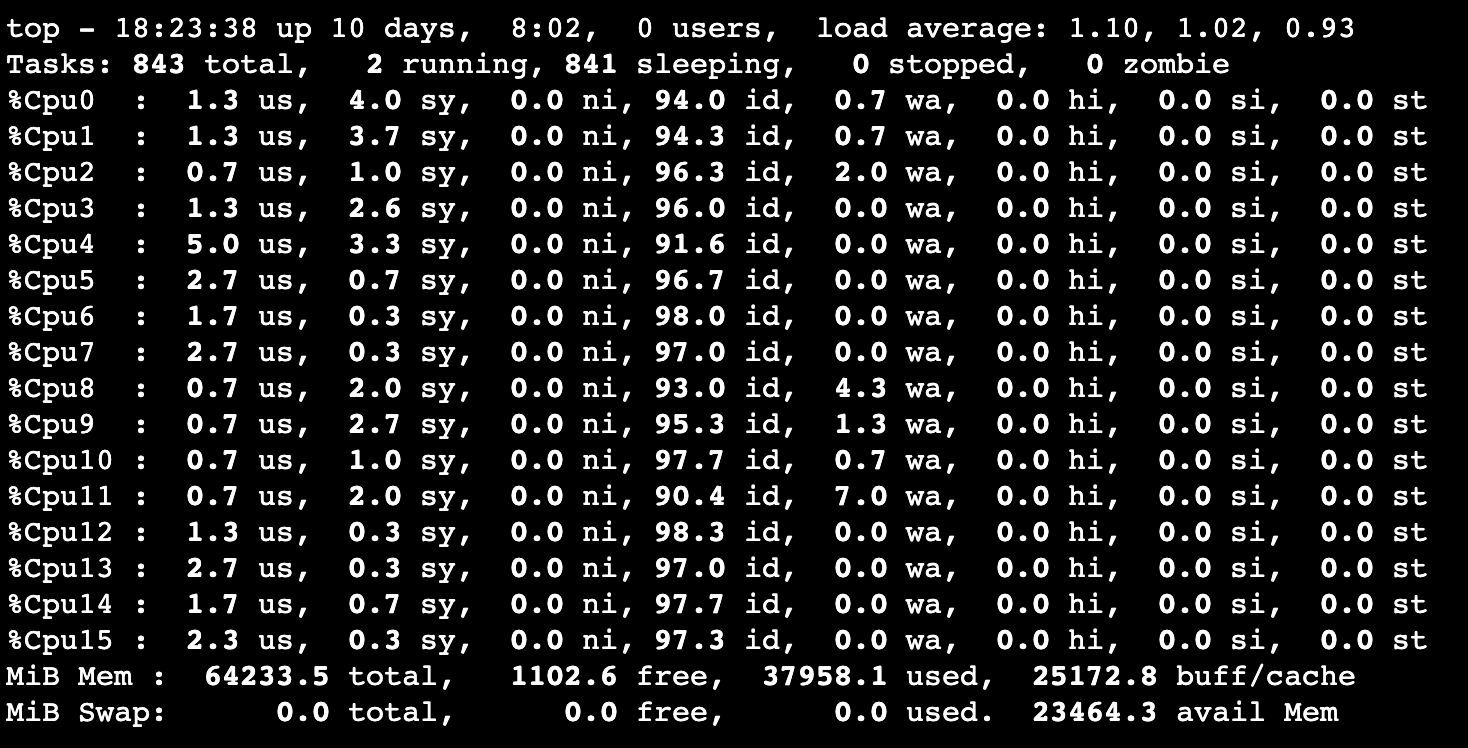

It might be interesting to capture a detailed output of the top command on the unraid host with all the core during a benchmark, something like that :
Edited by hot22shot
As soon as my new SAS card comes this weekend I will be doing some benchmarks and I'll try to capture some data. Also going to try some XML mods and see if I can get closer to maybe 85 or 90 percent of performance.
Sent from my SM-G996U using Tapatalk

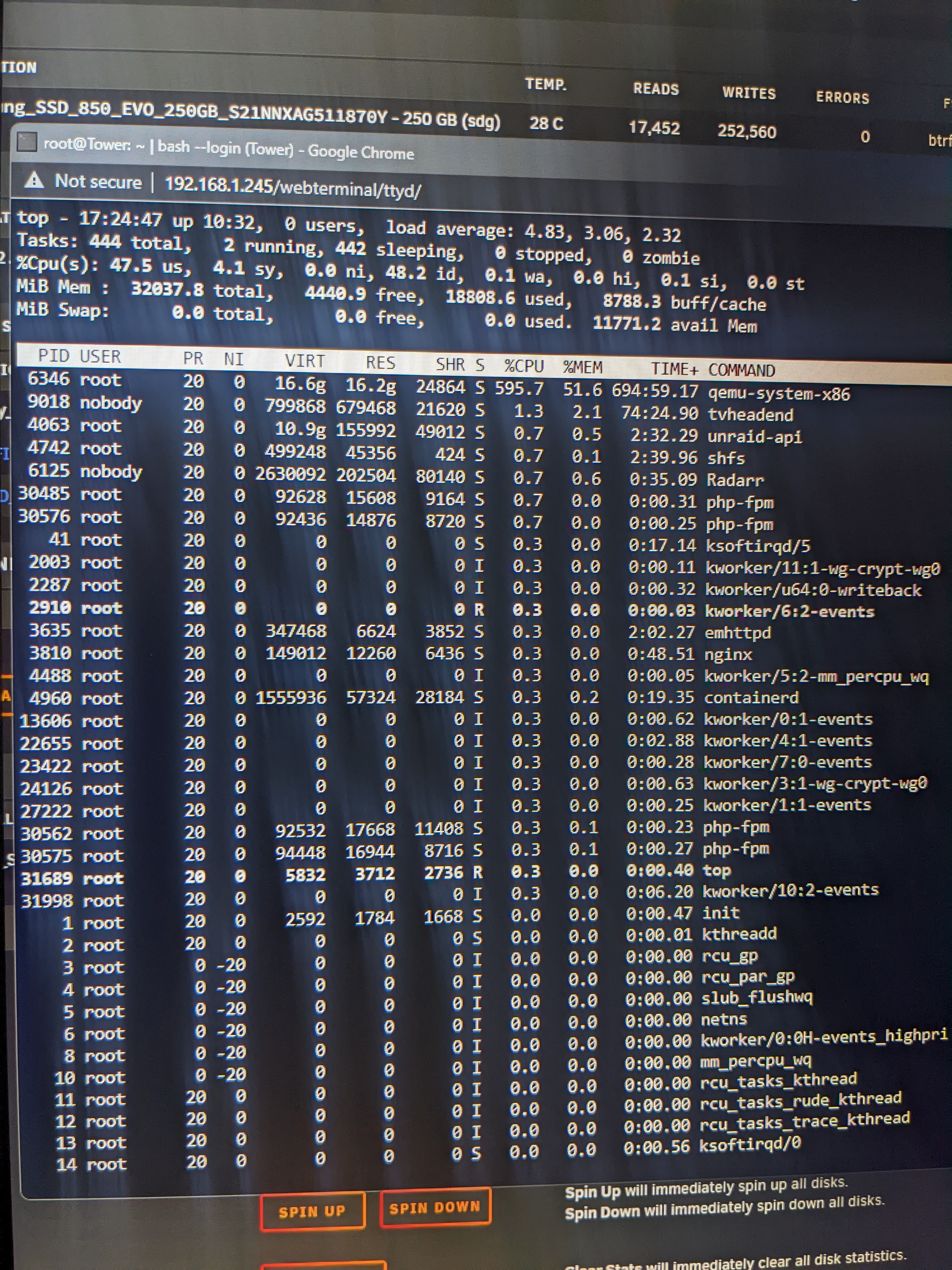

Attached is the top command within unraid of my system while running the cyberpunk benchmark WITH 3 pinned CPUs for the VM. I will have to run the benchmark again with all threads enabled when the girlfriend is not watching TV, with tvheadend enabled, because it may effect the TV playback. Lol...
The top line of qemu-system-x86 is the windows VM...

You can press 1 to have detailled data by CPU core, you'll be able to see the % of load for each status per core:
us: user cpu time (or) % CPU time spent in user space
sy: system cpu time (or) % CPU time spent in kernel space
ni: user nice cpu time (or) % CPU time spent on low priority processes
id: idle cpu time (or) % CPU time spent idle
wa: io wait cpu time (or) % CPU time spent in wait (on disk)
hi: hardware irq (or) % CPU time spent servicing/handling hardware interrupts
si: software irq (or) % CPU time spent servicing/handling software interrupts
st: steal time - - % CPU time in involuntary wait by virtual cpu while hypervisor is servicing another processor (or) % CPU time stolen from a virtual machine
When playing or during a benchmark, your processor is at 100% so it's doing something, the question is what.
This tool might tell us if it's busy with something else, by disk IO for example (wa).
Edited by hot22shot

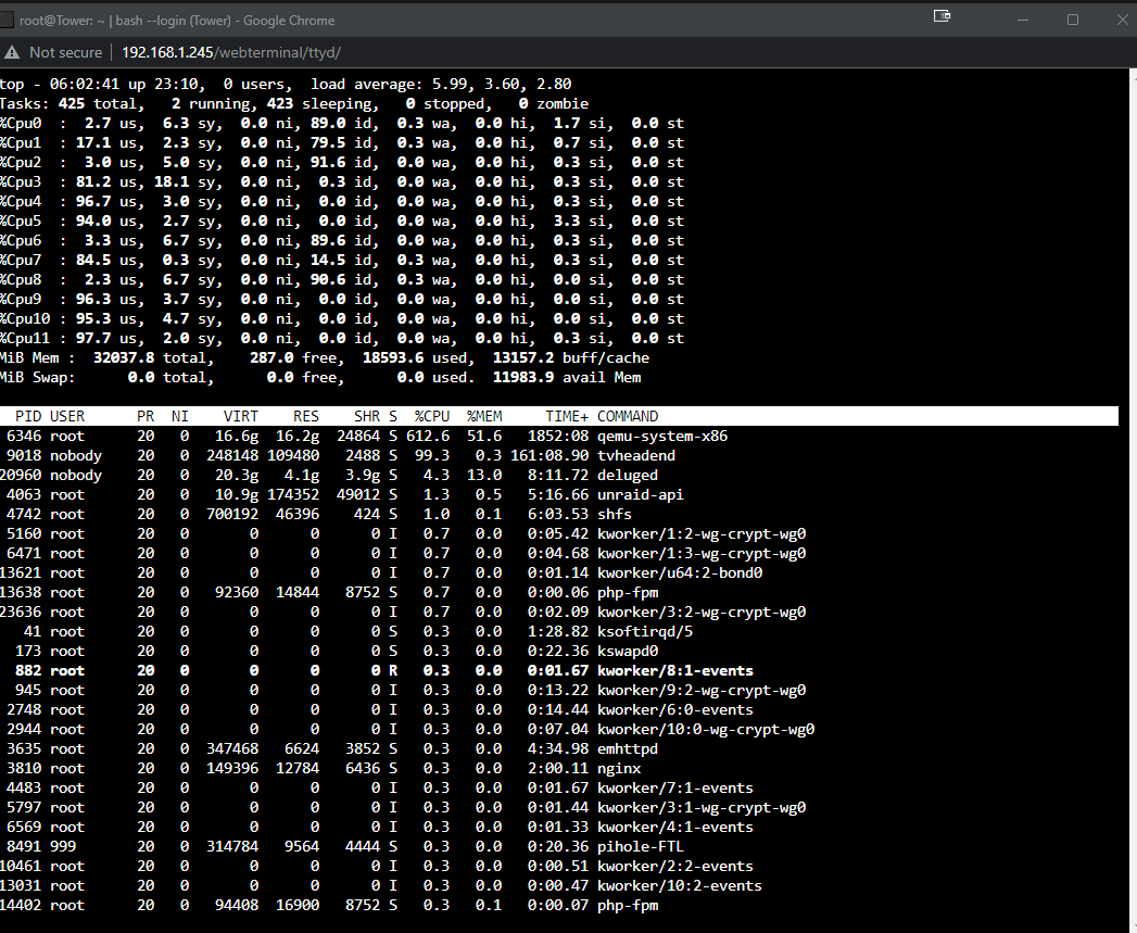

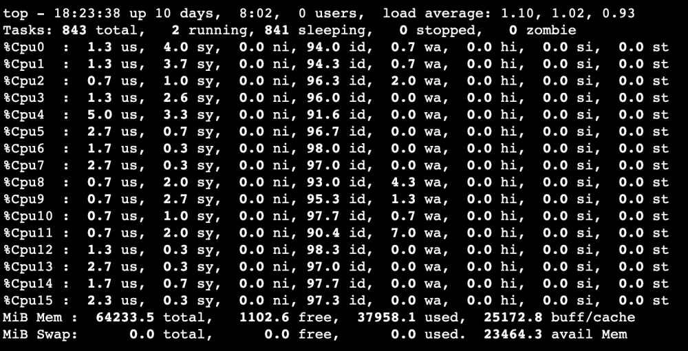

Here is the detailed look you asked for, please ignore the high usage for tvheadend, it will spike from time to time. but I have that app pinned to different cores than the windows VM. ( 0,1,2+6,7,*)
So playing infinite my frame rate is half it says I am using 27 percent of my gpu and 77 percent of CPU. I pinned/isolated all to upper CCX86e8b575a42a87b2d327255fa0c4f79b.jpg
I noticed that running 3dmark I am able to get very similar performance in VM (12 vcpus) and Bare Metal. It is just strange in games I get about half my gpu utilized. Is the time spent in kernel space causing a bogging down?

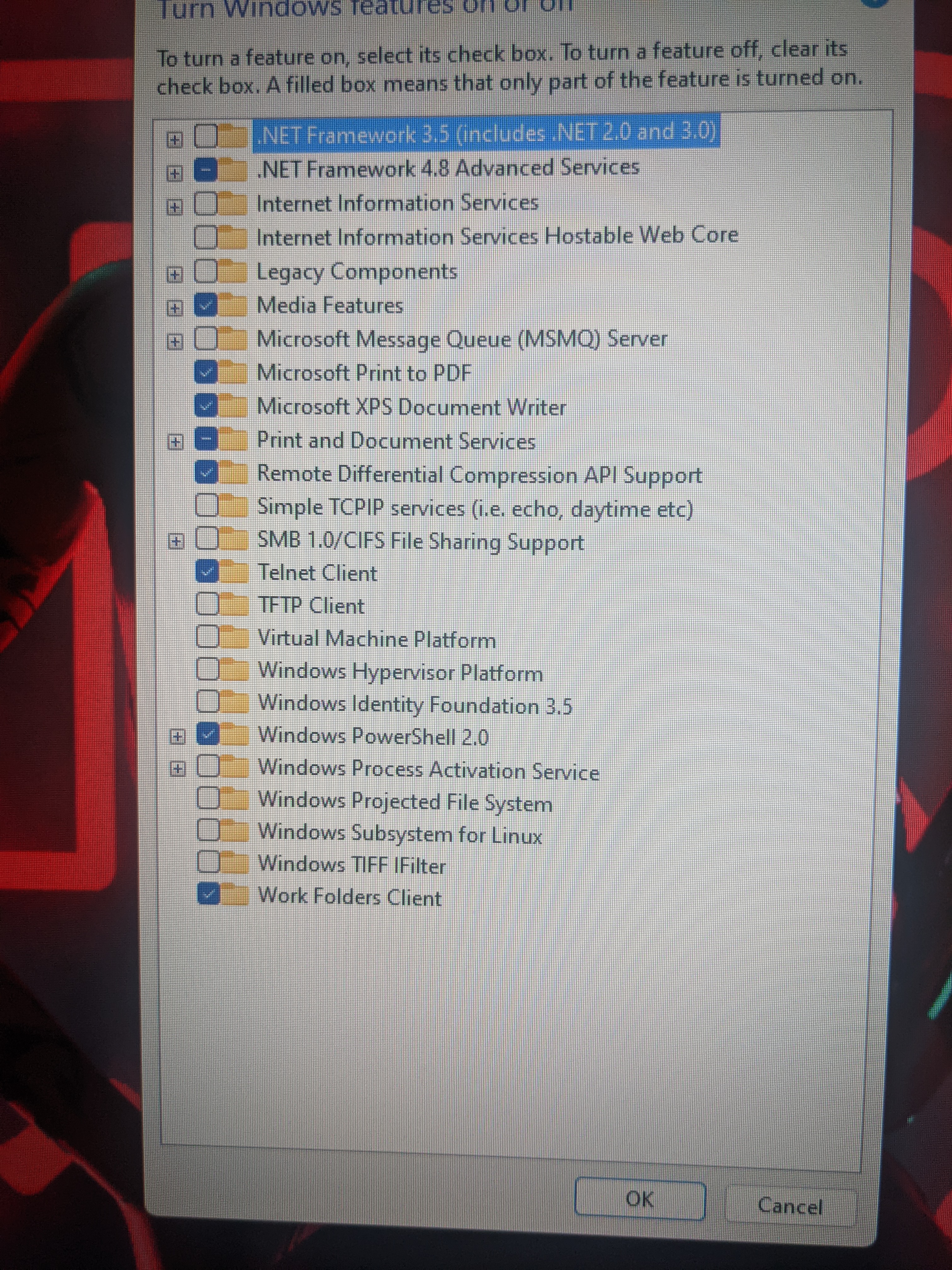

i found another post about a user on here complaining his 3090 was only about half performance. He said under windows features not having hyperv/sandbox/linux workspace installed improved his performance. Sure enough I turned off hyperv in windows features and my gpu utilization went way up. Just tested out diablo 2 and was using 98 percent of the gpu and 225 fps. Also played the callisto protocol on the vm and was holding good frames and 80 percent plus in most areas on GPU and 98 on Vram.
I wish this applied to me, I checked this before I even posted in this topic and as u can see I do not have those options, or its not enabled on my setup... I'm stuck here, not sure what else to try.

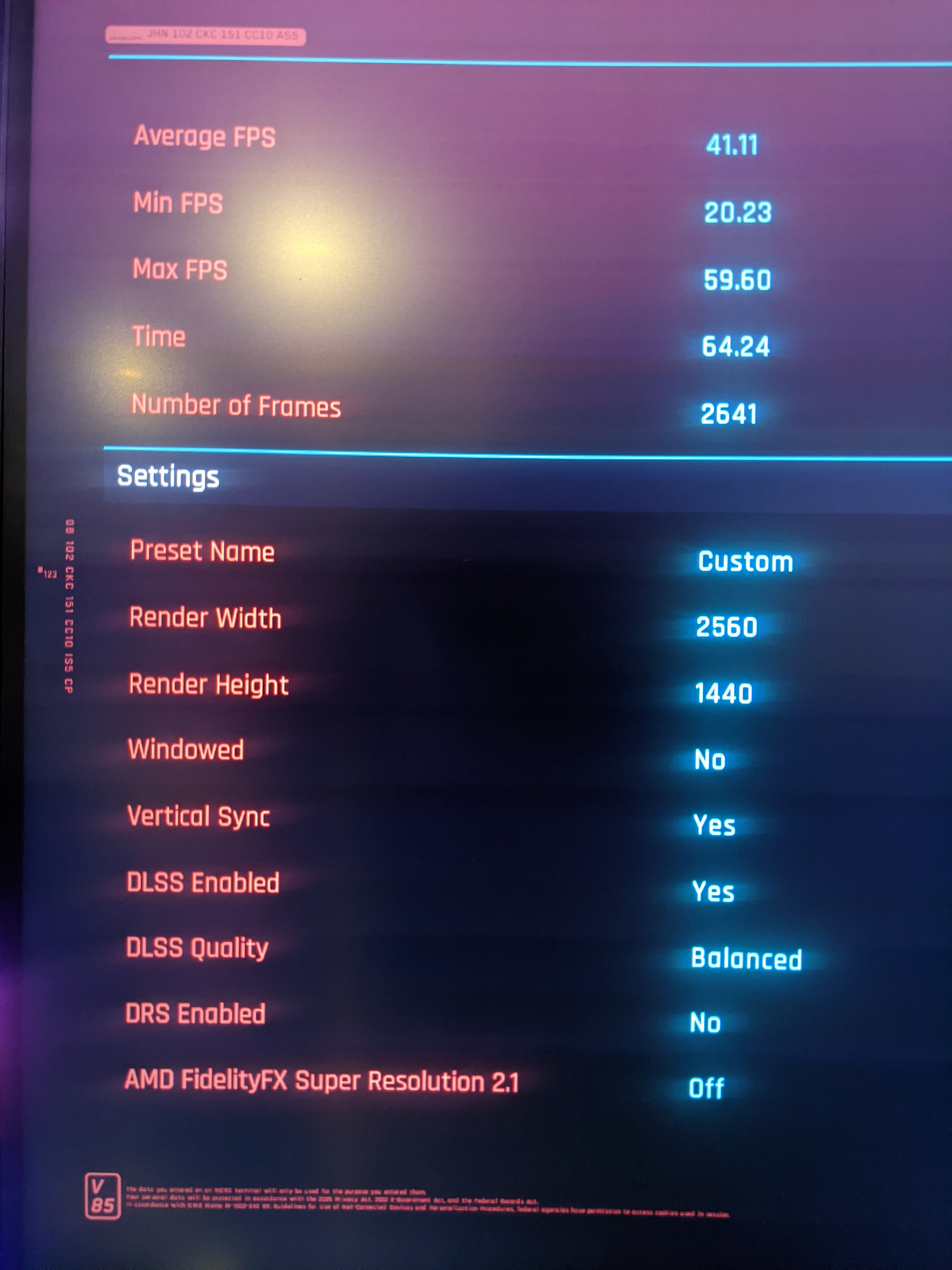

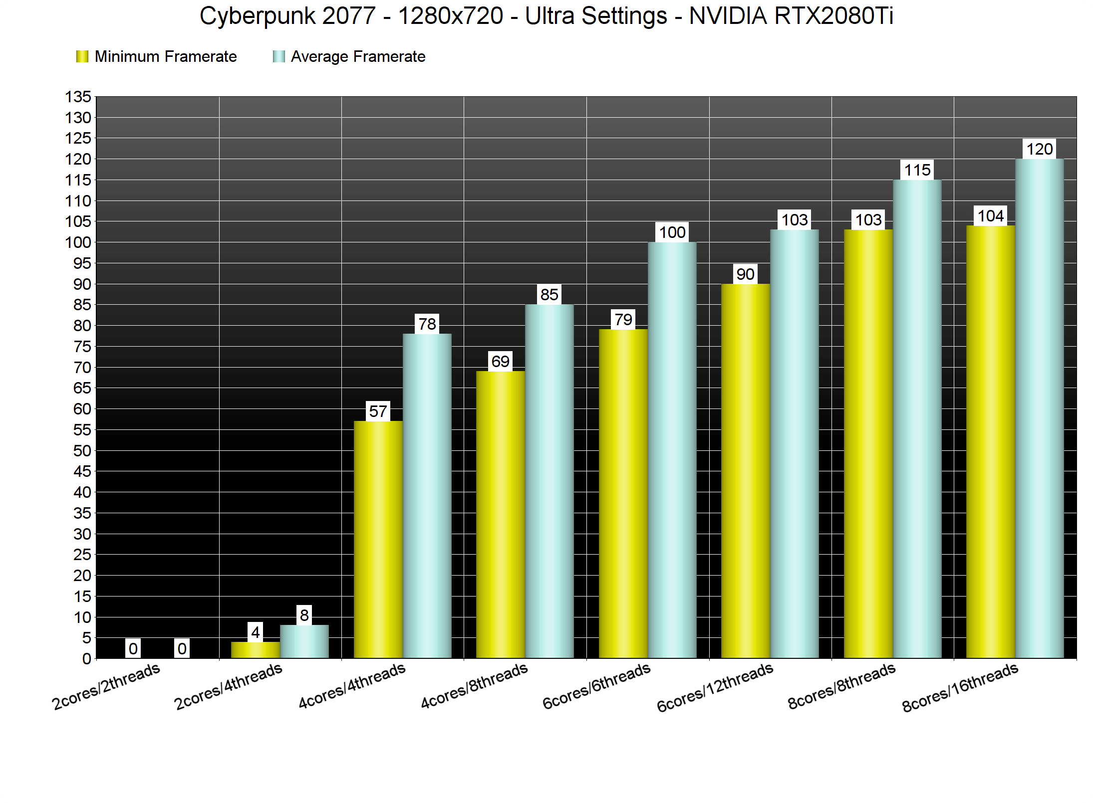

Welp seems I figured it out..... My issue of "low performance" was due to the low amount of cores allocated to my Windows VM. With only 3 cores dedicated to the VM I was getting 41 FPS average. And with 5 cores and 5 threads allocated my ryzen 5 3600x is performing more like an i7 4930k. So my performance is on par on what it should be. I just need to save up some more funds to purchase a higher core processor that can allow me to dedicate more  CPU resources to the VM. Because my RTX 3080 is just being bottlenecked.
Thanks for all your assistance @hot22shot
On to my next Unraid project!
