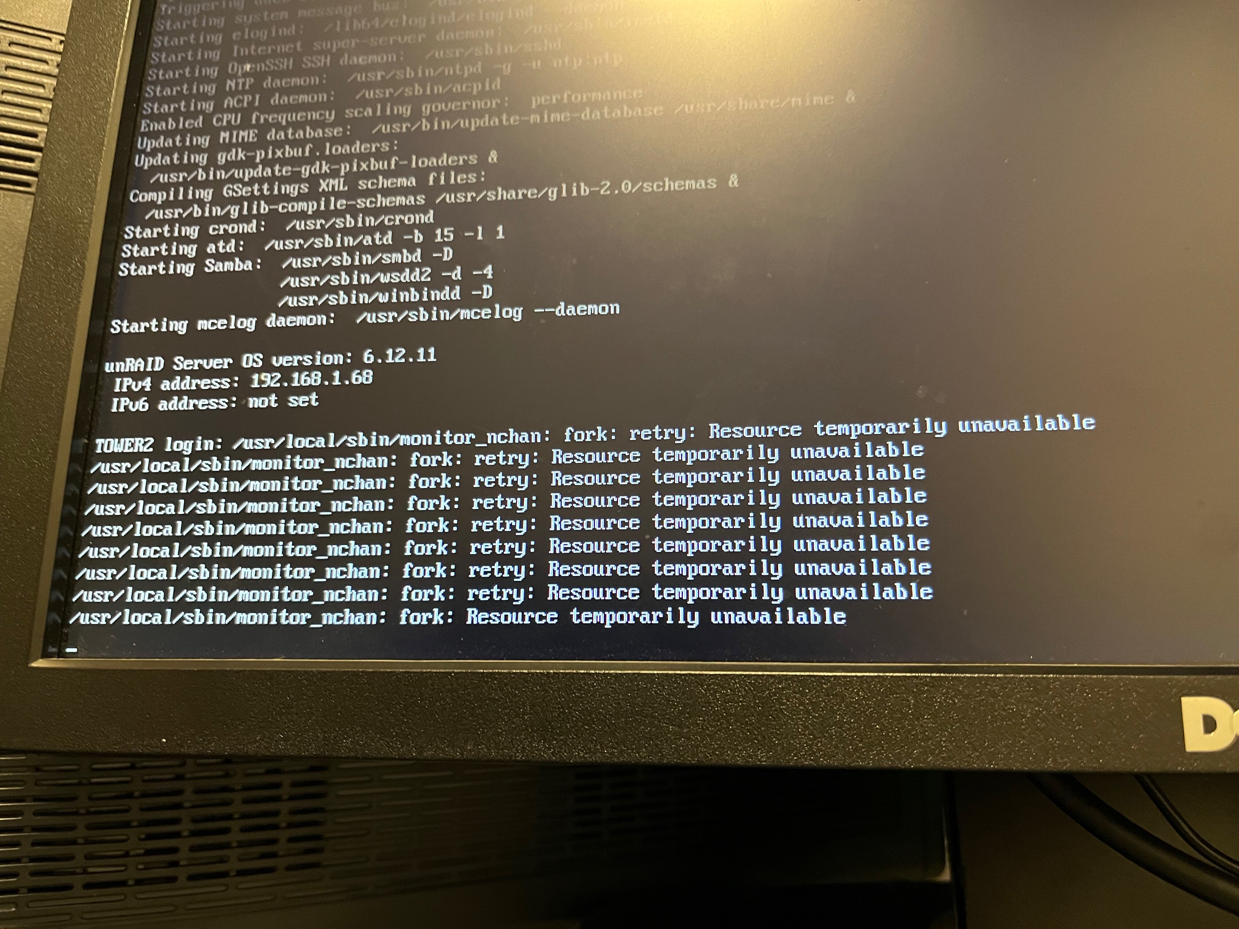

  1. Any luck figuring this out? I updated from 7.0.1 to 7.1.4 and i can ssh fine, but i have no UI access. Edit: I figured this out after doing some digging. I had been experiencing some issues with nchan logs and some memory leak with nginx. I had added the following line to my /boot/config/go file: sed -z 's|nchan publishers\n\t#|nchan publishers\n\t#\n\tnchan_shared_memory_size 2M;|' -i /etc/rc.d/rc.nginx and my nginx logs were complaining about duplicate directives for that. They musta fixed it upstream so when i commented that out and restarted, everything was back to normal. Hopefully this helps someone.

  6. Much appreciated @JorgeB. Your tip helped me find the misbehaving container. Music Assistant which looks to have an embedded snapcast server that when enabled is causing some serious issues.

  9. Im having issues with an install and am getting this error and the UI and ssh becomes completely unavailable. I can ping the host just fine though and SOME containers work but most are unresponsive. Its been happening every couple days for the past week. Attached are the syslog files (i think. Unsure which dumps people want). tower2-diagnostics-20240722-1903.zip
