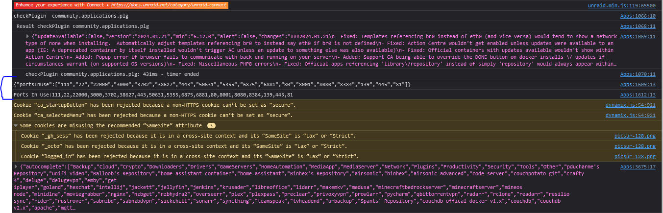

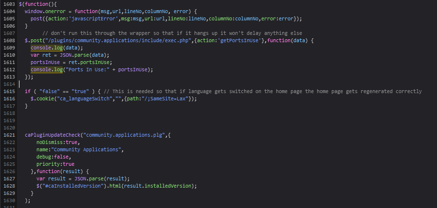

  6. Every time I go to /Apps I can see few console log messages: The origin of the logs seems to be this one: Why are these logs showing up? Have they been forgotten by the developer, is it a plugin or is the system compromised? Diagnostics here.

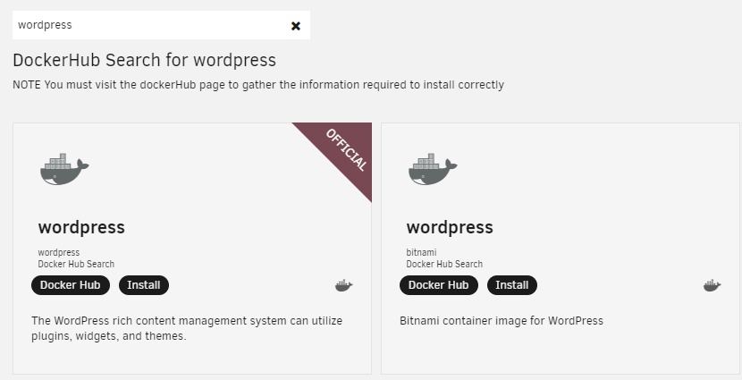

  7. @Kru-x Recently, for some reason Wordpress does not show anymore for me when searching for apps, already posted it here. It was showing a few days ago. Were there any changes recently that make it incompatible or something? Kinda desperate...

  10. Looking at this video (minute 1:33) there's a search for Wordpress, and this is the result: However... in my Unraid instance I cannot find it, why? I was able to see it few days ago.
  11. Every time I go to /Apps I can see few console log messages: The origin of the logs seems to be this one: Why are these logs showing up? Have they been forgotten by the developer, is it a plugin or is the system compromised?
  12. Did anyone check it?
