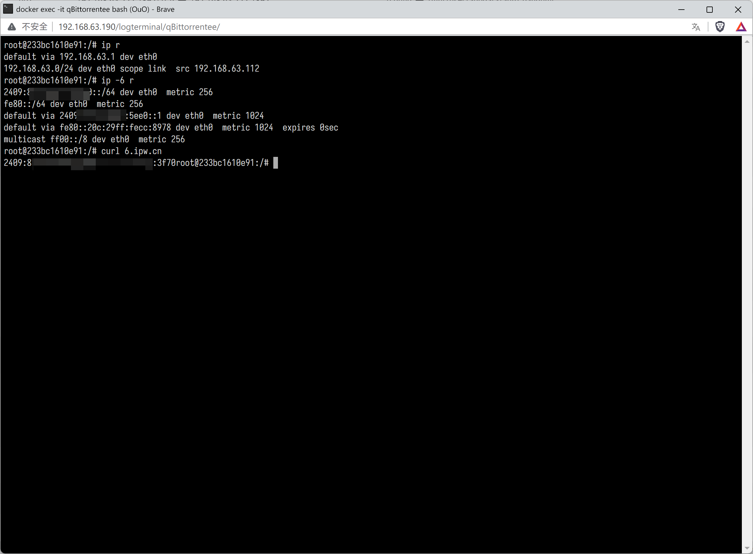

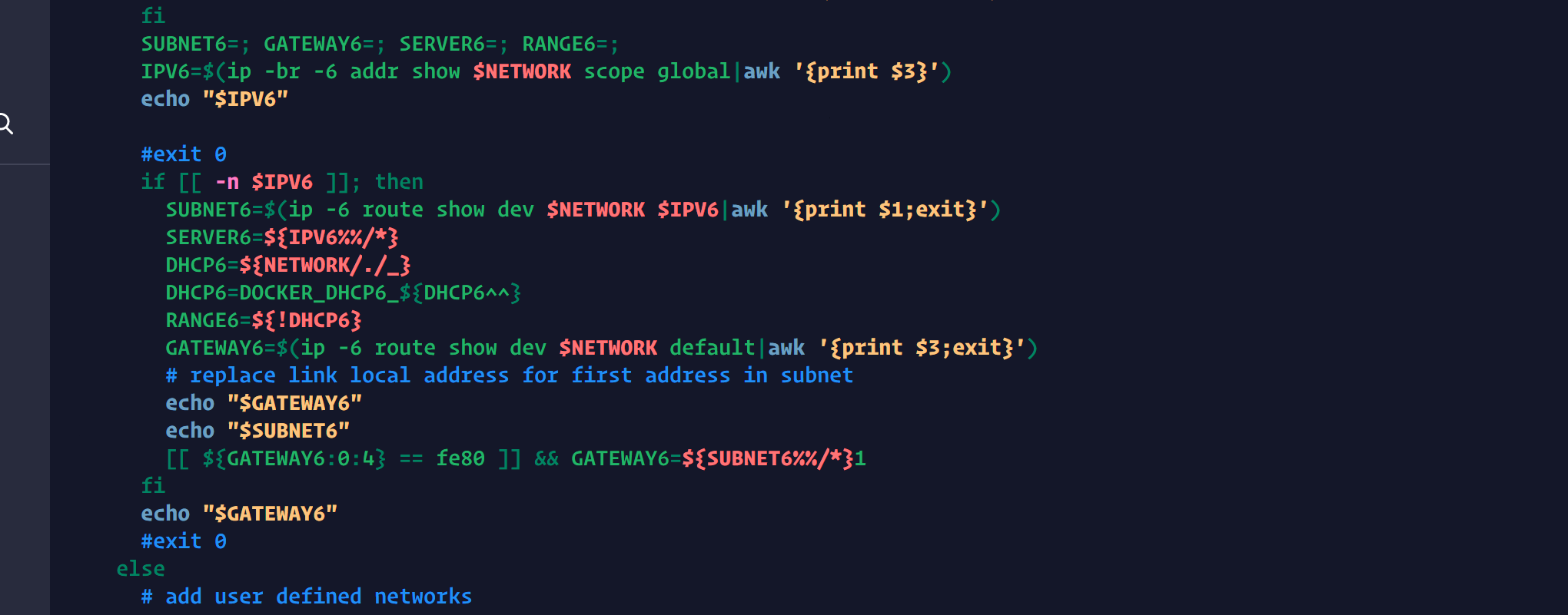

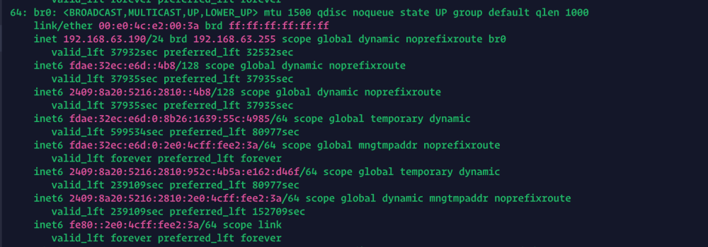

  1. AS the image shown, as the ipv6 prefix changed, the network setting will be broken —— Thus the br0(or eth0 here) can't be created as rc.docker start.

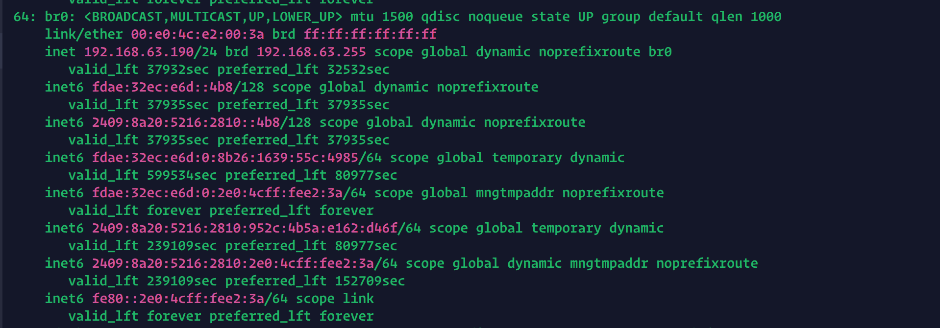

  2. I found a ssh terminated issue maybe related to previous issues: ssh can't connect. Reason: the ssh terminated and restart: report no address can to listen. After sshd can't start, the /etc/rc.d/rc.sshd restart will report: no parent sshd instance exist and exited. So that the ssh always die since that time point. ``` Aug 31 09:39:30 OuO sshd[19782]: error: Bind to port 22 on 2409:8a20:****:4cff:fee2:3a failed: Cannot assign requested address. Aug 31 09:39:30 OuO sshd[19782]: Server listening on 192.168.63.190 port 22. Aug 31 09:41:32 OuO sshd[3902]: Read error from remote host 192.168.63.172 port 53943: Connection reset by peer Aug 31 09:41:32 OuO sshd[3902]: pam_unix(sshd:session): session closed for user root Aug 31 09:41:32 OuO network: reload service: sshd Aug 31 09:41:32 OuO sshd[19782]: Received signal 15; terminating. Aug 31 09:41:32 OuO sshd[21965]: error: Bind to port 22 on 2409:8a20:****:4cff:fee2:3a failed: Cannot assign requested address. Aug 31 09:41:32 OuO sshd[21965]: fatal: Cannot bind any address. ```

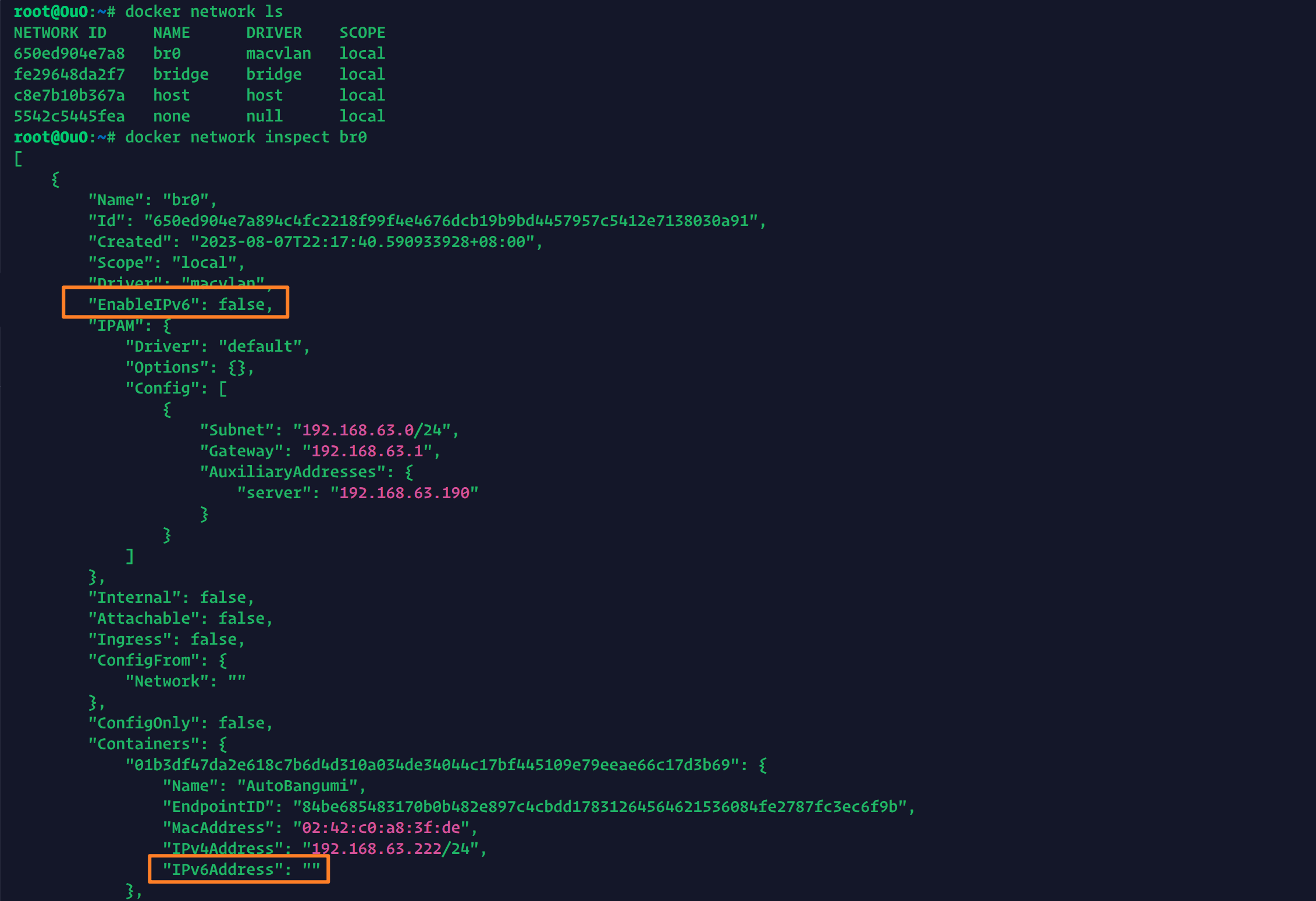

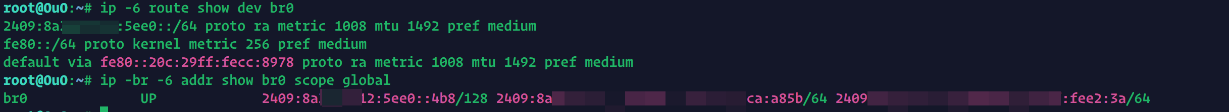

  3. As this post points that The docker script will use $IPV6(2409:xxxx:xxxx:5ee0::4b8/128) to get $SUBNET6(2409:xxxx:xxxx:5ee0::/64) via ip -6 route show dev $NETWORK $IPV6|awk '{print $1;exit}' It will case $SUBNET6 be null, and $GATEWAY6 always be 1 —— So that it leads to br0: ipv6 is disabled in docker network inspect.

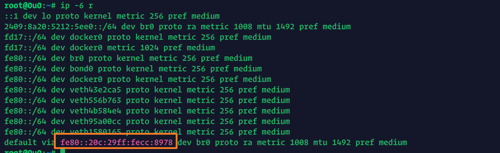

  4. I have figured out what is occurred this issue. More detail you can find at In a short, it might be a Unraid bug.

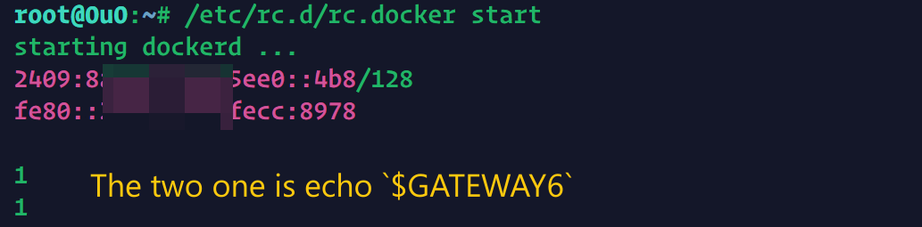

  5. I meet another issue, the subnet6 is not match with ipv6 in your scripts, and lead to gateway6 always be 1. The key script block: The Current result, subnet and ipv6: As this block done, the result is like: And the script's GATEWAY6 will always be “1” So I think, that is a bug, isn't that?

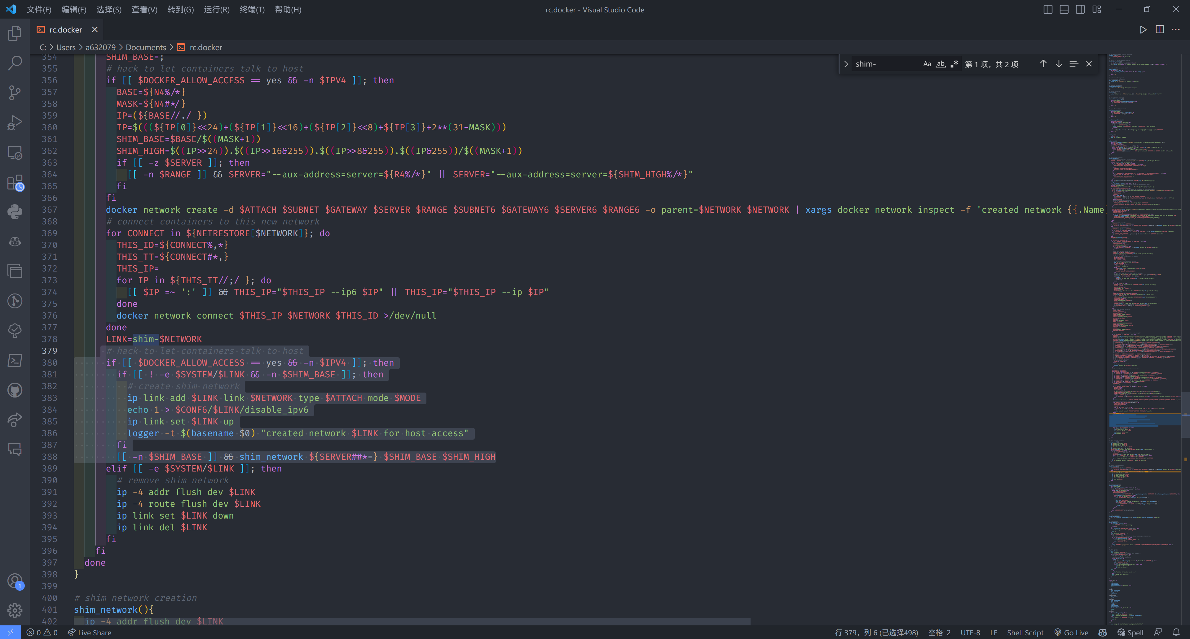

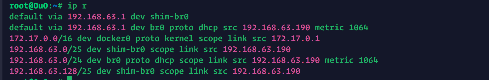

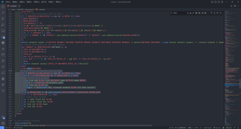

  6. I have figured out what lead to this issue. —— Enabled Host access to custom networks. --------------- It created a interface, called shim-br0, and do network configuration(configure route, etc) manually. But, Why? Why disable ipv6 is needed to in favor of this feature in unraid 6.12, however, it is not in 6.11? @JorgeB

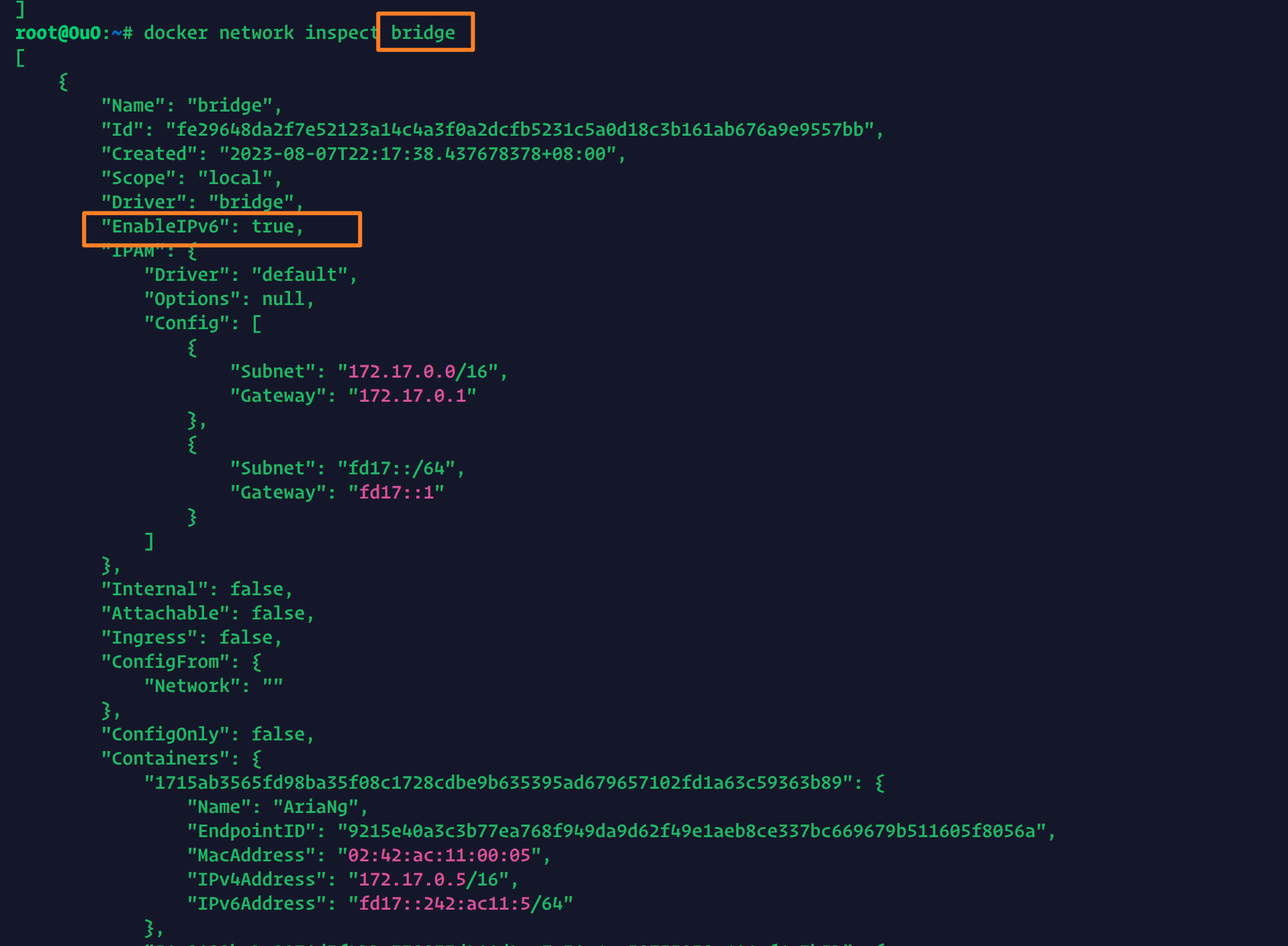

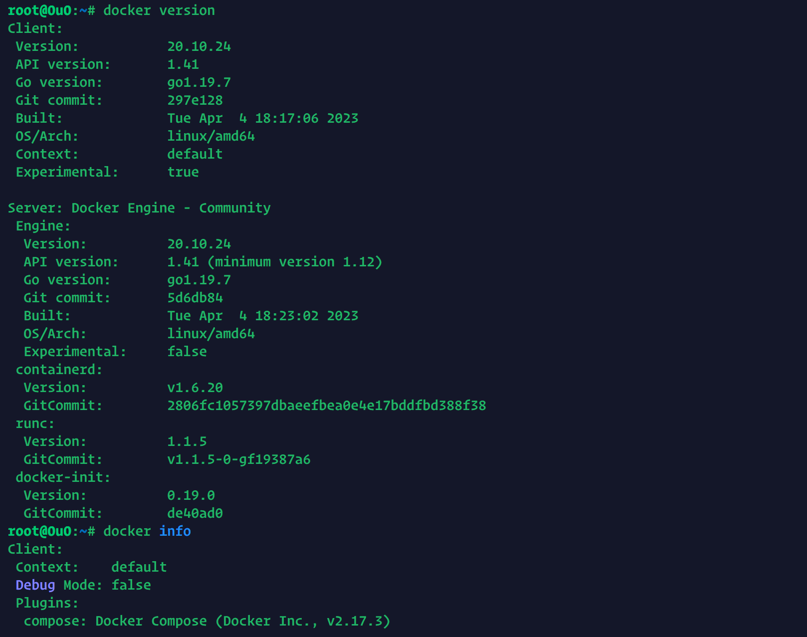

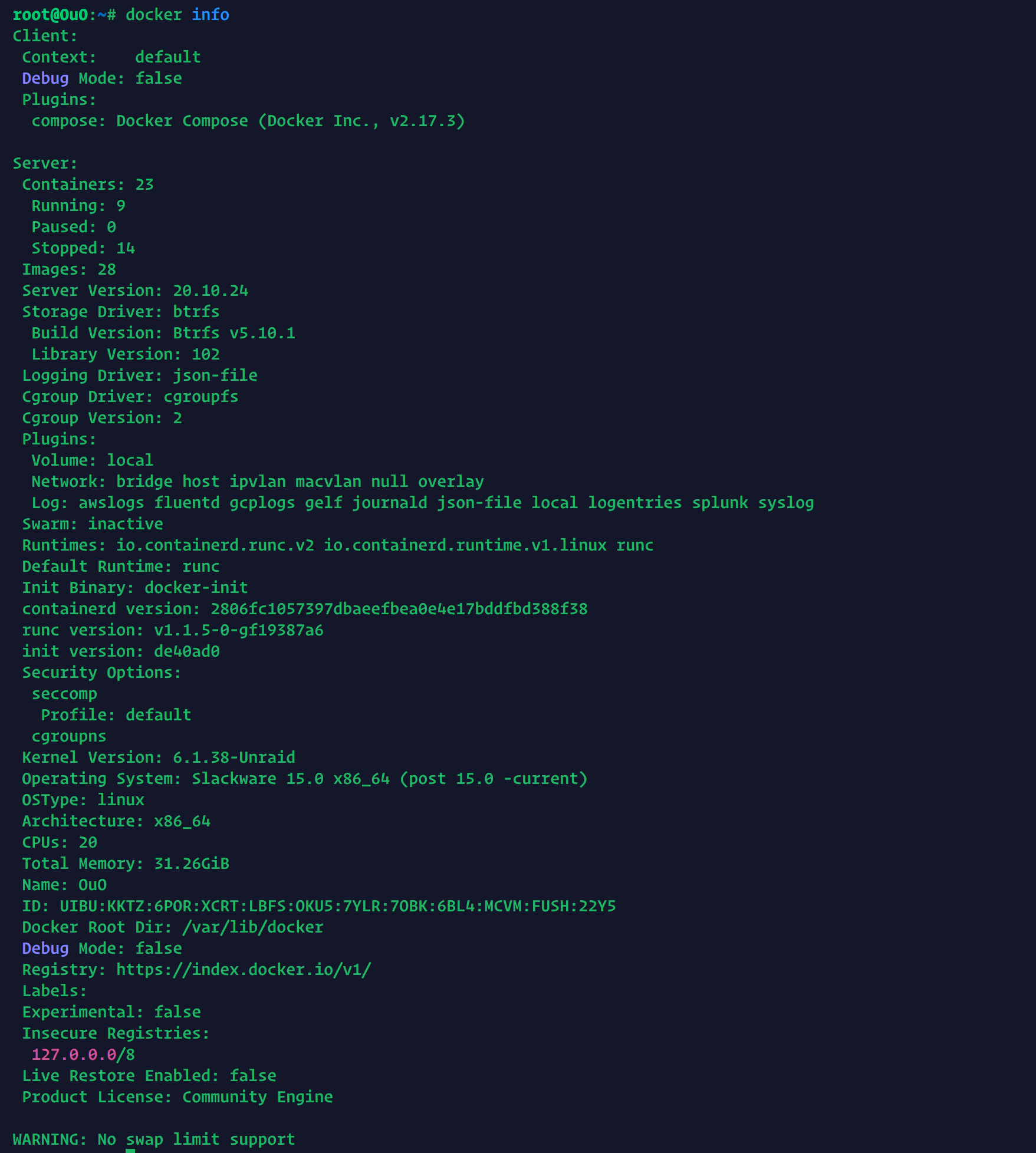

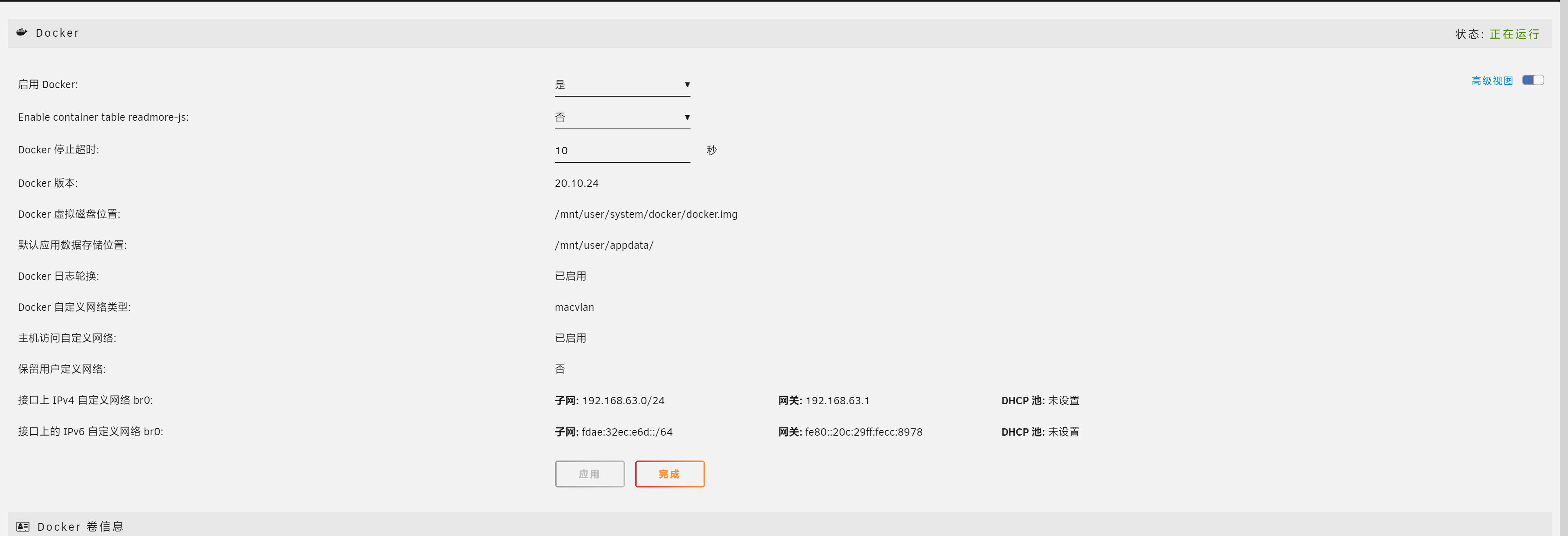

  8. You can see: Here, the enableIpv6 is false, while the bridge network is enabled. This is my unraid docker config. Output of ip a & ip r Output of docker version & docker info
