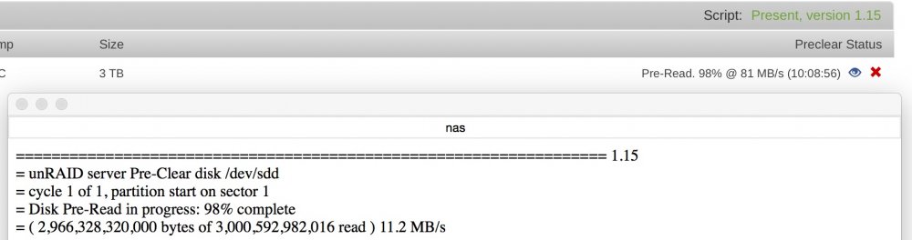

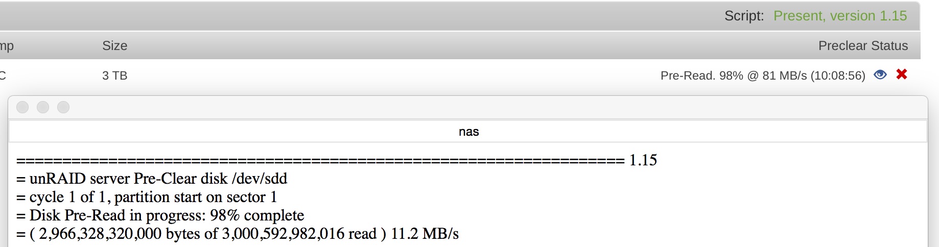

Preclear plugin
Oh, I see. So 81 MB/s is the average speed. Thank you very much for the quick reply.
Preclear plugin
Hey! Thanks for this plugin. I have a question about the read speed. As you can see in the screenshot the preclear status shows a read speed of 81MB/s but if I open the preview window by clicking on the eye icon it says the read speed is 11,2 MB/s I'm confused
How much RAM do you have installed in your unRAID server?
