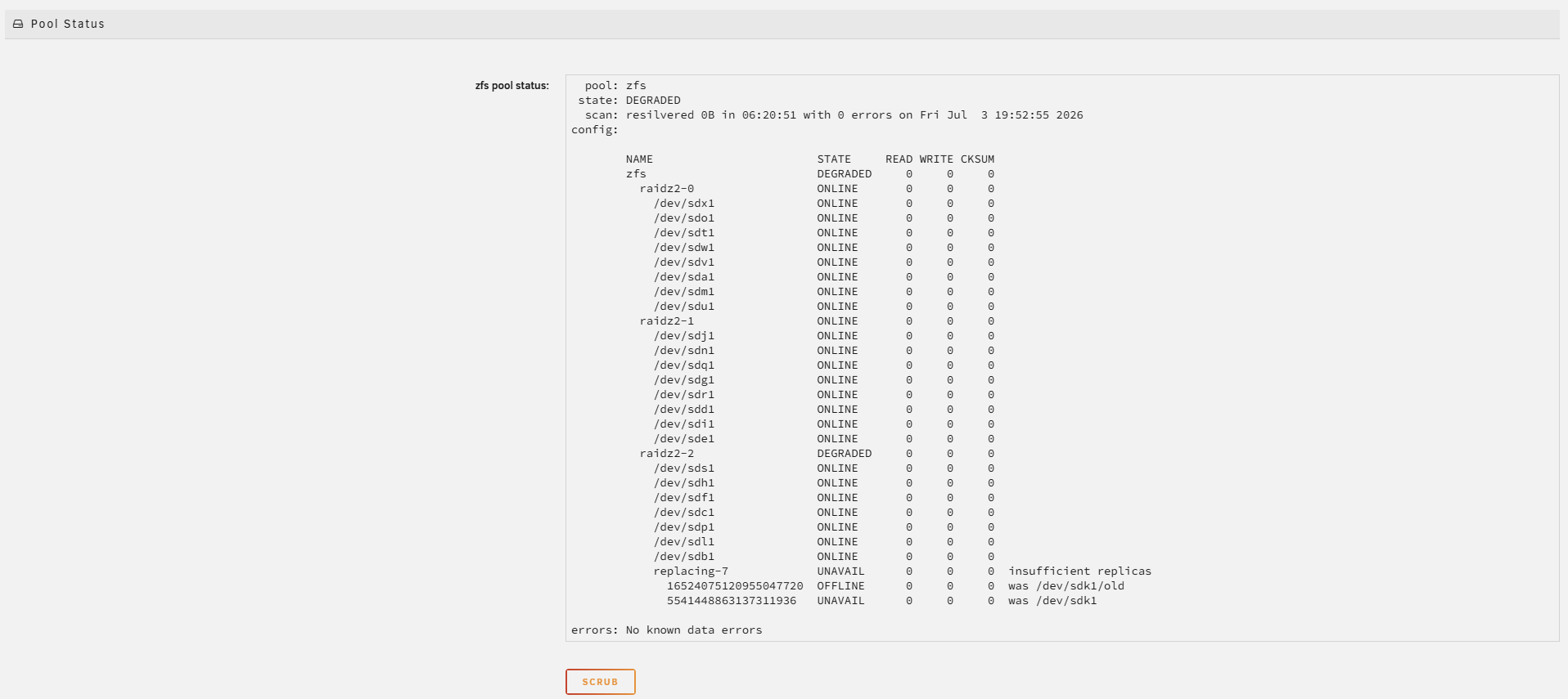

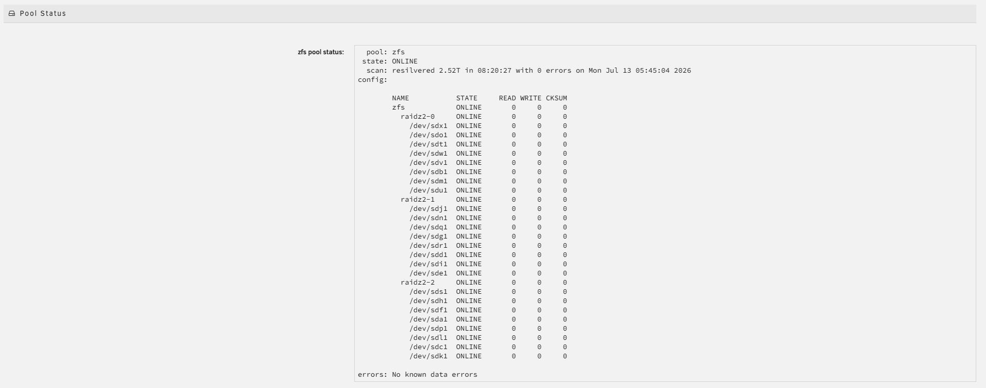

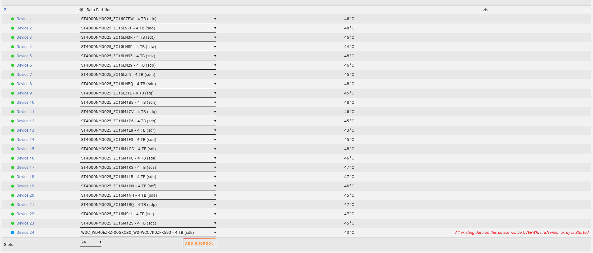

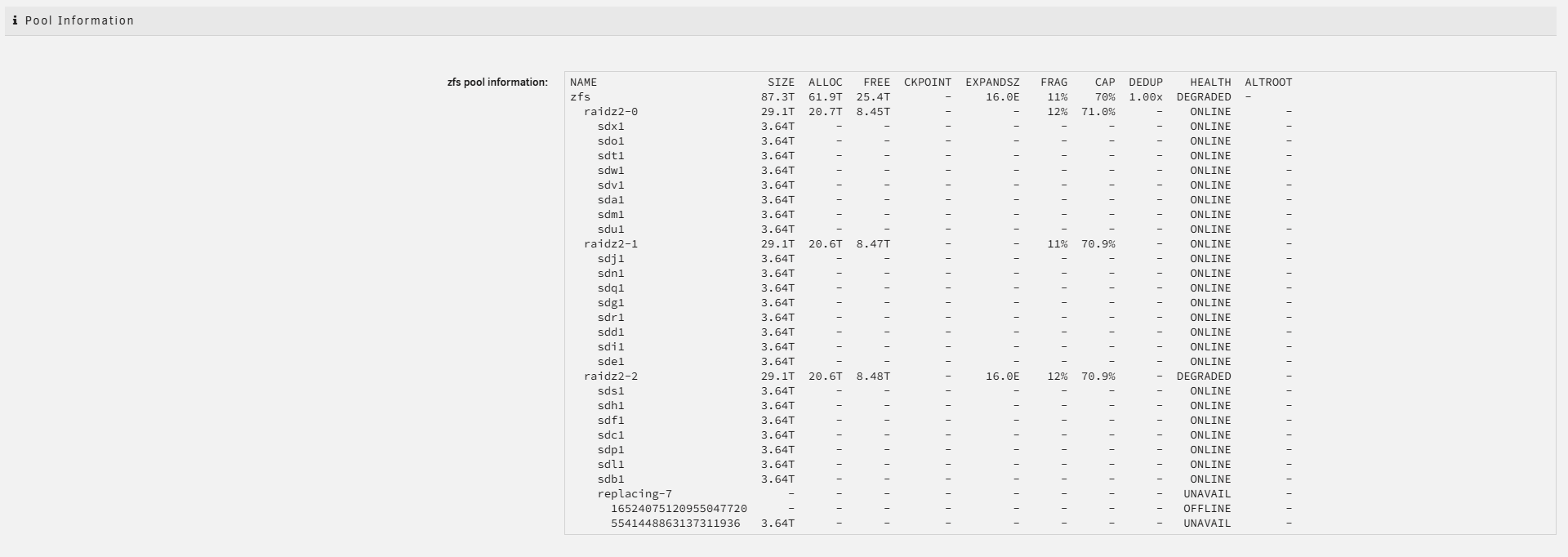

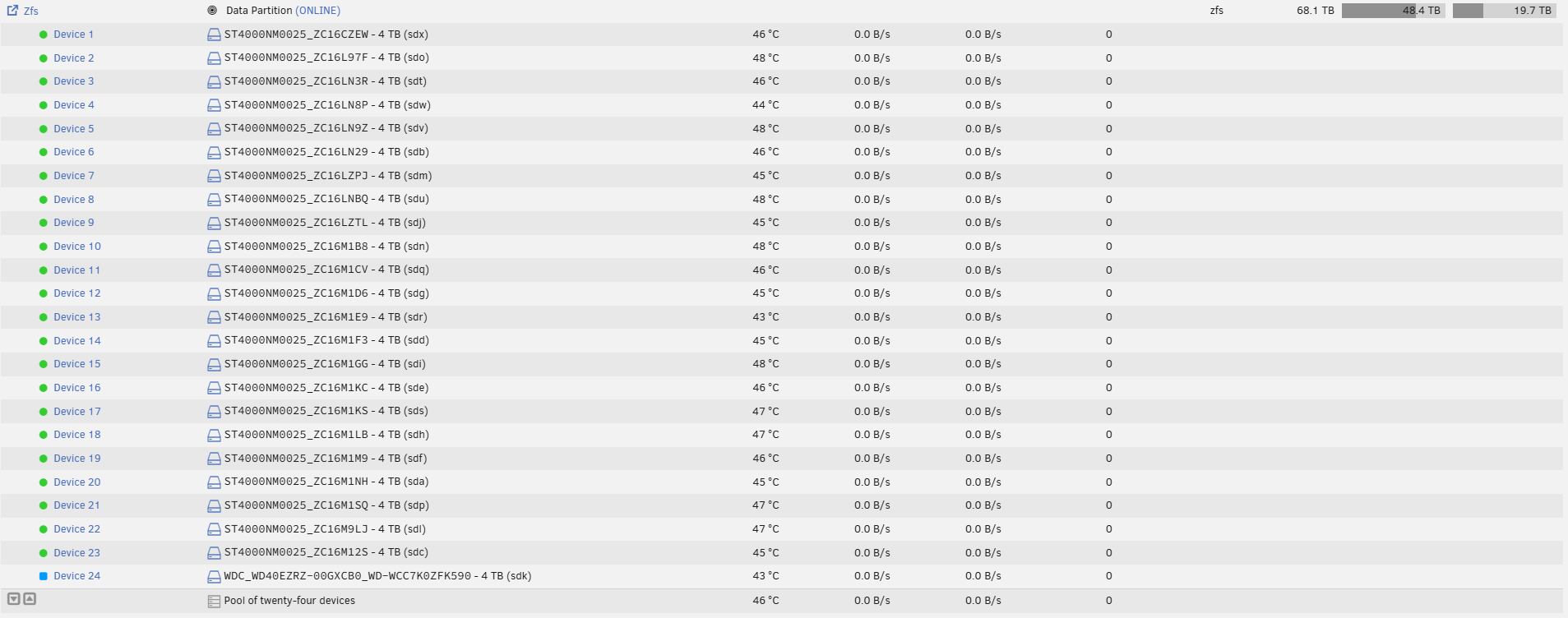

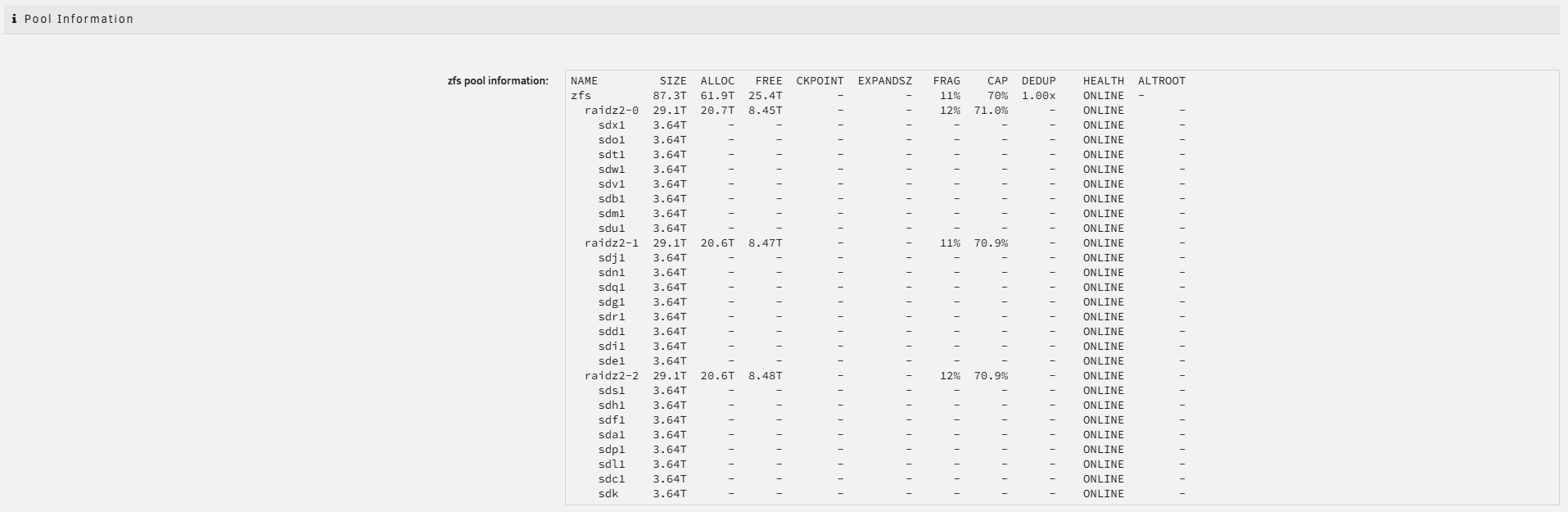

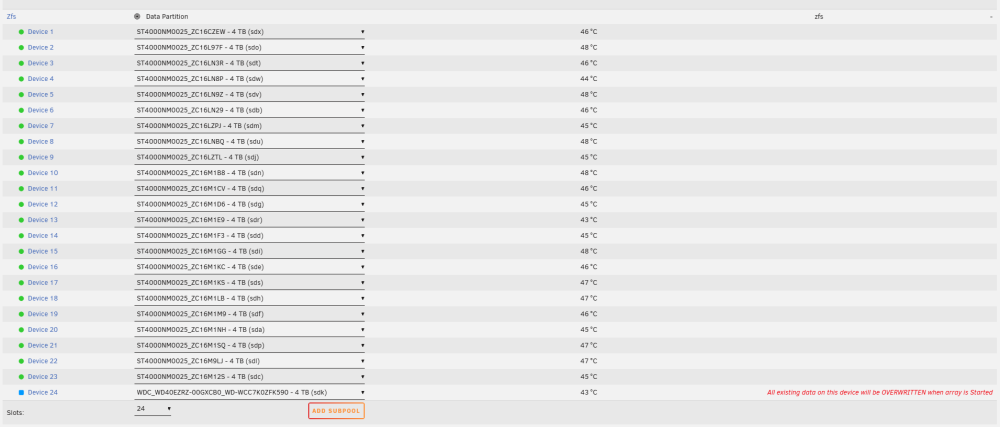

  1. One curious thing after the resilvering process was completed is that my replacement drive still shows up as "New Device" with a blue square rather than a green circle. I've rebooted the server and the array didn't start automatically as it said that the drive would be overwritten again when it started. I started it and it didn't overwrite and the zfs pool looks fine... Is this a bug?
  2. Yes, I actually fixed this last night by detaching the non-existent drives so as to replace the one that died. zpool clear zfs zpool detach zfs 5541448863137311936 zpool replace -f zfs 16524075120955047720 /dev/sdk

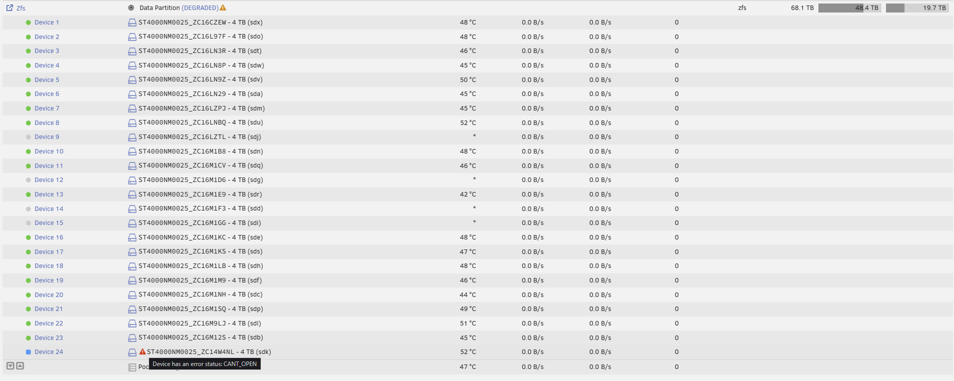

  3. I've run into a strange issue where one of my slots in my JBOD is unrecognizable in UNRAID and shows "Device has an error status: CANT_OPEN". I say one of the slots because I've tried swapping the drives around and it's always that slot. I installed Windows on my server on a spare drive in another slot and confirmed that the drives shows up and is read/writable (just created a simple volume and copied some files to it). What could be causing this? Jul 11 17:40:36 KRZ-UR kernel: sd 0:0:10:0: [sdk] 7814037168 512-byte logical blocks: (4.00 TB/3.64 TiB) Jul 11 17:40:36 KRZ-UR kernel: sd 0:0:10:0: [sdk] Write Protect is off Jul 11 17:40:36 KRZ-UR kernel: sd 0:0:10:0: [sdk] Mode Sense: d7 00 10 08 Jul 11 17:40:36 KRZ-UR kernel: sd 0:0:10:0: [sdk] Write cache: disabled, read cache: enabled, supports DPO and FUA Jul 11 17:40:36 KRZ-UR kernel: sd 0:0:10:0: [sdk] Preferred minimum I/O size 512 bytes Jul 11 17:40:36 KRZ-UR kernel: sdk: sdk1 Jul 11 17:40:36 KRZ-UR kernel: sd 0:0:10:0: [sdk] Attached SCSI disk Jul 11 17:42:46 KRZ-UR emhttpd: online: ST4000NM0025_ZC14W4NL_35000c5009500a0ef (sdk) 512 7814037168 => data partition: sdk1 type: gpt start: 2048 size: 3907016704 code: 0xee (8) Jul 11 17:42:48 KRZ-UR emhttpd: import 71 pool device: (sdk) ST4000NM0025_ZC14W4NL_35000c5009500a0ef Jul 11 17:42:48 KRZ-UR emhttpd: read SMART /dev/sdk Jul 11 17:45:56 KRZ-UR emhttpd: import 71 pool device: (sdk) ST4000NM0025_ZC14W4NL_35000c5009500a0ef Jul 11 17:46:01 KRZ-UR emhttpd: shcmd (120): /usr/sbin/zpool import -f -m -N -o autoexpand=on -d /dev/sdx1 -d /dev/sdo1 -d /dev/sdt1 -d /dev/sdw1 -d /dev/sdv1 -d /dev/sda1 -d /dev/sdm1 -d /dev/sdu1 -d /dev/sdj1 -d /dev/sdn1 -d /dev/sdq1 -d /dev/sdg1 -d /dev/sdr1 -d /dev/sdd1 -d /dev/sdi1 -d /dev/sde1 -d /dev/sds1 -d /dev/sdh1 -d /dev/sdf1 -d /dev/sdc1 -d /dev/sdp1 -d /dev/sdl1 -d /dev/sdb1 -d /dev/sdk1 1528848933852571142 zfs Jul 11 17:46:09 KRZ-UR emhttpd: 16524075120955047720 OFFLINE 0 0 0 was /dev/sdk1/old Jul 11 17:46:09 KRZ-UR emhttpd: 5541448863137311936 UNAVAIL 0 0 0 was /dev/sdk1 Jul 11 17:46:11 KRZ-UR emhttpd: writing GPT on device (sdk) with data partition offset 64 Jul 11 17:46:11 KRZ-UR emhttpd: shcmd (126): wipefs -af --lock /dev/sdk Jul 11 17:46:11 KRZ-UR root: /dev/sdk: 8 bytes were erased at offset 0x00000200 (gpt): 45 46 49 20 50 41 52 54 Jul 11 17:46:11 KRZ-UR root: /dev/sdk: 8 bytes were erased at offset 0x3a3817d5e00 (gpt): 45 46 49 20 50 41 52 54 Jul 11 17:46:11 KRZ-UR root: /dev/sdk: 2 bytes were erased at offset 0x000001fe (PMBR): 55 aa Jul 11 17:46:11 KRZ-UR emhttpd: shcmd (127): sgdisk -o -a 8 -n 1:32K:0 /dev/sdk Jul 11 17:46:11 KRZ-UR kernel: sdk: sdk1 Jul 11 17:46:12 KRZ-UR kernel: sdk: sdk1 Jul 11 17:46:12 KRZ-UR emhttpd: shcmd (128): partprobe /dev/sdk Jul 11 17:46:12 KRZ-UR kernel: sdk: sdk1 Jul 11 17:46:20 KRZ-UR emhttpd: shcmd (131): /sbin/wipefs -af --lock /dev/sdk1 Jul 11 17:46:20 KRZ-UR emhttpd: shcmd (132): /usr/sbin/zpool add -f zfs raidz2 /dev/sdk1 Jul 11 18:01:23 KRZ-UR emhttpd: spinning down /dev/sdk Jul 11 18:01:23 KRZ-UR SAS Assist v2024.11.25: Spinning down device /dev/sdk Jul 11 18:01:36 KRZ-UR emhttpd: read SMART /dev/sdk
