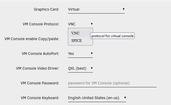

  10. namvan replied to bubbadk's topic in VM Engine (KVM)
    Hey @bubbadk You can try to edit the VM and switch between the option for Graphic Card: virtual and the iGPU. You would see that when selecting virtual, unRAID will automatically give you option for VNC or SPICE in VM Control Protocol. see the screenshot attached. The virtual option would allow you to control the VM within the web interface of unRAID. When you select the iGPU or eGPU if available, you are to connect your monitor to the output of the relevant iGPU or eGPU. That would not mean you can't remotely connect to you VM using VNC. You would just need to install it into your VM first. Hope this helps.
