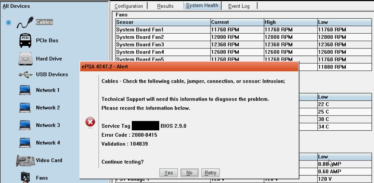

  1. My server has been running without issue for a very long time then one morning I noticed it was turned off. I turned it back on then noticed it kept shutting off after a few minutes. I logged into idrac and viewed the console and the server runs fine and gets to the part where it auto loads unraid then unraid does its thing. When about it get to the point where it shows the ip address and that it has started it shuts down always at that same point. I can confirm this only happens when loading unraid. I booted into lifestyle controller and the server stays on without issue and I ran a hardware diagnostics test and the only error I got was a fan sensor 4 warning event but within idrac all my fans are listed as working fine. I have not updated unraid or made any changes to it at all so this is very confusing why this would happen seemingly out of no where.

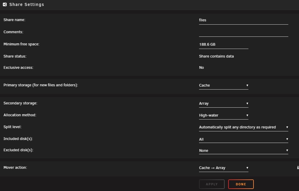

  2. So I used FTP to transfer a large file from my PC to the actual cache folder directly on Unraid and was able to get 10G speeds. However, when I map my Share folder called "files" on Windows and attempt to copy the same file from Windows to Unraid I get 1G speeds. It is like even though I set my "files" share to use cache for primary storage it is still writing to the array? I thought adding a ssd cache pool outside of the protected array would allow faster speeds, am I adding the network drive to windows incorrectly or is Unraid not using the cache pool like it is supposed to? I apologize if I am getting this wrong I have been reading forums & guides but still am not getting this to work correctly.

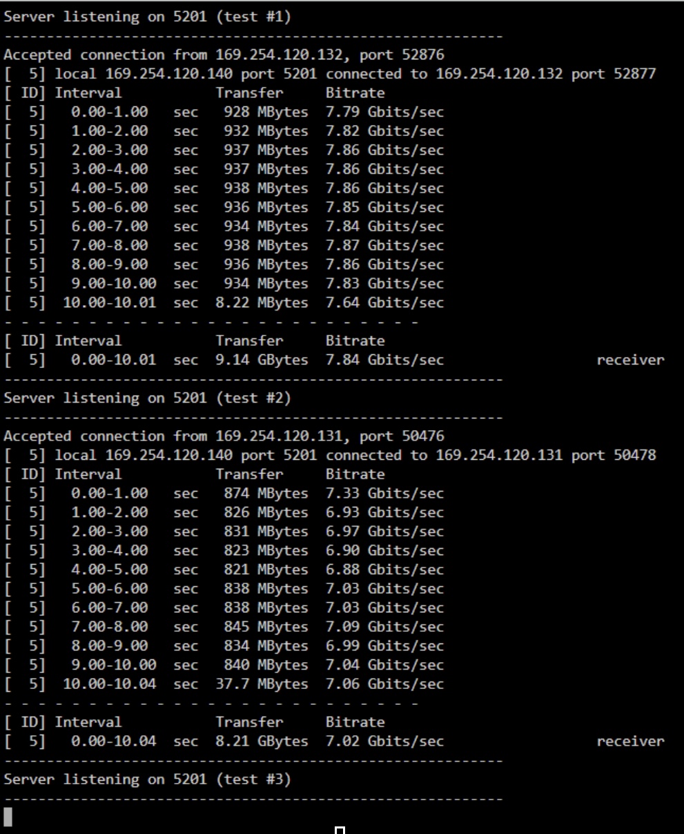

  3. Thank you for the reply, I do not have any binding set and I only have bridging set on my eth0 1G connection. I ran iperf3 again after getting my ip address/subnets sorted out properly and iperf3 is able to almost get 10G when going from PC -> Unraid and from Synology -> Unraid. Below is the iperf log, the top test was from pc to unraid and the bottom one was from synology to unraid. So it seems iperf can get almost 10G speeds but when it comes to actually copying files I can only get 1G speed which I don’t understand. I will attach diagnostics in a separate post. actual copy speeds from my pc to synology are 300+ megabytes a second whereas from pc to unraid are around 70-80 megabytes a second.

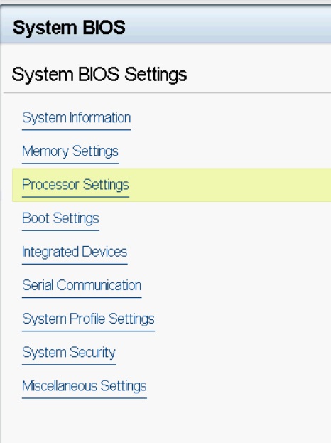

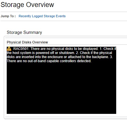

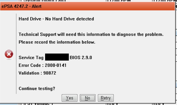

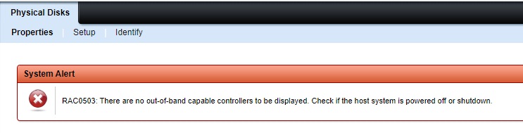

  9. Hey everyone! I purchased a Dell R720XD and 12 Segate Exos drives to add to my new server. I followed the Fohdeesha guide to flash my H310 controller and everything went without issue. I inserted my new drives but they are not showing on my server or unraid. When logging in with idrac and viewing my storage I am greeted with these errors attached. I also tried going into the bios to make sure AHCI is set but I do not have that option so I am kind of at a loss on what to do here. I would really appreciate any help I can get, thank you! When I run hardware diagnostics to see if the server even sees my drive I get this error:
