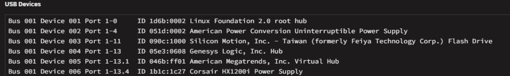

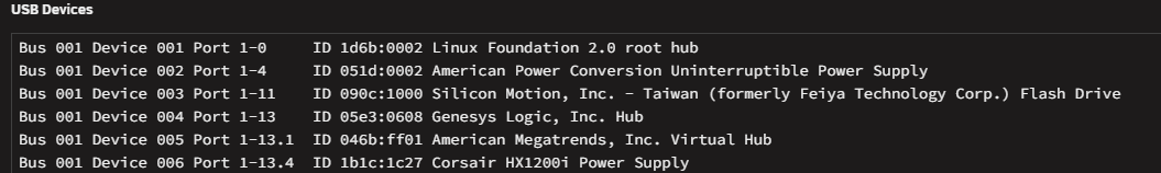

  2. Here is device ID for my PSU: Bus 001 Device 006 Port 1-13.4 ID 1b1c:1c27 Corsair HX1200i Power Supply
  3. Is there a way I can look into it more and see what might be causing this issue?
  4. I cannot get this plugin to show my PSU, I am using Corsair 1200HXi. It shows up under Tools/SysDevs, but on my dashboard nothing shows up. I also attached diagnostics. capsulecorp-diagnostics-20250915-1446.zip
