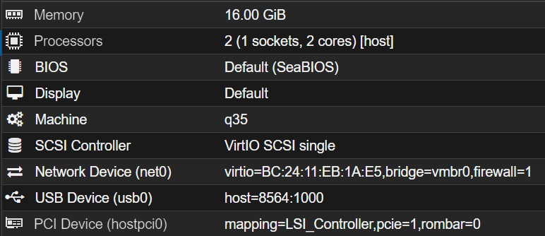

During the boot process, after the samba initialization (Starting Samba:) I have 3 messages that I do not understand: Starting mcelog daemon: /usr/sbin/mcelog --daemon chmod: cannot access '/dev/dri': No such file or directory logger: send message failed: Bad file descriptor The system seems to be working just fine but I would like to know what are those extra messages in the console (that slow down the boot process a few seconds). I'm using Proxmox v8.2, I'm not passing through any GPU or iGPU and these are my VM settings: Btw, regarding the instructions on how to boot from the Unraid pendrive, I'm just passing through the USB Vendor/Device ID and in the boot options I select the USB and it works like a charm. I'm using Proxmox 8.2 though. Maybe the usb boot is something that wasn't available before. edit: If I passthrough my Intel HD 4600 iGPU to the Unraid VM, the chmod: cannot access '/dev/dri': No such file or directory message goes away but the other two messages are still present. edit 2: I fixed those messages. The chmod: cannot access '/dev/dri': No such file or directory went away by simply deleting the Intel-GVT-g plugin, which I didn't even remember having (I haven't used Unraid in a while). The message logger: send message failed: Bad file descriptor I think went away when I disabled "Mirror syslog to flash", but I'm not sure. The remaining one, Starting mcelog daemon: /usr/sbin/mcelog --daemon, I still don't know what's about but I guess it's related to some plugin also.

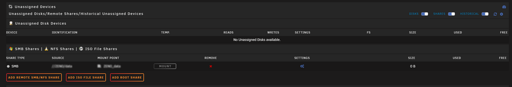

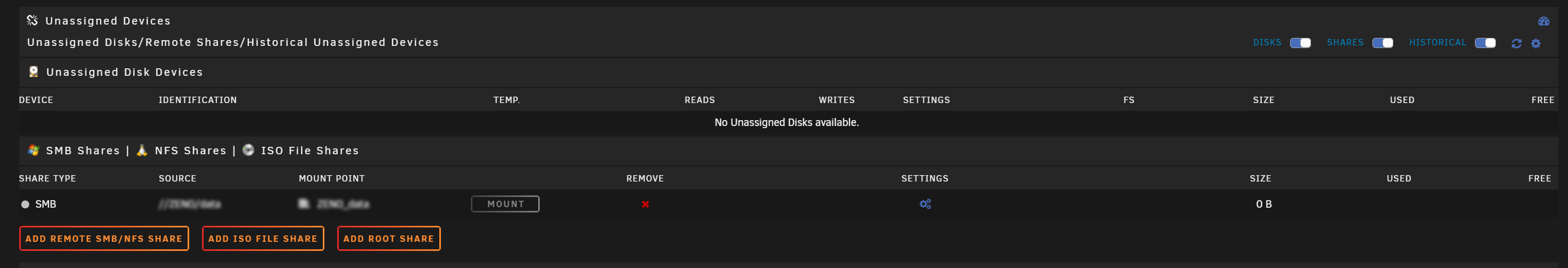

I've tried that but it did not do anything. Only removing it and adding it again works. Is there a log somewhere that might be showing some problems that I can share? I do not recall having this issue a while back (I'm still not using Unraid on a daily basis; I'm just experimenting with it to get comfortable when I move from my old Synology NAS). -------- Edit: I've just rebooted the UNRAID server and I found this in the system log: Oct 1 21:23:09 UNRAID unassigned.devices: Mounting Remote Share '//NameOfMyNAS/data'... Oct 1 21:23:10 UNRAID unassigned.devices: Remote Server 'NameOfMyNAS.LOCAL' is offline and remote share 'data' cannot be mounted. So apparently it's not able to find the share but it does find it when I re-add it. I don't get it. Btw, I have downloaded the ud_diagnostics zip and the only relevant thing that I could find are those lines from the syslog.
I'm having an issue with SMB shares. Every time I boot, my SMB share is not mounted and the button to mount is grayed out, as shown in this picture: If I delete the share and add it back, it works without any issues. But as soon as I reboot, I have to do it all over again. Is this a known issue? Or is an issue on my side?
