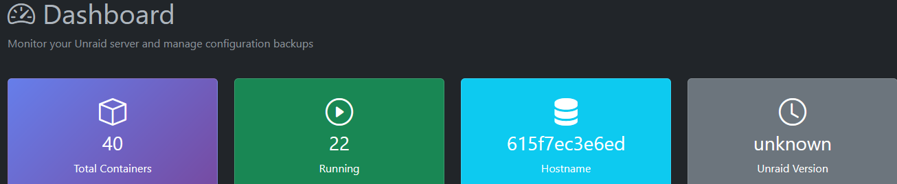

Hi, Backups are happening successfully again thanks to the latest changes though it still doesn't pick up the host name or Unraid version correctly since introducing the Docker socket security measure.

@stephondoestech As requested, I changed my /output to /mnt/user/appdata/UnraidConfigGuardian/ and did chmod 777 UnraidConfigGuardian/ after a reboot the backup completed successfully. I am still presented with a Random host name and unknown unraid version. Then I did recursive chmod 777 /mnt/disk2/veeam/unraid_config-guardian and changed the /output accordingly backup still fails to this destination. Each time I reboot to test new settings new random host name is generated.

I have followed the steps and its shows all my dockers in the webGUI but it doesn't pickup my hostname or unraid version. I get the following error doesn't doesn't matter where I set the output directory when I try to run a backup Last backup failed: [Errno 13] Permission denied: '/output/unraid-config.json' Before the above error is displayed on the webui the logs for the Unraid Config Guardian App show the following "POST /api/backup/start HTTP/1.1" 200 OK "GET /api/backup/status HTTP/1.1" 200 OKThe Unraid Config Guardian App can see the previous backups I Made. I Previously ran the App on my custom docket network, what networks are you running the app. This is the notices when starting the docker socket app,not sure if the matters [NOTICE] (1) : haproxy version is 3.2.4-98813a1 [WARNING] (1) : Exiting Master process... [WARNING] (12) : Proxy dockerfrontend stopped (cumulated conns: FE: 34, BE: 0). [WARNING] (12) : Proxy dockerbackend stopped (cumulated conns: FE: 0, BE: 1034). [WARNING] (12) : Proxy docker-events stopped (cumulated conns: FE: 0, BE: 0). [WARNING] (1) : Current worker (12) exited with code 0 (Exit) [WARNING] (1) : All workers exited. Exiting... (0) [NOTICE] (1) : Initializing new worker (11) [NOTICE] (11) : haproxy version is 3.2.4-98813a1 [WARNING] (11) : missing timeouts for backend 'docker-events'. | While not properly invalid, you will certainly encounter various problems | with such a configuration. To fix this, please ensure that all following | timeouts are set to a non-zero value: 'client', 'connect', 'server'. [NOTICE] (11) : config: Empty global server state file '/var/lib/haproxy/server-state'. [NOTICE] (1) : Loading success. The App completely breaks when trying try to add tailscale within the App as I did previously so I'm left that out with this version
