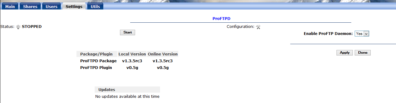

  2. OK. So I was able to resolve the access perms (to lock user to their home dir) I had to add the DefaultRoot ~ property to proftpd.conf to do that. So the only issue remaining is that my proFTPd config screen still shows the status as STOPPED even though the process is running and accepting FTP connections (see attached image)

  4. I hope this is the right place to post ProFTPD related questions. I downloaded the .plg file and set it up. Added a user (shrek) with description (ftpuser /mnt/disk1/FTP) Shows like this in /ets/passwds shrek:x:1000:100:ftpuser /mnt/disk1/FTP:/mnt/disk1/FTP:/bin/false 2 issues I'm facing: 1st Issue : On the ProFTP setting page : Status shows as STOPPED even though the service is running (I can login via FTP): Connected to 192.168.1.100. 220 ProFTPD 1.3.5rc3 Server (ProFTPD Default Installation) [192.168.1.100] 2nd Issue: If I login with that user : I'm still able to browse to a higher level (all the way up to root and anywhere I want). How do I restrict the user to that particular folder? Attaching my proftpd.conf file here proftpd.conf
