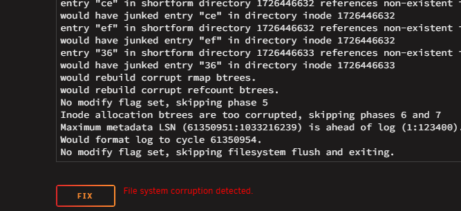

UFS Explorer has trouble exploring the drive to recover the files, the only thing left is file recovery which I did and there were... 0 files from the ones on the server. Is it possible this drive was just empty with folders? I certainly don't believe it was
[SOLVED] Drive failed during rebuild for a drive I upgraded

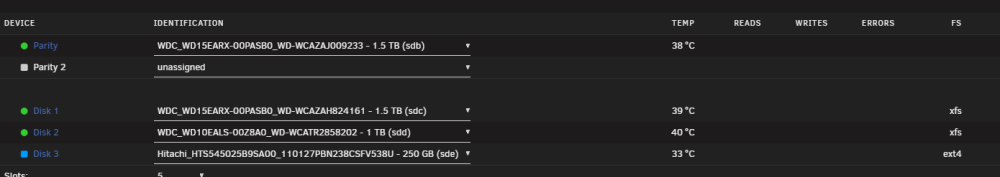

I can absolutely see how it happened - I interrupted the rebuild to the larger 1.5TB disk and that probably left xfs in a confused state. I'll use UFS Explorer to transfer the data to another disk and reformat the 250GB one.
I just looked at the screenshot again - it seems like the disk is 232.89GB and the partition is 232.9? If I have to rebuild into another disk, I'm ready with a replacement drive (it's an SSD and I know that's not perfect but im working with what I have)
