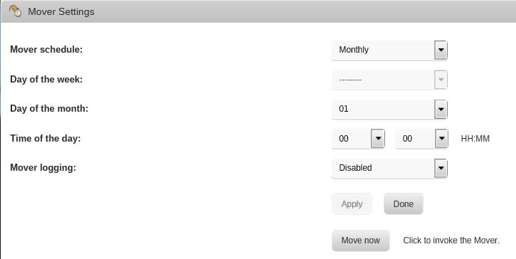

Here I am. I updated the diagnostics in the post of this morning. Can't see anything of use. Attached to this post the first cache_dirs_diagnostics together with a screen shot of the cache_dirs GUI. I'm not sure if the log generated with -L is showing the running plugin or the instance that is pulling the log data!? Therefore I attached the ps and pstree output. cache_dirs -q says it it not running. This means, the GUI is not lying. I fired up the modified version as planned. ./cache_dirs -i Video -e Audio -e Backup -e Fotos -e Spiele -l on The second file show the logs right after the script start. The GUI is also showing the plugin status "running". The defunct.sh is also running. I think I managed to remove the mover & logger spamming the log. The mover settings had logging enabled. # Generated mover schedule: 0 0 1 * * /usr/local/sbin/mover |& logger Once it is set to disabled the file \flash\config\plugins\dynamix\mover.cron contains # Generated mover schedule: 0 0 1 * * /usr/local/sbin/mover &> /dev/null It seems there is no switch to fully disable the mover. cache_dirs_diagnostics.zip cache_dirs_diagnostics_arberg_mod_28.09.2018_2252.zip
