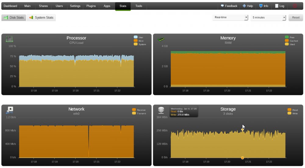

I'm just fiddling around with a N54L Microserver (which ich a nice peace of hardware - by the way). I have 2x4TB drives for testing. Parity set up and all green so far. No cache drive. I just copied ~300GB to the array with ~105 megabytes/s. <---- this is the first thing that seems strange to me, although not related to the Dynamix plugins. I'm used to 40-50MB/s when writing straight to the array. The second thing I'm wondering about is attached as screenshot. Peak writes ~270 MB/s.? (average @~200MB/s.?) If necessary I can post the diagnostics as well.
