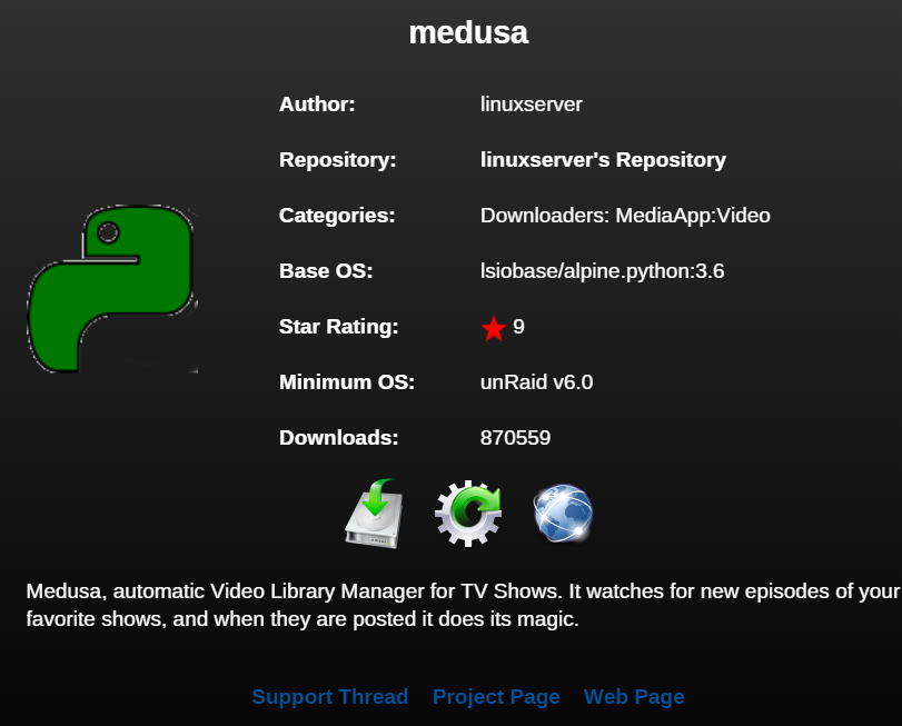

  24. Thanks! Is there a way to know what release number I last installed? binhex uses the app's version number which would make it easier to figure out.
  25. Not seeing it.
