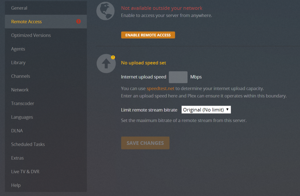

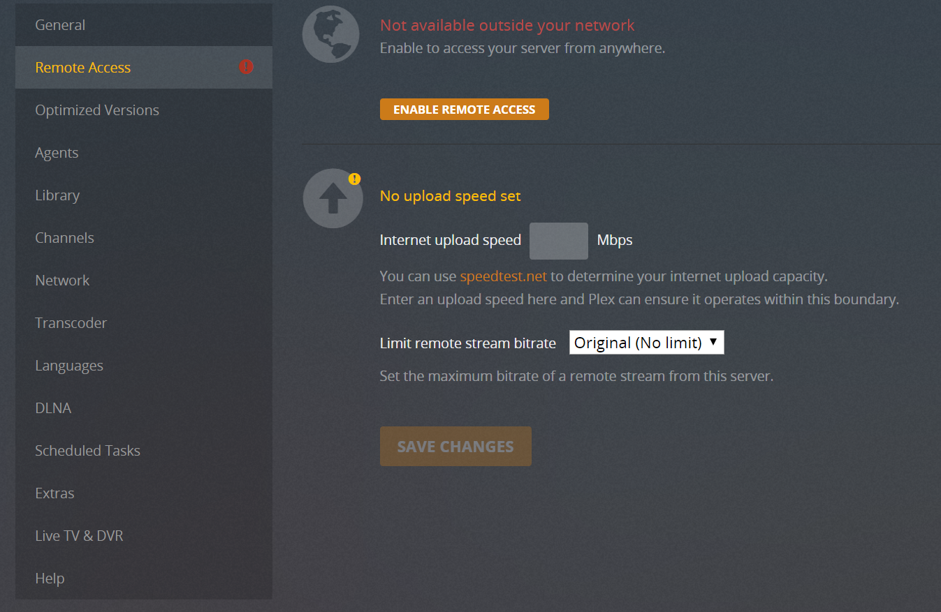

[Support] Linuxserver.io - Plex Media Server
On the Plex server configuration, you can select whether to enable or disable remote access. Is that not sufficient?
