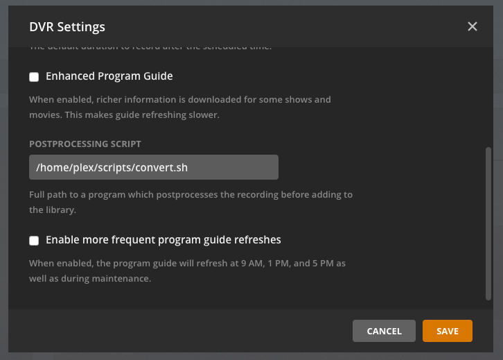

  13. The script that runs would be created by the user and can just be dropped into a volume mapping. The user would create their own script and most likely just need to path to to the ffmpeg program. In plex you just add the path to the script to run. Below is the screenshot, and an example of what I am currently using as my script on a full blown machine, which does some other stuff too, but I would be happy to just get the conversion working in the docker. #!/bin/bash # ------------------------------------------------------------------ # Author [Kevin Fowlks] # # Date 10/06/2016 # # Plex DVR Handbrake convert script for shrinking my recordings from my HDHomeRun CableCard. # # Usage: ./convert.sh <input file> sleep $[ ( $RANDOM % 45 ) + 1 ]s NOW=$(date +"%m%d%Y") #PGMNAME=/usr/bin/HandBrakeCLI PGMNAME=/usr/bin/ffmpeg check_errs() { # Function. Parameter 1 is the return code # Para. 2 is text to display on failure. if [ "${1}" -ne "0" ]; then echo "ERROR # ${1} : ${2}" # as a bonus, make our script exit with the right error code. exit ${1} fi } BASEPATH=$(dirname "$1") BASEFILE=$(basename "$1") FILENAME="${BASEFILE%%.*}" #Check to see if postprocess script is running. If so tell process to wait. This is to ensure we don't have more than 1 convert process running at a time. Keeps CPU happy. while [ -f /tmp/postProcessLock ] do sleep 60 done touch /tmp/postProcessLock echo "Starting $NOW" echo "Starting Processing of $1" | mail -s "Plex Post Processing Started" [email protected] #set audio to English /usr/bin/mkvpropedit "$1" --edit track:a1 --set language=eng --edit track:v1 --set language=eng sleep 5 #remove commercials comchap "$1" #comcut "$1" sleep 30 #Original Handbrake #$PGMNAME -i "$1" -Z "AppleTV 2" -o "$BASEPATH/$FILENAME.mp4" #ffmpeg $PGMNAME -i "$1" -vf scale=-1:720 -c:v libx264 -crf 18 -preset fast -c:a copy "$BASEPATH/$FILENAME.mp4" #$PGMNAME -i "$1" -c:v libx264 "$BASEPATH/$FILENAME.mp4" #new Handbrake #$PGMNAME -i "$1" -f mp4 --aencoder copy -e x264 --x264-preset medium --x264-profile auto -q 16 --width 1280 --height 720 --decomb bob -o "$BASEPATH/$FILENAME.mp4" check_errs $? "Failed to convert file $1" sleep 20 echo "Removing original file." rm -f "$1" sleep 10 rm /tmp/postProcessLock sleep 10 echo "Completed Processing of $1" | mail -s "Plex Post Processing Completed" [email protected] check_errs $? "Failed to remove original file $1"
  14. Is there any way to add handbrake or ffmpeg into this docker to do some file conversions in the DVR post processing script feature of plexpass version?
