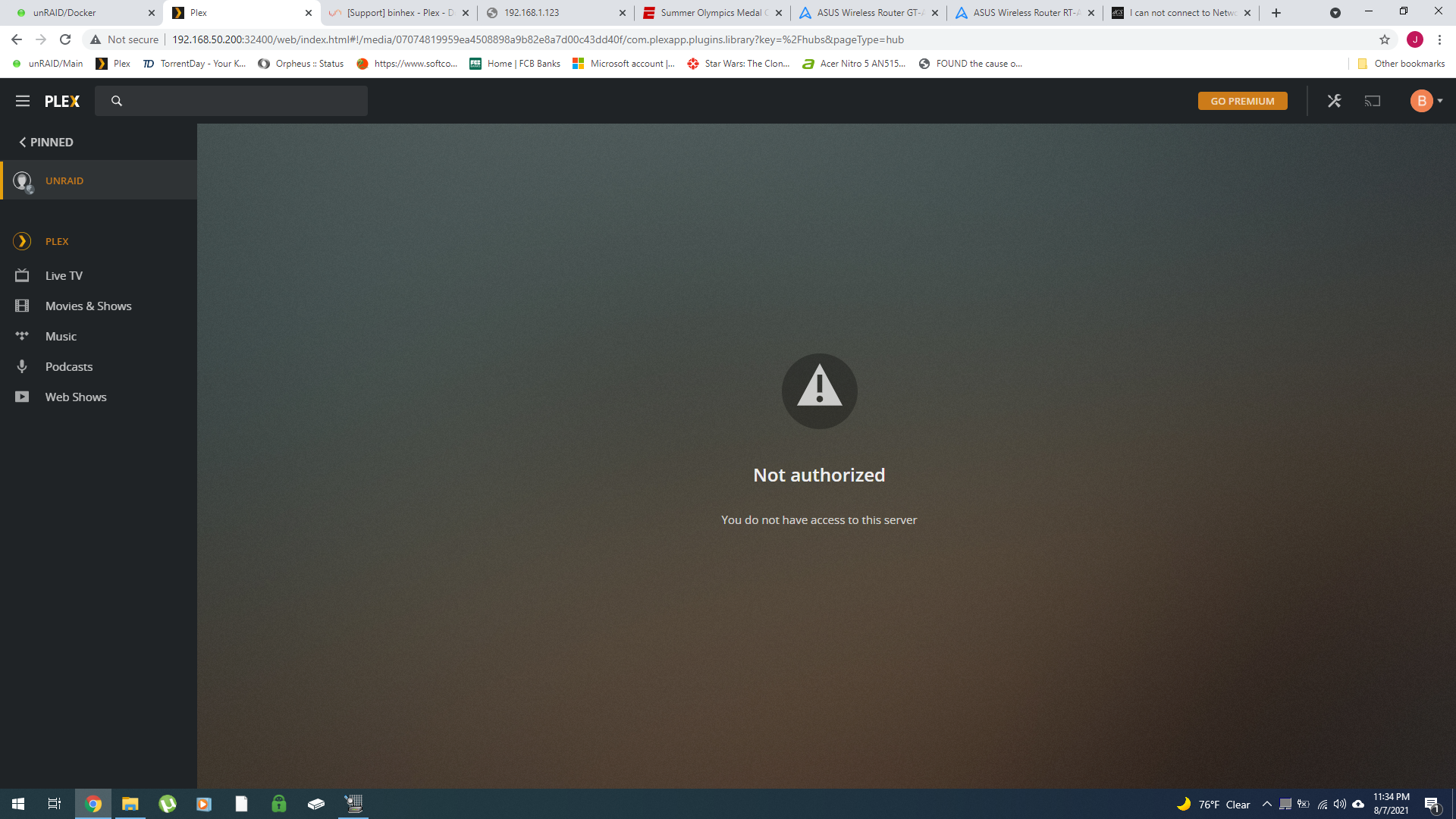

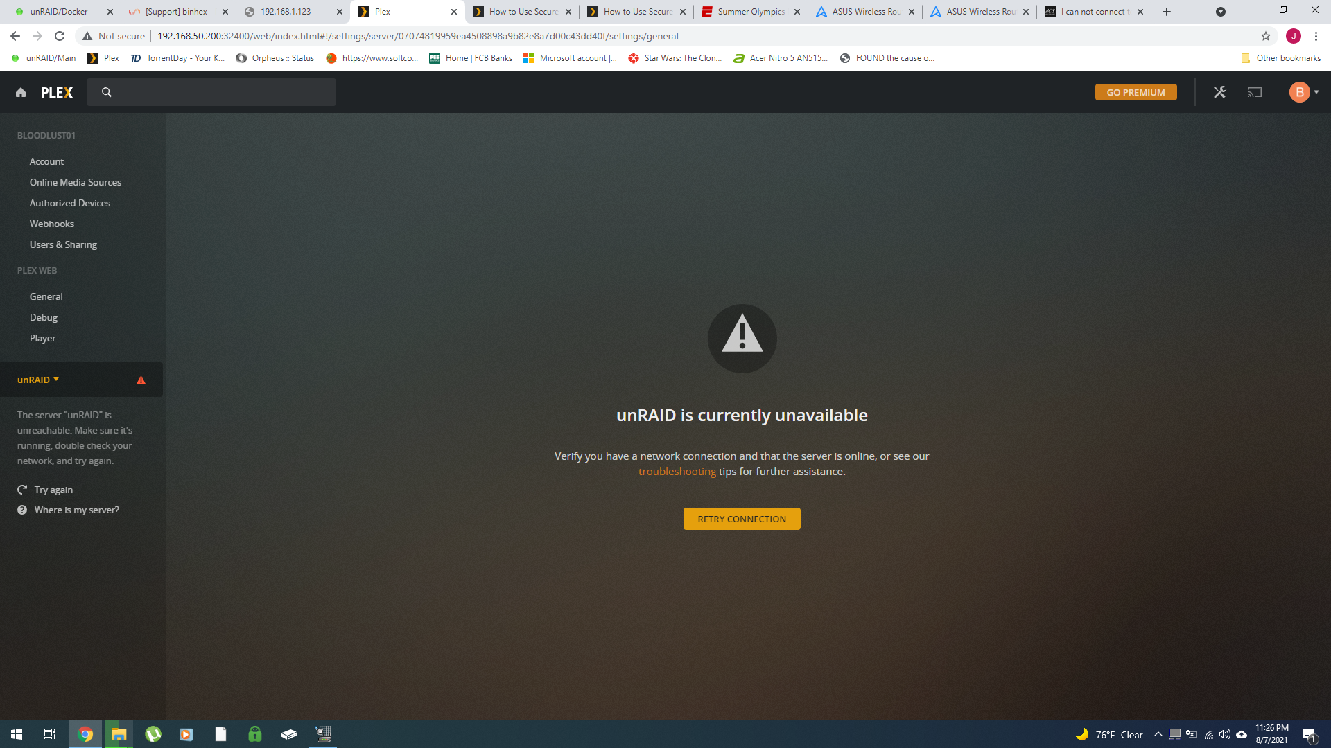

I recently moved and my current house is no longer hard wired with ethernet ports. I needed to move my unRaid server into a separate office in the house in an area that the hard line for the internet does not come into. I had an older ASUS RT-AC68U that I decided to setup in bridge mode and connect to my server to see if it would work, VERY novice network guy here. It seems to work great after hooking it up to the bridge mode router, Speeds seem great. Anyways here are my questions. 1.) I'm having issues with accessing my Plex server now. If I go into the docker and pull up the webgui it will say either that i'm not authorized to access the server or unRaid is currently unavailable. Now, I can access the server just fine from my laptop and I can send/receive files without issue from my unRaid server. So I know the server is working just fine on that end regarding filesharing. Any suggestions on this? Should I delete and re-install the plex docker? 2.) I don't know much about networking or router setup. I followed the ASUS instructions when setting up the router in bridge mode. Is there any special settings that should or should not be enabled since doing this? One thing I did notice is that even though the server is working, I don't see it or the bridged router on the connected device list of my main router (ASUS AX11000). I was thinking maybe the IP is causing conflicts but unsure how to even find the IP or what would even need to be changed to get plex working again. Any suggestions on this? Thanks for the help.

I'm having some issues that I can't seem to figure out. Long story short, I recently moved and the place on where my WIFI router is can't support my unRaid server. With that being said I had to move the server into a different room down the hallway which does NOT have hardwired ethernet access. To remedy this problem or the hopes off I purchased another router to try and setup as bridge and connect my unRaid server to it. I'm using a ASUS GT-AX11000 as my actual WIFI home router and setup a ASUS RT-AC68U as a bridge and connected it to the 2nd 5Ghz channel as a dedicated. I really don't know anything about networking however after watching a few videos I believe I have it setup and working. The RT-AC68U and the unRaid server are positioned in another room down the hallway and it seems the unRaid server is connected to the network as I can transfer and receive files off the unRaid server without issue. Speeds are excellent and seems good. However, I no longer can access Plex on the unRaid server. I can access the unRaid webgui and when I try to get into the Plex webgui I get the messages shown in the attached pictures. I will either get that I'm not authorized to access the server or it says the server is unreachable. I'm not sure what's going on here, Does anyone have any suggestions??

Thanks for the help, All is good.

Sweet! I'm up and running now, Thank you! In regards to your share question, I have no idea. Back when a guy helped set this up for me 6 or 7 years ago that's the way it was setup. I don't mess with anything as I'm afraid of screwing something up, I'm sure my server is not setup as it should be. I have 11 disk drives on it, And adding one or replacing one is something I at least know how to do without worry regarding data loss. You say mine is setup with disk shares, What is the advantage to "user" shares? I don't have any other reason why it's setup with disk shares. I know that when I fill a drive, I add another one and just create a "movies" folder in the new drive and start saving to it. I'm assuming with "user" shares, You can just setup 1 folder and it will take into account all the drives available to it?
