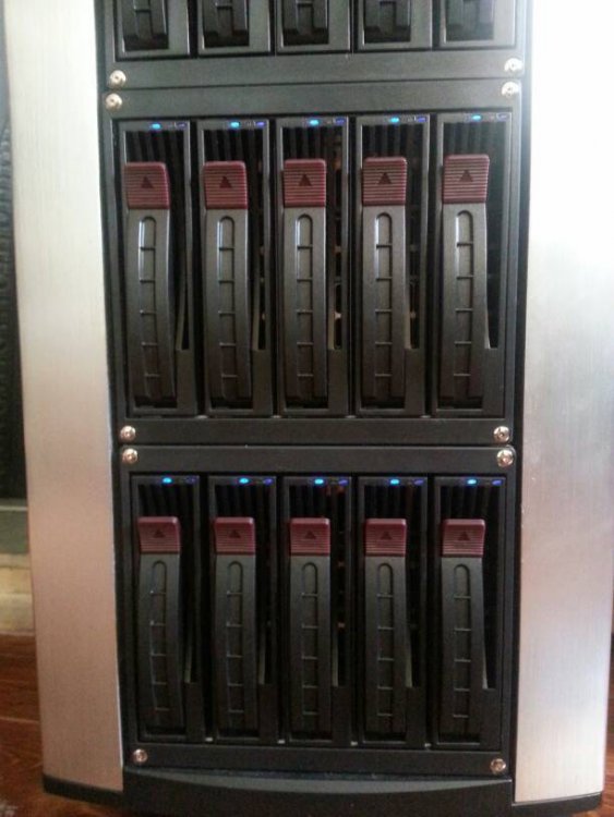

Well, it looks like I did install them correctly, pics attached. Sent from my GT-I9300 using Tapatalk

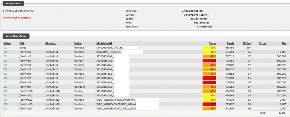

So you were running at around 40C with the stock fans? As I wrote here I'm seeing drive temps in 35-37C during parity calculation with the SilenX Effizio. So the difference must be in the drives and/or the case. I'm mostly running Samsung Spinpoints which are pretty cool and I do have multiple 120mm fans blowing air out of the back of the case. I wouldn't recommend going over 45C. I am running mostly Seagate drives, four Norcos at the front, two 120 mm fans at the back in a coolermaster stacker case. The only thing I can think could mess the airflow is the big round grill on one side of the case. I can try to block that and see if it improves airflow. Sent from my GT-I9300 using Tapatalk

The fans label is visible from the back of the cage is that the right way? I have two 120mm fans at the back of the cage. Room temp is 20C. Sent from my GT-I9300 using Tapatalk

So I bought the SilenX Effizio from Germany (not sold in the UK) and now the server runs, about 10 degrees hotter than before. The fans are much quieter than the stock ones, and they do get noisier as parity calculates, so I guess the Thermistor does work (they didn't spin for a few minutes until temperature was higher than the minimum level) I have setup parity and let it go on for an hour, temperatures reported are in the pic below I don't like to see red, and I do wonder if 50 is above what I can accept... Shall I send them back or can I live with 50 C?

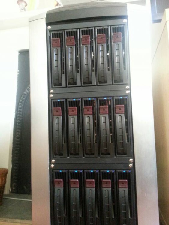

I have a CMStacker 810, how many of the RC-BPN-350V2-SS will I be able to run in the case? At the moment I am using all 12x 5.25” drive bays (4x 4in3 modules). Will the 5x3.5" actually fit the case?
