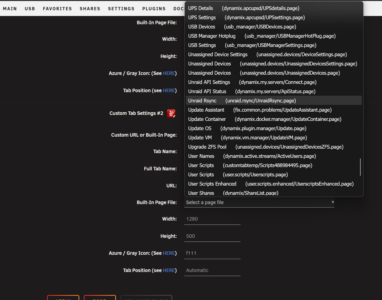

  2. Thanks again for posting this. I've been using it very successfully since you added the omit times flags. This has now fully replaced my previous rclone/user script solution. I did have a quick question - and this may be a long shot / not in your wheelhouse. No worries either way. A popular plugin, custom tab, allows users to make a custom tab out of anything and add it to Unraid's nav bar. Usually this plays well with other installed plugins via the Built-In page dropdown. It looks like there's an entry there, but when I configure it I just get a blank Unraid page. I'm not sure if the custom tab plugin has robust documentation about what it's looking for as I've never run into this issue with an Unraid plugin. As a workaround I have it configured to use the plugin url (https://nas.effoff.dev/Settings/UnraidRsync) but that has several drawbacks. That URL is serviced by my reverse proxy so if that's down it won't work, or if I connect to my Unraid box using its IP or the actual machine name then I have to re-login to use the link. Again, thanks for your efforts so far and no worries if this isn't something that can be fixed/isn't something you want to take on.

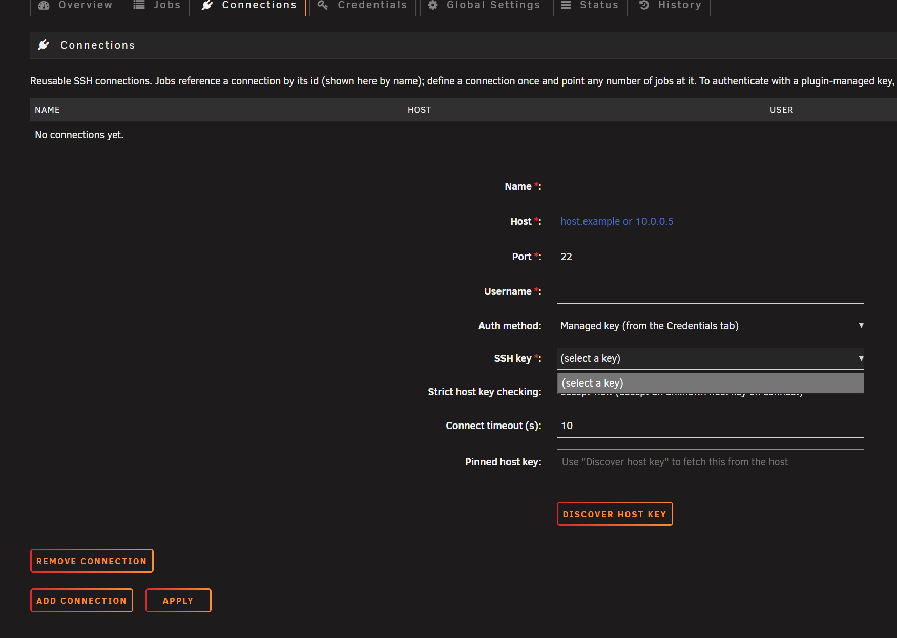

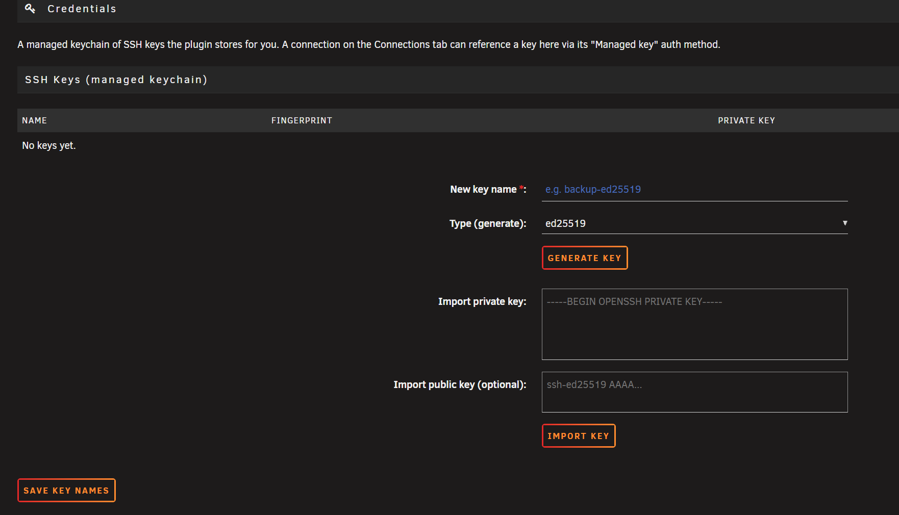

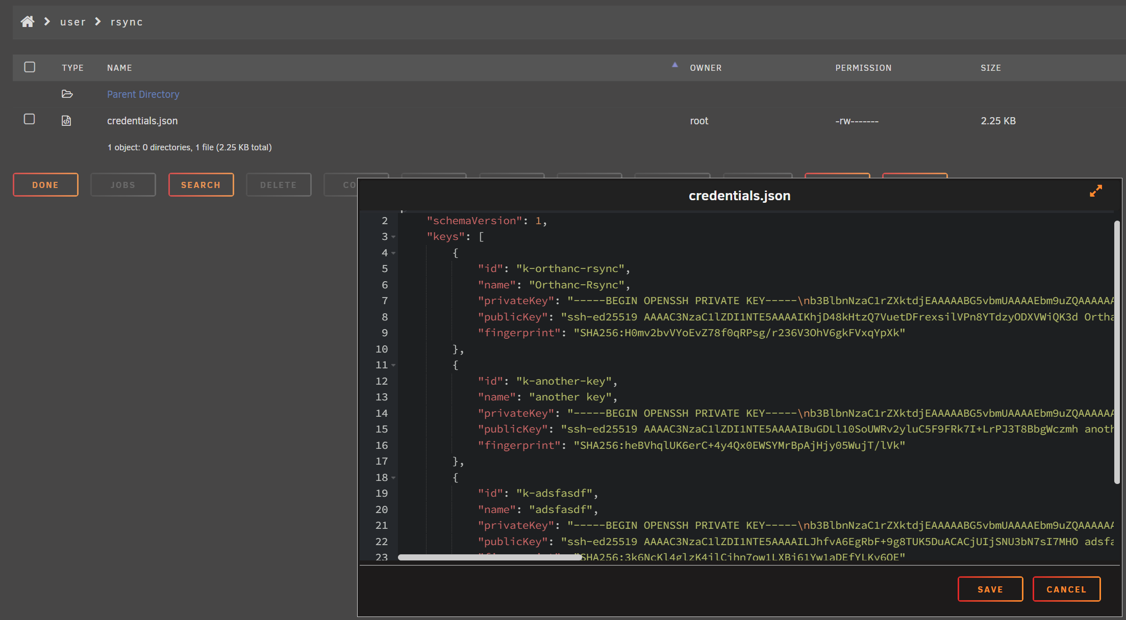

  3. Thanks for putting this out there! I love the UI but I'm running into two issues: My distant filesystem doesn't support setting the time attribute on directories, but -O (--omit-dir-times) isn't surfaced in the webui as a global or job specific flag. Would it be possible to add it? When I set a custom secret directory the plugin creates a cred json file, creates and stores new creds there, but stops showing them in the credential manager / stops allowing me to select them on connections: Setting: New creds get created successfully: Unavailable in Cred manager tab or new connections:
