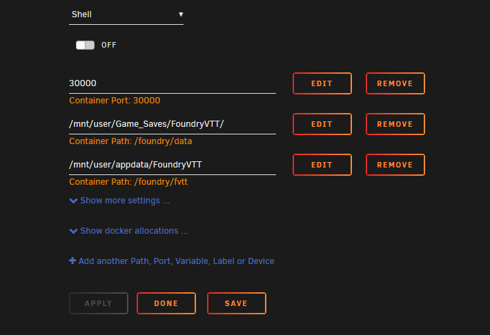

this is the docker setup that i use for foundry and it has been working well. 1553318819_FoundryDockerSettings.png.e9f8d86b73214f88f9fa61e08bb750b9.png
i have not run into the error that you are having so im not sure what you can do i would try to reinstall the docker and see if that helps..
Thanks for responding.  What is the path to the files you copied from FoundryVTT?
The way i have things set up is that the appdata folder is all of the files from the foundry zip file and the settings/userdata is in my game saves share.
the foundry zip file should have everything in it and the configs should be created automatically upon docker start. at least thats the way that i have the template setup
