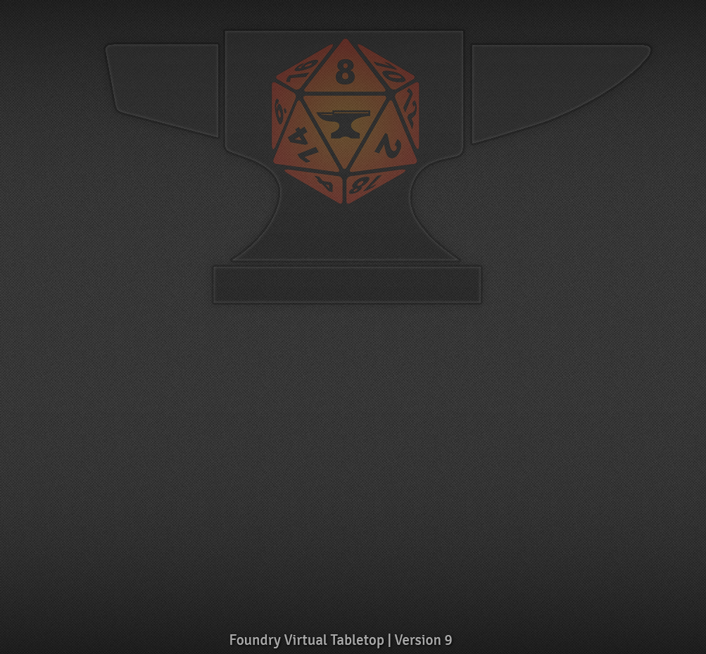

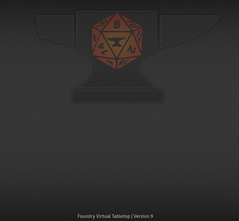

Hi there I am having a weird issue with Foundryvtt docker.
I tried settign it up using a reverse proxy with swag.
I can even connect to the Server but am stuck on the default screen then.
It works fine with a using the direct port and duckdns so I am very confused.
I have attached my foundry swag config and the options config from the foundry server.
Thank you so much for your help and all the work you put into these projects.
options.json foundryvtt.subdomain.conf
your site seems to load just fine. in an older post i put up my working proxy config for swag you could have a look at that and see the difference with yours
