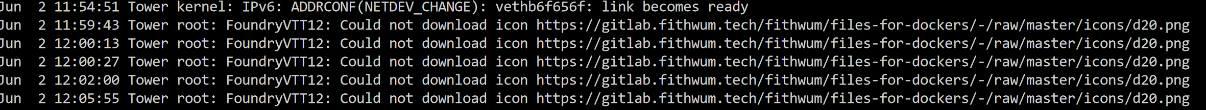

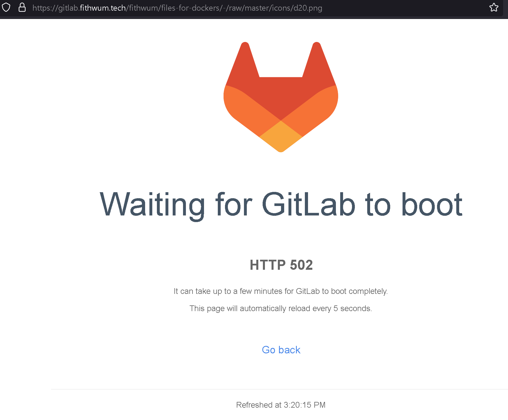

Hey @fithwum, love the container. I was deploying another instance today and noticed that the logo is requested from a gitlab that is currently unreachable.
It looks like you maintain your icon repo over on github as well so I just updated the container config to reference that.
Not sure if this is the result of an intentional migration or what-have-you, just though I'd bring it to your attention.
Edited by d3fc0n0wltraps
yes i do use my own gitlab because github is sometimes a problem for uploading files mostly large files. my gitlab got stuck in a bootloop after the last update but is fixed now
