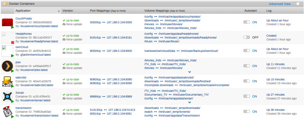

  4. I put my mapping back to how it was 3 days ago (matches the recommendations above unless I'm still overlooking something). I still get no imports, also now my "activity" section in Sonarr is blank. I only get this error: Error during RSS Sync: Root element is missing. To confirm my mapping: App Name Container Volume Host Volume Transm. /config /mnt/cache/appdata/Transmission/ /downloads /mnt/user/_temp/downloads/ sonarr /config /mnt/cache/appdata/sonarr/ /downloads /mnt/user/_temp/downloads/
  5. Still no luck. I am still getting this error: 17-4-28 19:51:09.3|Error|DownloadedEpisodesImportService|Import failed, path does not exist or is not accessible by Sonarr: /downloads/finished/The.Island.With.Bear.Grylls.S04E01.720p.HDTV.x264-QPEL 17-4-28 19:51:09.3|Error|DownloadedEpisodesImportService|Import failed, path does not exist or is not accessible by Sonarr: /downloads/finished/Tiny.House.Hunters.S04E15.Freedom.in.Going.Tiny.720p.WEBRip.h.264-TOPKEK In Sonarr, I AM able to see all Activity of things that have been grabbed and progress during download. I test the connection with Transmission and it is good. Download path for transmission docker is: /mnt/user/_temp/downloads/ - Inside of transmission app download is to: /downloads/finished/ Download path for sonarr docker is: /mnt/user/_temp/downloads/finished/ * If I change this path to match transmission (/mnt/user/_temp/downloads/), I get NO import and NO errors The files are for sure downloading to "_temp/downloads/finished" folder (verify in windows explorer). I'm wondering now if I have a permissions issue. I've clicked around in multiple places and tried changing somethings (then changing back) but no dice so far. Any ideas?
  6. I found the problem started from last Wednesday. That's the same day I upgraded to 6.3.3. I did find tonight that somehow the download path got changed on Sonarr and it was looking in the wrong directory. I fixed that but I'm still having issues. I get the following log(s) for every file in my download directory: [Error] DownloadedEpisodesImportService: Import failed, path does not exist or is not accessible by Sonarr: /downloads/finished/Frontline.S2017E08.Last.Days.Of.Solitary.720p.WEBRiP.H.264-TOPKEK The access mode is set to "read/write" inside of the Sonarr docker so I'm a bit lost. Thanks for your help.

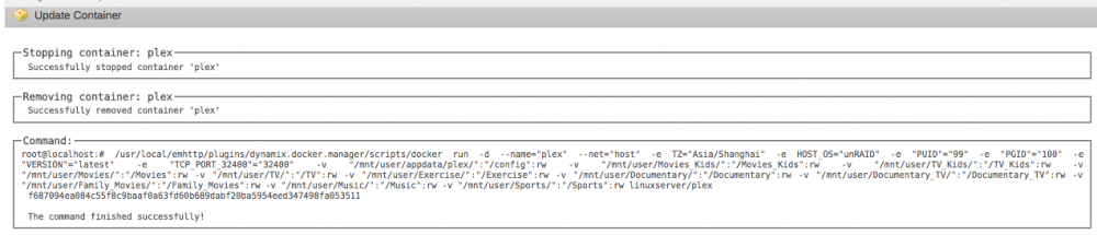

  9. My port mappings are blank like that for Plex.... maybe something to do with the network set to Host. Why not take a look in the Plex Docker log to see what's up? Well I let it run for 33 minutes and I just get the below. Seems its still trying to update. Bed time for me. I'll check in the AM. Any other advice, please share!
  10. Upon update of container, I get this message. I can't see the problem.

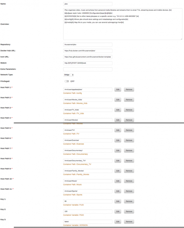

  11. I was looking at the same thing. I mapped a host port but need to do something else?
  12. Thanks. Just read through it again and then switched back to net=host. Still not working. Wondering if I have something wrong with the PUID or PGID values. I didn't change those and not really sure how to check what I should put in there. I see that its the only docker without port mapping applied.
  13. I see my mistake of 3400 instead of 32400 above! Trying that now!
  14. Set Network Type to Host Tried. Got same result. All other dockers are "Bridge"... I set as "Bridge" and setup a host port (32400). Still not working though... Can you confirm what you have for the webUI?
  15. Hey guys. Just upgraded unraid to 6.2 and forced the update on Plex docker. Its not working now. I noticed that the Port Mappings Section is blank on just that 1 docker. I went into settings and started to tinker. Stupid me didn't take a screenshot of the settings before playing... Here are my current settings. Suggestions?
