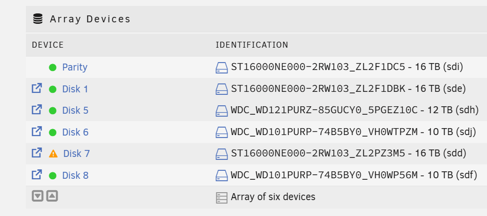

  5. I am now data rebuilding onto that new drive (16tb) and the old drive i will remove and inspect and afterwards - run a preclear and fully zero it to make sure its ok - then re-add it to a pool - or use it for something else... I have now set up a monthly scrub too Once the drive is all rebuilt, and thats all done I will be re-checking all cables being tidy and organised along the way In fact once its all done - i will come back and ask how i can re jig this so its neater (attached) I unbalanced and removed old 4tbs ages ago and bought a few 16s - so i have basically gaps Disk 2 Disk 3 Disk 4 etc i wanna rejig it so i dont have gaps is it just a case of stopping array and making new config? but with the checkbox to Preserve current assignments: ?

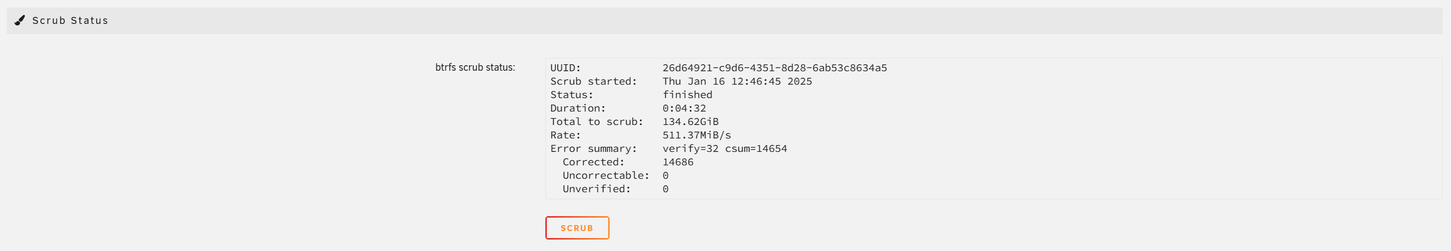

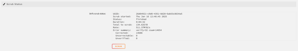

  6. ok, so those sdb1 (sdb1 and sdc1) are my cachepool Originally i had "Cache" then i created a new one called "Newcache" and got rid of old one - a while ago now See attached Screenshot of Scrub
  7. ahh the resets are because my server became unresponsive when copying some files over network a few times, so power cycled it... again i think this is to do with controllers etc will turn it on and do a scrub
