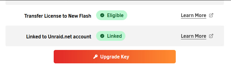

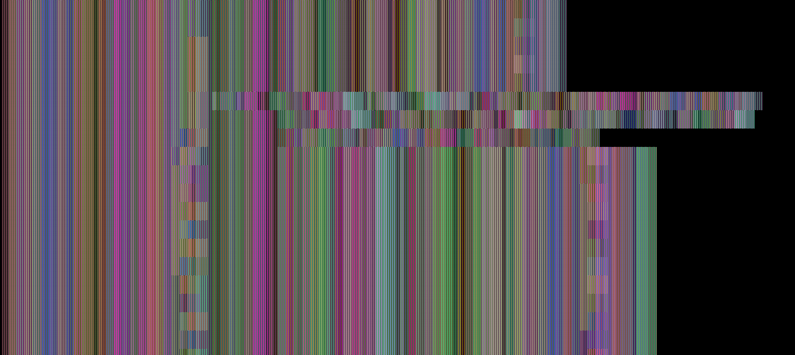

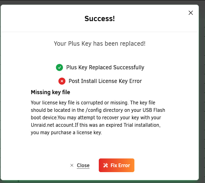

  2. I tried to upgrade my OS to 7.0 today and after upgrading, my dockers won't start and getting errors about bad parameters. Comparing the errors in the logs to help requests in the forum indicates that I may have a failing flash drive. So far running the USB creator on the new drive and copying the config directory and booting the system, I was able to reach the Success message. Since it says the Plus Key was replaced Successfully and I wasn't sure about the key error, I clicked on the Close button instead of the Fix Error. Now when I check the Registration, I see this "Transfer License to a New Flash: Eligible" message . Other than the link going to Learn More, I don't have any clue if there is an error somewhere that still needs to be fixed. The array is started and doing parity check and the dockers and VMs are running. But when I try to check the logs or open a terminal, I get a screen like this: Thank you for any advise.
