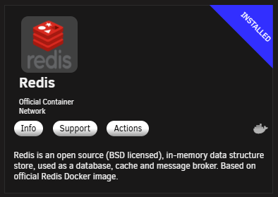

  1. I deleted it and installed this one instead which works for my use with Paperless NGX because I can leave the P-NGX option to use a passwordless connection to Redis.

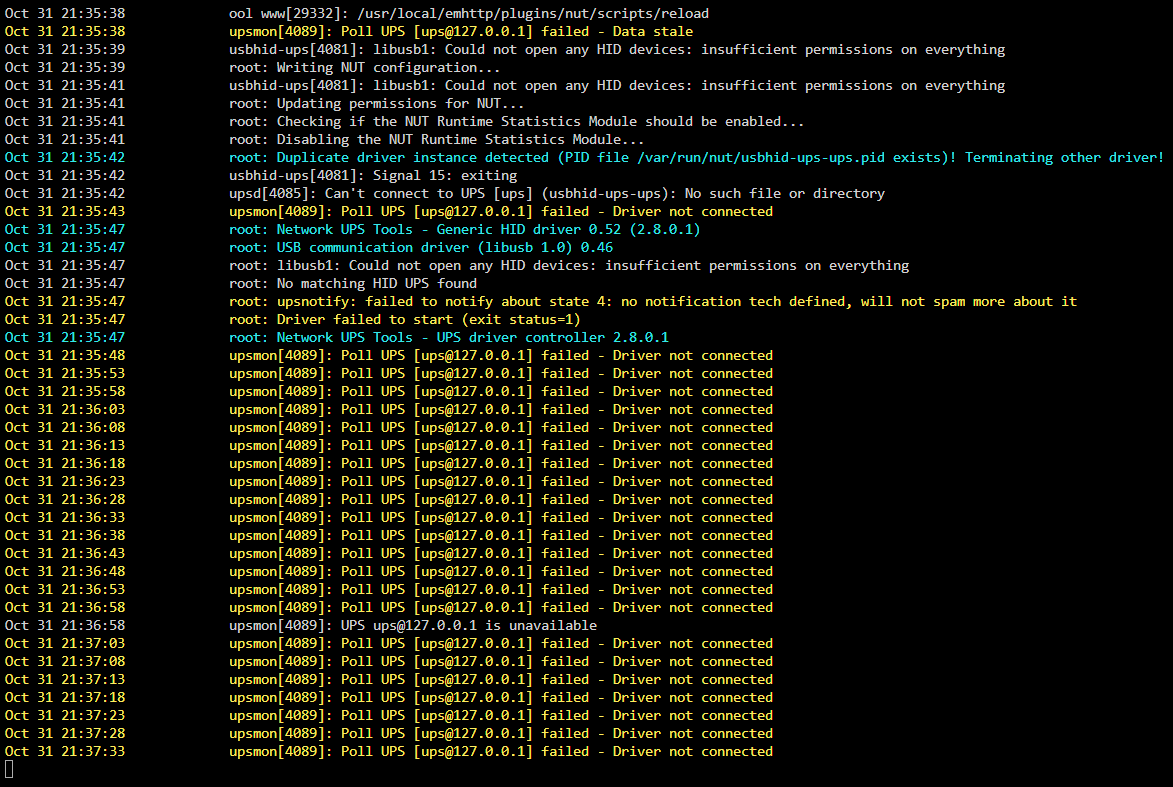

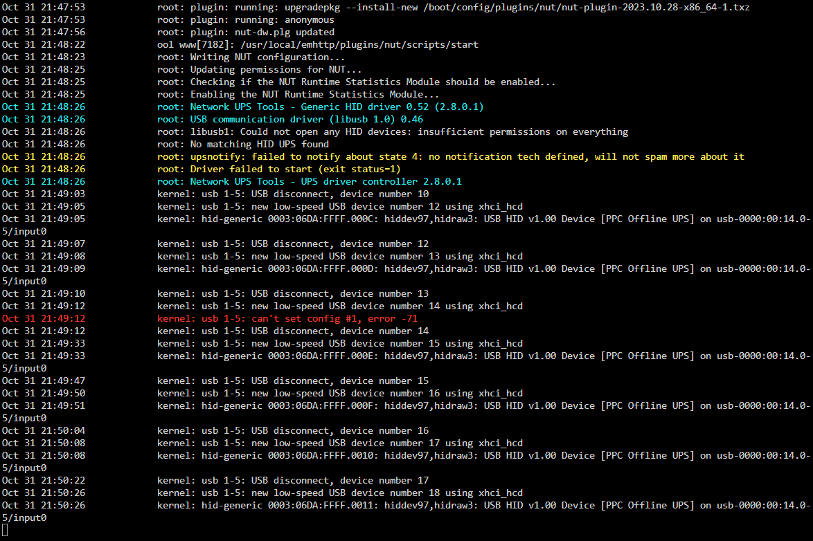

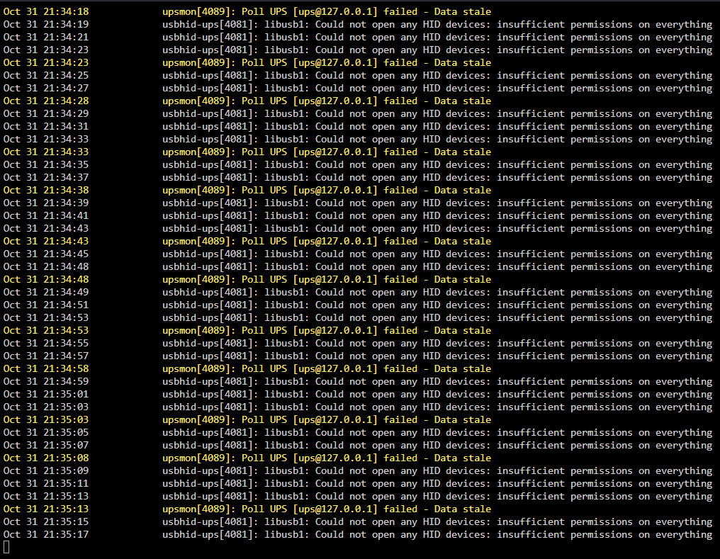

  8. I moved all my USB devices to different ports. I made sure to plug the UPS into a port that is on a different controller. Still my UPS went offline the same as the screenshots I posted previously and then my UNRAID USB boot drive went offline too. After rebooting the whole server everything came back. Today I checked again and my UPS is undetected again. I just removed NUT altogether and turned the built in UNRAID UPS service on and rebooted the whole server. So far so good but I will monitor for a while and see if I have the same problems with USB device disconnections without NUT installed.
  9. Yes I think you are right about a connectivity problem. After rebooting the server all various log entries every few seconds are gone. I've used this UPS since March 2023 when I put fresh batteries in it. It never had this problem until changing to the newly recommended NUT for UNRAID v6.12.x Do you think I should try a different Backend Switch?

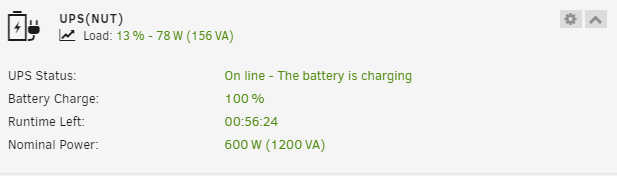

  10. Dashboard panel: Log during the above: After pressing the 'Reload NUT' button: Update NUT then unplug the UPS and plug it back in: Dashboard panel is missing completely now. I hope this is good information.

  12. It seems there is an update to the plugin every day and if I let it update NUT won't work until I restart the whole server. I've decided to ignore updates for NUT from now on instead of having to restart the whole server after every update. Why does Unraid tell me there is an update for NUT seemingly every day?
  13. Upon further investigation it seems the log is flooded with this entry: kernel: usb 1-5: input irq status -75 received I searched for that and found this topic discussion that says to "disable the included UPC driver (APC UPS Daemon) and use NUT" I've just done that and I will see how it goes. None of my hardware changed since updating to 6.12.3 except for some larger disks but I guess since the update includes a different kernel version this could explain the appearance of the excess new log entries.
