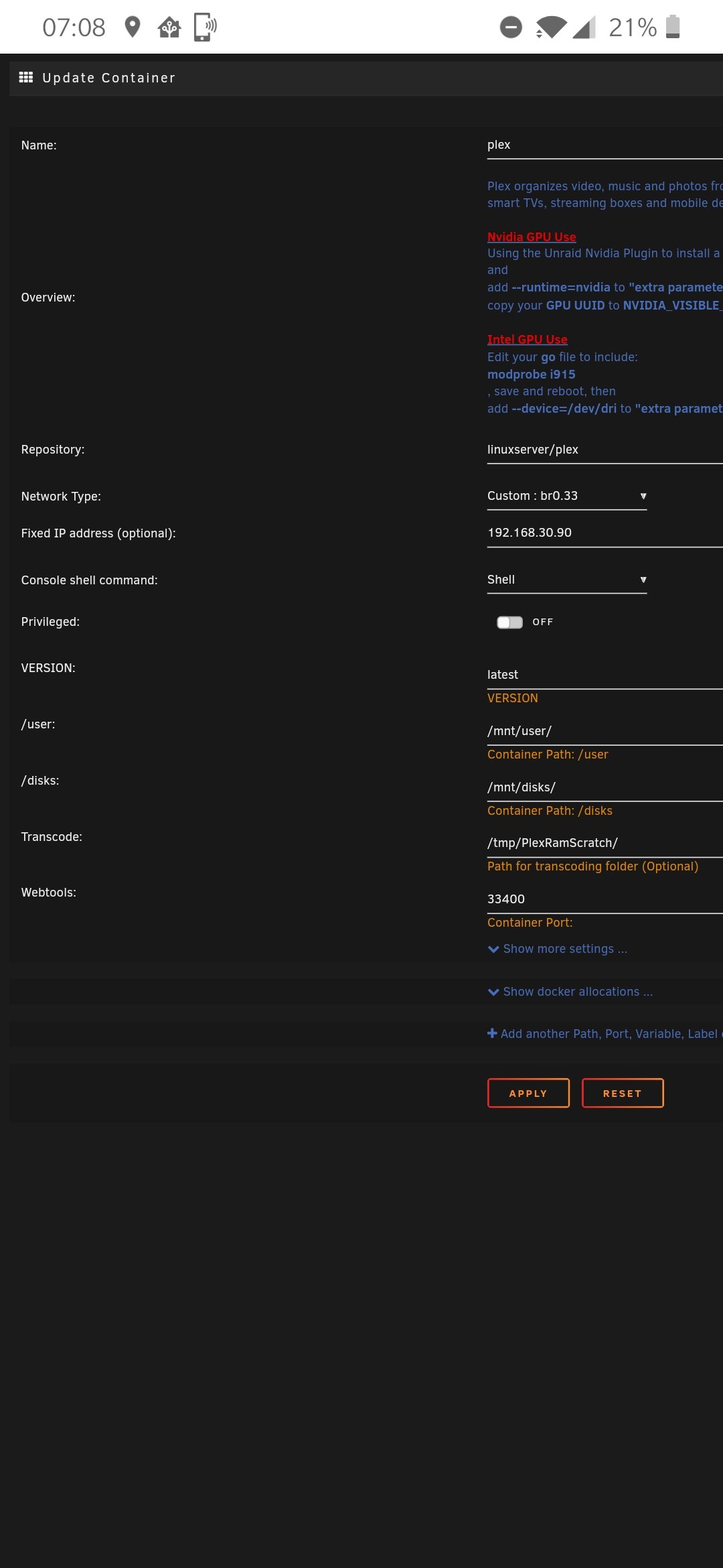

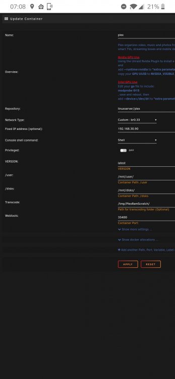

I had problems back in the day with /mnt/disks - I use /mnt/user/mount_rclone and /mnt/user/mount_mergerfs. 750GB/user/day upload - 10TB/day I think download. I think you're overthinking things - rclone does not add any extra considerations to your local setup, other than bandwidth and enough storage for local files that are pending upload. For my setup I have made the following choices: 1. plex appdata on an unassigned Nvme - probably overkill, but I want my library browsing to be as fast as possible and the drive was on sale. 2. A mergerfs union of 2 old unassigned 1TB SSDs in a pool and /mnt/user/local - if the SSD pool is full then new nzbget/qbittorrent files get added to the array instead i.e. like a 2nd cache pool. I do this to avoid my new nvme cache drive, to try and avoid 'noisy' writes to a HDD and because I need an SSD to keep up with my download speed. Not sure what's going on there.
