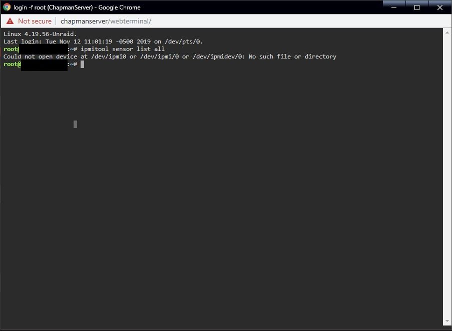

  7. Gotcha. I changed my thresholds using this plugin and they don't seem to be taking affect. Maybe that's my issue.
  8. I've experienced the same issue with my X10. And, unfortunately, I'm still at the stage where "normal operation" means the fans ramp up and spin down every 5 seconds. I'm tempted to just buy a manual fan controller and call it a day.

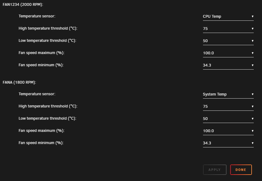

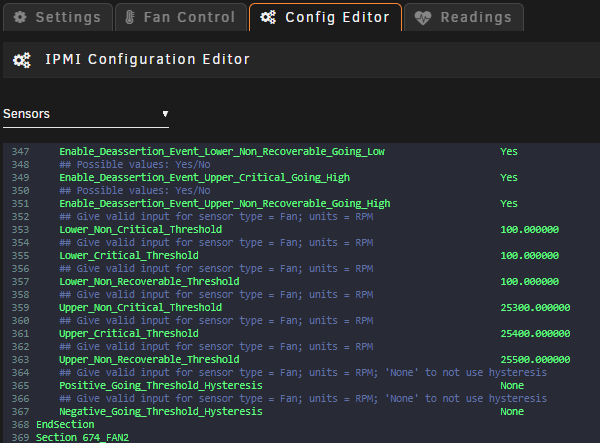

  9. Hmm, unfortunately that hasn't seemed to work. I changed the low thresholds in the Config Editor to "200" and put both fans at 34.3 minimum %. When I hit "apply" the fans spin down to around 600rpm. But, within 5 seconds, they speed back up to full blast. Anything you can think of that i'm doing wrong, or that i can try?
  10. Great, doing that now. Thanks again. I'm setting the fan min % to 28.1 and I've set the thresholds to 200. Again, thanks for the help.
  11. Thanks for responding so quickly. My fans can go down to 200rpm so that's why i was thinking I should set it lower. Do you think I need to restart the BMC after making the changes?
  12. I was able to change the fan thresholds (went down to 100rpm because my Arctic fans can spin pretty low). But, it doesn't seem to have an affect. They're going full blast right now. Do I need to restart the BMC or something?
  13. Interestingly, I've just tried this plugin because I'm having trouble with my X10 board fans surging. When I change FAN1234 to "CPU Temp", the fans spool down when I hit Apply. However, within a few seconds they spool back up. I've got the IPMI board settings at "Full Speed" hoping for this plugin to throttle them down. Should I choose a different setting?
