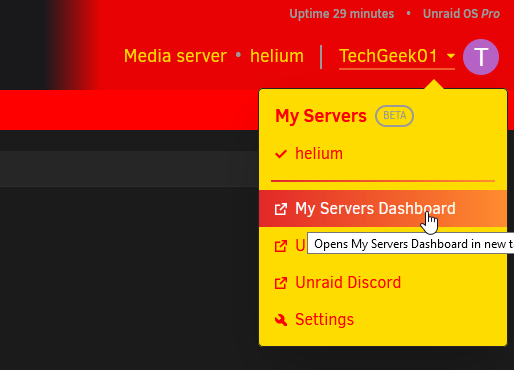

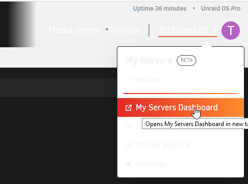

  7. Just wanted to chime in on a coloring issue. I'm using the "black" color theme, and have a white header. I have a custom header image that's gray, so the tab bar is black text on white, but the header image is gray with some stuff in it. To see text here, I have the custom text color set to white in display settings. The menus for me are unreadable in this plugin in the header. Seems that after testing, the background of the flyout menu takes the custom text color, and text takes the custom background color. Presumably the correct approach is for the text in the header to take the text color of the tabs, and for the flyout to match this? Without a custom header color set, the default in this theme is white. With my custom text color set to white to see version number and such on a gray header image, this otherwise makes text unreadable. This plugin, since it takes the color of the header, should more than likely do the same thing the tabs do, and ignore the custom text color and just set text to white/black depending on luminance of the header color.
