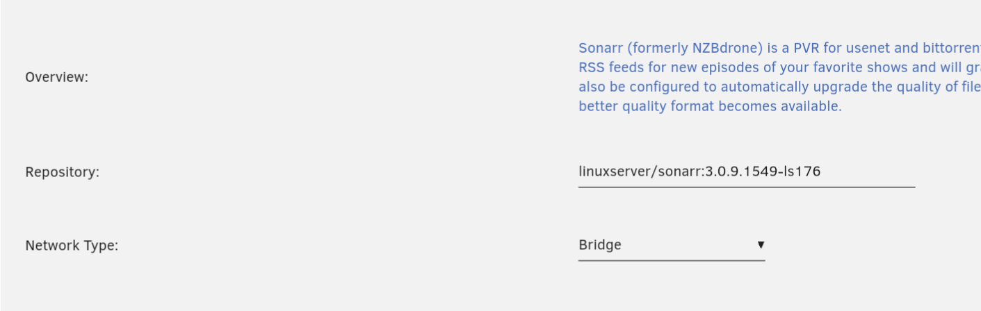

Anyone else get stracktraces on latest version? `3.0.9` ErrorWarningSystemArrayLogin [migrations] started [migrations] no migrations found ------------------------------------- _ () | | ___ _ __ | | / __| | | / \ | | \__ \ | | | () | |_| |___/ |_| \__/ Brought to you by linuxserver.io ------------------------------------- To support the app dev(s) visit: Sonarr: https://sonarr.tv/donate To support LSIO projects visit: https://www.linuxserver.io/donate/ ------------------------------------- GID/UID ------------------------------------- User uid: 99 User gid: 99 ------------------------------------- [custom-init] No custom files found, skipping... * Assertion at gc.c:1005, condition `is_ok (error)' not met, function:mono_gc_init_finalizer_thread, Couldn't create thread. Error 0x0 assembly:<unknown assembly> type:<unknown type> member:(null) ================================================================= Native Crash Reporting ================================================================= Got a SIGABRT while executing native code. This usually indicates a fatal error in the mono runtime or one of the native libraries used by your application. ================================================================= ================================================================= Native stacktrace: ================================================================= 0x562d25484ffb - mono : 0x562d2548538d - mono : 0x562d25432087 - mono : 0x562d2548457c - mono : 0x1504fcc72520 - /lib/x86_64-linux-gnu/libc.so.6 : 0x1504fccc6a7c - /lib/x86_64-linux-gnu/libc.so.6 : pthread_kill 0x1504fcc72476 - /lib/x86_64-linux-gnu/libc.so.6 : raise 0x1504fcc587f3 - /lib/x86_64-linux-gnu/libc.so.6 : abort 0x562d253f43c4 - mono : 0x562d256d9135 - mono : 0x562d256f65be - mono : 0x562d256f6c73 - mono : monoeg_assertion_message 0x562d25673f08 - mono : 0x562d255619f6 - mono : 0x562d253f7047 - mono : 0x562d254057b6 - mono : mono_main 0x562d253f44df - mono : 0x1504fcc59d90 - /lib/x86_64-linux-gnu/libc.so.6 : 0x1504fcc59e40 - /lib/x86_64-linux-gnu/libc.so.6 : __libc_start_main 0x562d253f4b1e - mono : _start ================================================================= Telemetry Dumper: ================================================================= Entering thread summarizer pause from 0x23111170584704x Finished thread summarizer pause from 0x23111170584704x. Failed to create breadcrumb file (null)/crash_hash_0x0 Waiting for dumping threads to resume ================================================================= External Debugger Dump: ================================================================= mono_gdb_render_native_backtraces not supported on this platform, unable to find gdb or lldb ================================================================= Basic Fault Address Reporting ================================================================= Memory around native instruction pointer (0x1504fccc6a7c):0x1504fccc6a6c 05 00 44 89 e2 89 ee 89 c7 b8 ea 00 00 00 0f 05 ..D............. 0x1504fccc6a7c 41 89 c5 41 f7 dd 3d 00 f0 ff ff b8 00 00 00 00 A..A..=......... 0x1504fccc6a8c 44 0f 46 e8 e9 6d ff ff ff 0f 1f 00 48 89 ef e8 D.F..m......H... 0x1504fccc6a9c 10 a8 ff ff e9 29 ff ff ff 0f 1f 00 48 89 ef e8 .....)......H... ================================================================= Managed Stacktrace: ================================================================= ================================================================= * Assertion at gc.c:1005, condition `is_ok (error)' not met, function:mono_gc_init_finalizer_thread, Couldn't create thread. Error 0x0 assembly:<unknown assembly> type:<unknown type> member:(null) Edit: Was able to roll back to `3.0.9.1549-ls176` so will stick on that for the moment.
