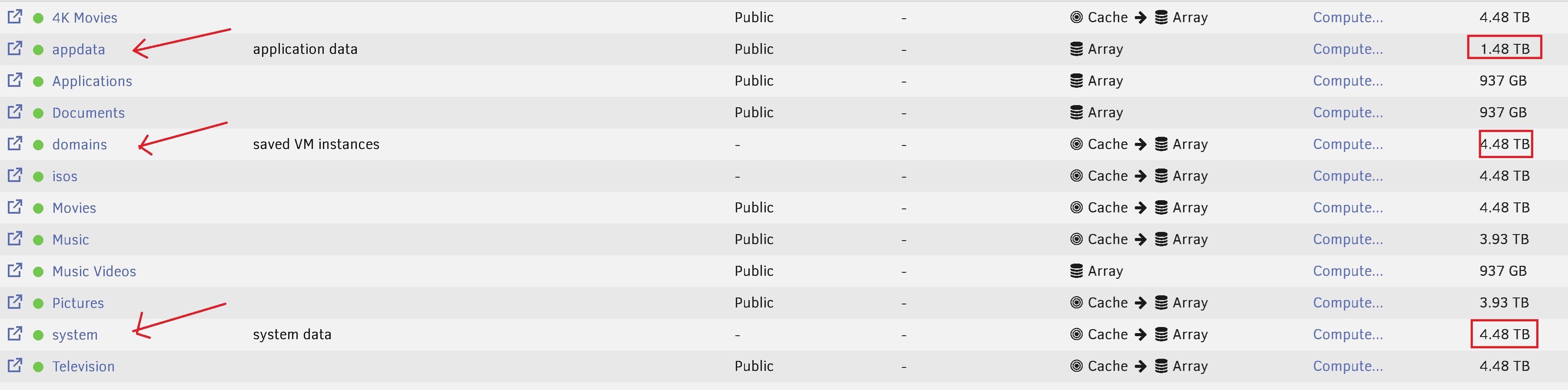

So these three? I just don't know how this all works when their sizes show as way larger than my Cache drive.

Well its all done and running. I adjusted the cache/array settings for my three major shares as well as letting them spread over all 4 drives. I am running low on space which is what prompted me to first look at this but IDK if I should just start a new thread for questions on how to go about that part of my upgrade. tower-diagnostics-20260202-1913.zip

I have rebooted a couple of times. Mainly to see if turning off the autostart on the Plex docker would allow array to correct itself. Its the only Docker/VM or Plugin I have running on this, its specifically a Plex server so there is no real fluff, and I think is why its run so well so long. I will address those max/min values for the future. I am going to be upping my drives as I am nearing the end of my comfort level with space. As for the appdata and system shares, that is something I will take a look at. Does setting all the shares to live on the cache mean I need a much larger drive there? I have about 14TB of media and a 3TB cahce drive. I also don't know if I want to switch it now while the cache drive is having issues offloading.

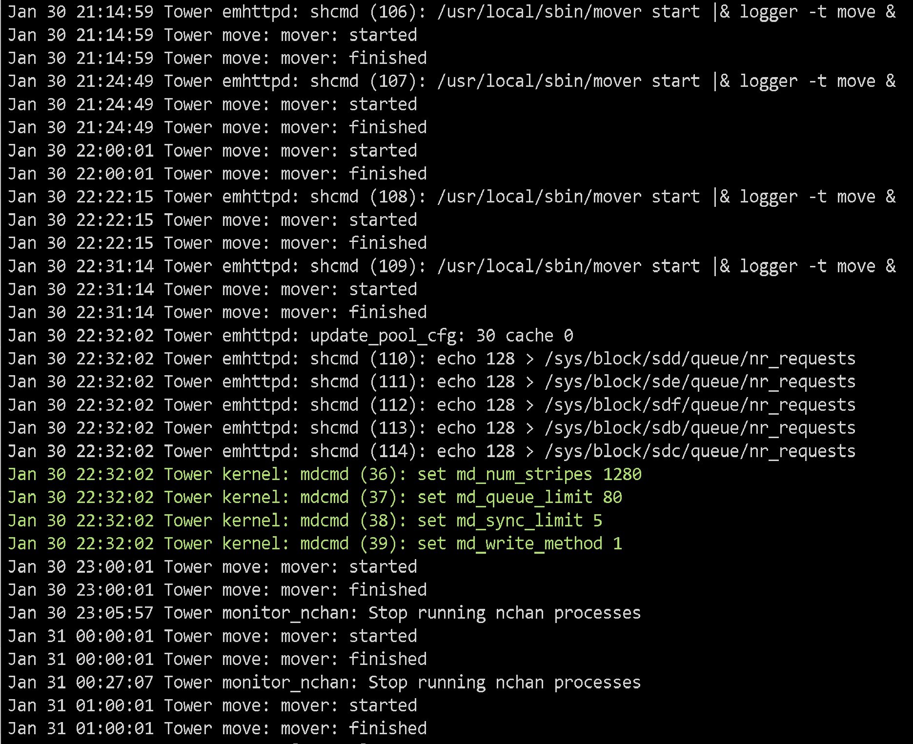

I have had this server up for a long time, and rarely peek in as it just runs like a tank. Its used for file storage and as a Plex server. In the last few days new media moved onto the server was stuttering during playback. When I logged in I was greated with 10's of messages about the cache being full. Sure enough of the 3TB it has 2.88 sitting on it. Also I noted in the main screen the "thinking" wave is just going forever. I don't run any VM's and the only Docker is Plex. I set Plex to not auto restart and rebooted the tower. It came back up with Plex off and I manually selected to run the mover. As of now I have not seen any movement. I only have three shares and they are specified to live on the array not the cache. Nothing is being transferred in or out with Plex off. But I have the thinking wave non stop. Any ideas what is going on? I also pulled up the logs just now and I see that when I execute the move, in the same second the log shows it completed. I can see my scheduled hourly moves try to happen. tower-diagnostics-20260131-1040.zip

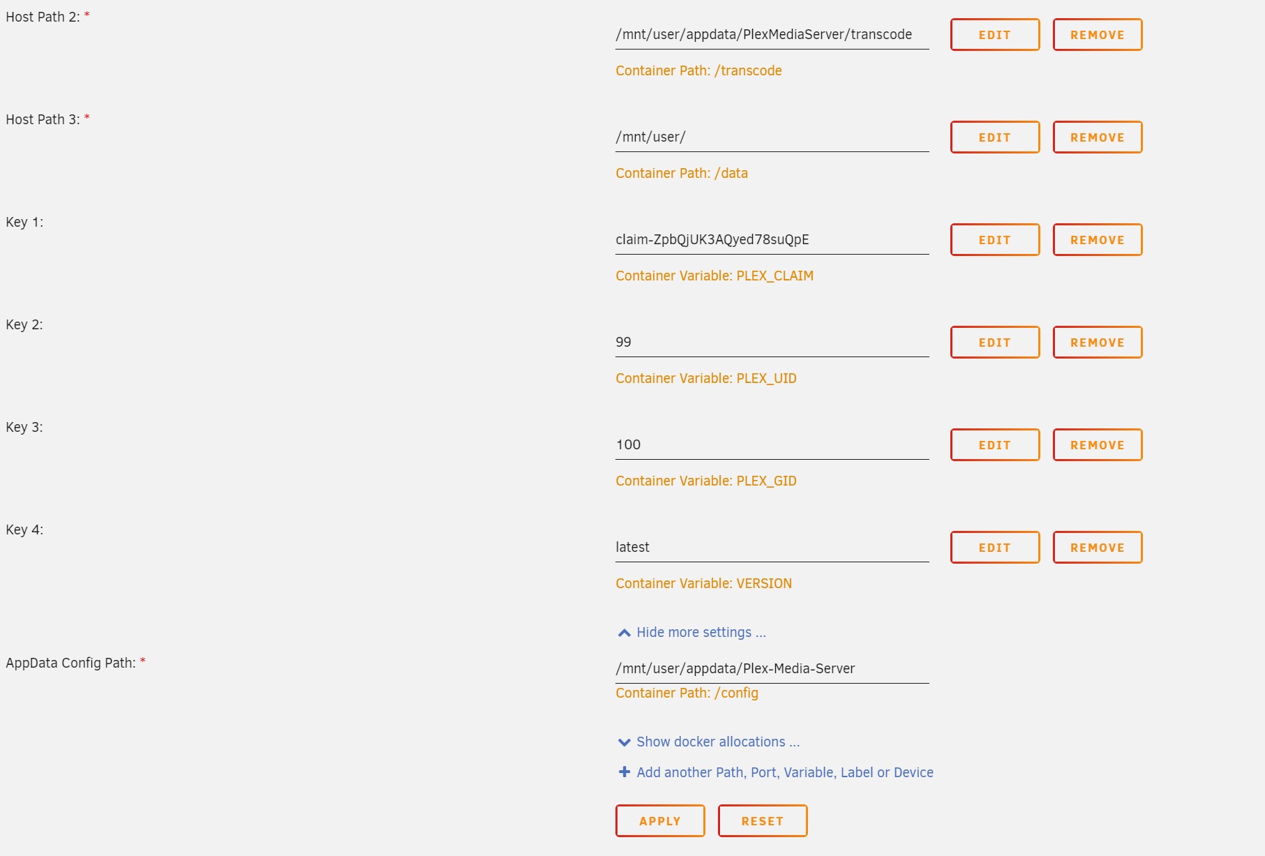

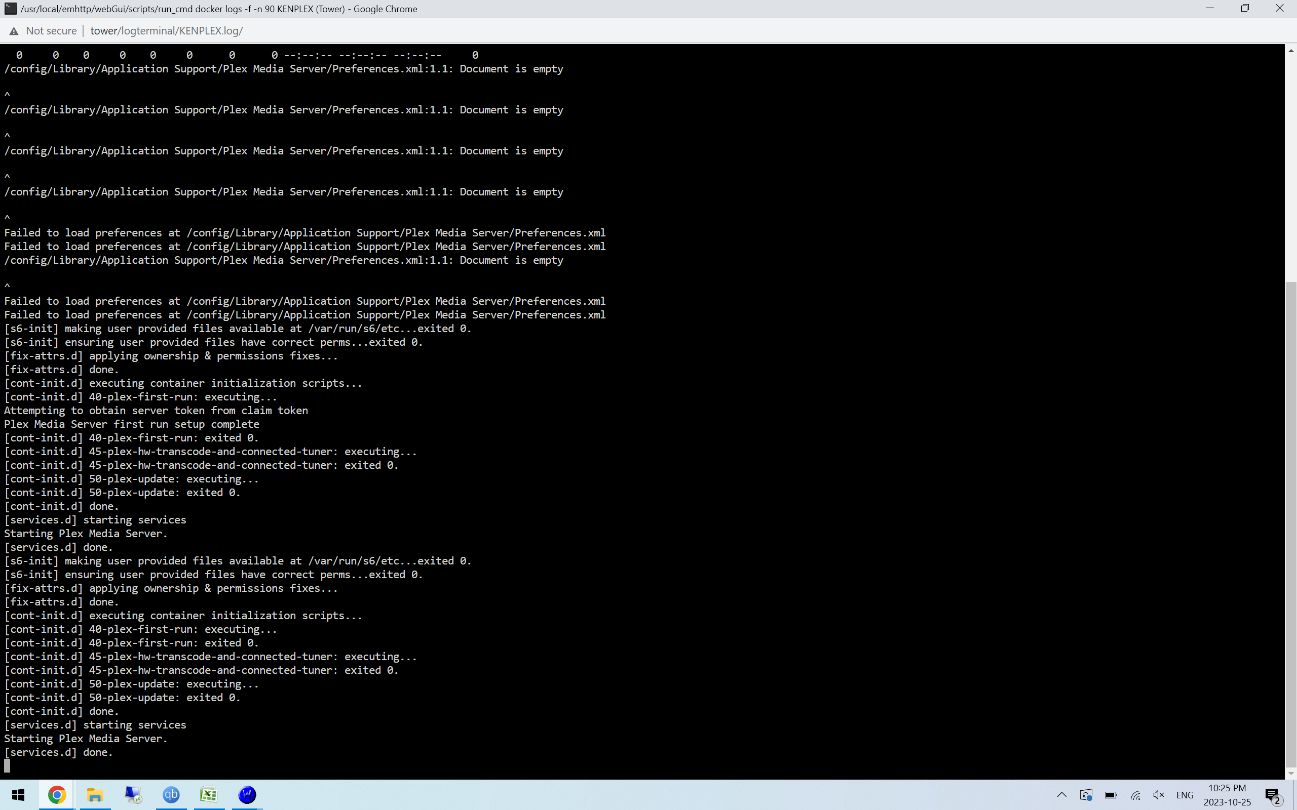

This has happened again. Frankly I have no idea how I got it back up and running but the battery in my backup must be failing. On restart, Plex is unhealthy and unusable. I feel like last time I removed the app and reinstalled and that fixed it but there must be something else. So frustrating this Docker just can't see to restart itself anymore. I never had this issue previously. Seems like config is looking at an Empty Preferences XML. I have two folders that look very similar, one is PlexMediaServer and one is Plex-Media-Server. Both inside the library have the same setup, and empty Preference XML files. I feel like I changed a path or deleted something last time to get this to work. Thoughts?
