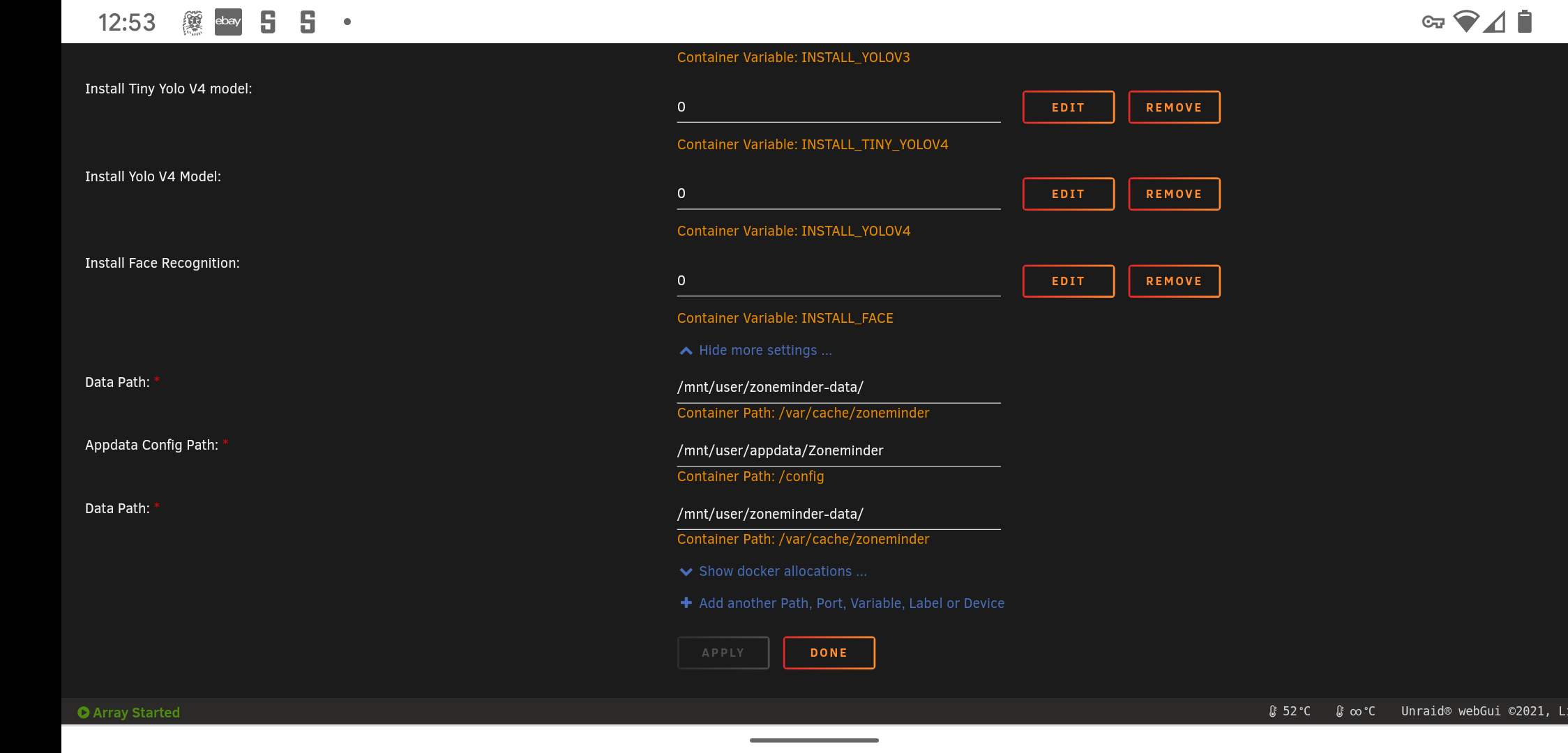

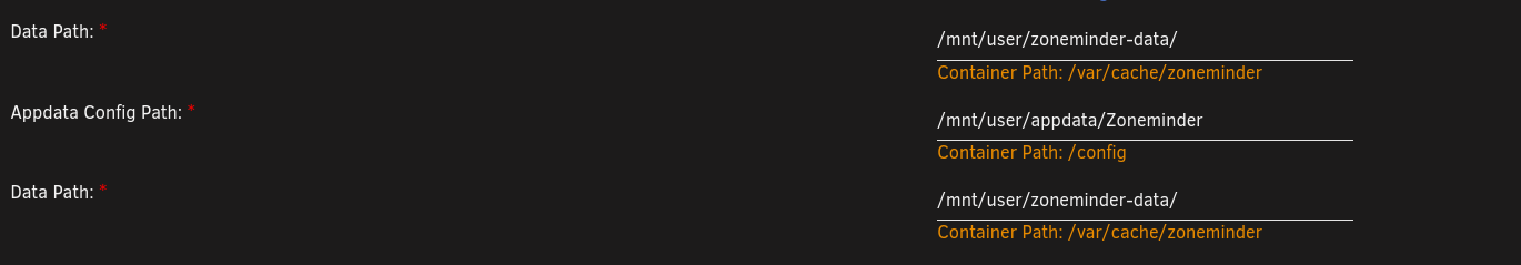

  12. This is a share on my array. Nothing is mounted there, I meant that the container path /var/cache/zoneminder points there. Is that ok?
  13. Thanks again for your quick help. I have deleted the Zoneminder container and also removed the template. Then I reinstalled the zoneminder from the apps. The data path is now only present once, but the memory usage is immediately high again. should i have deleted the app-data folder as well? but it is actually on the share.
  14. There is no button
  15. How can I delete a data path?
  16. I mounted the data path there. Container Path: /var/cache/zoneminder I just see that this is present twice for me. See screenshot.
