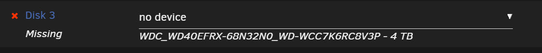

  15. After I calmed down, I performed some basic troubleshooting. I connected a monitor and keyboard, restarted the server and entered the BIOS, the MB has 8 SATA ports and one port was not showing a drive connected to it. So I shut down the system and connected drive 3 to a spare SATA port on the LSi controller card. I turned the server back on, logged in and the array started as it recognized drive 3. I was able to browse disk 3 and open files via the Dynamix File Manager plugin. I also opened some files via Windows explorer that reside on drive 3; the drive seems good to go at the moment. So, it's either a bad SATA port on the MB or a bad cable?? I'm going to leave things alone for a bit to make sure the server is stable. By the way, I just realized the system is 5 years old... boy time flies... it looks like I need to start buying some spare parts as I'm sure other things are going to go... Thanks for the reply... new diagnostics attached.
  16. The drives are labeled, so I know which one is drive #3; it's part of my OSD, as all drives are in proper order within the case. I have a backup of the USB key and there's an option to start the array without this drive, so trying to figure out my best options are.... any help is appreciated.

  18. After upgrading to 6.10.0 from 6.10-rc8, upon reboot the array won't start as a drive is missing; any help is appreciated. I have a backup of the USB drive.
